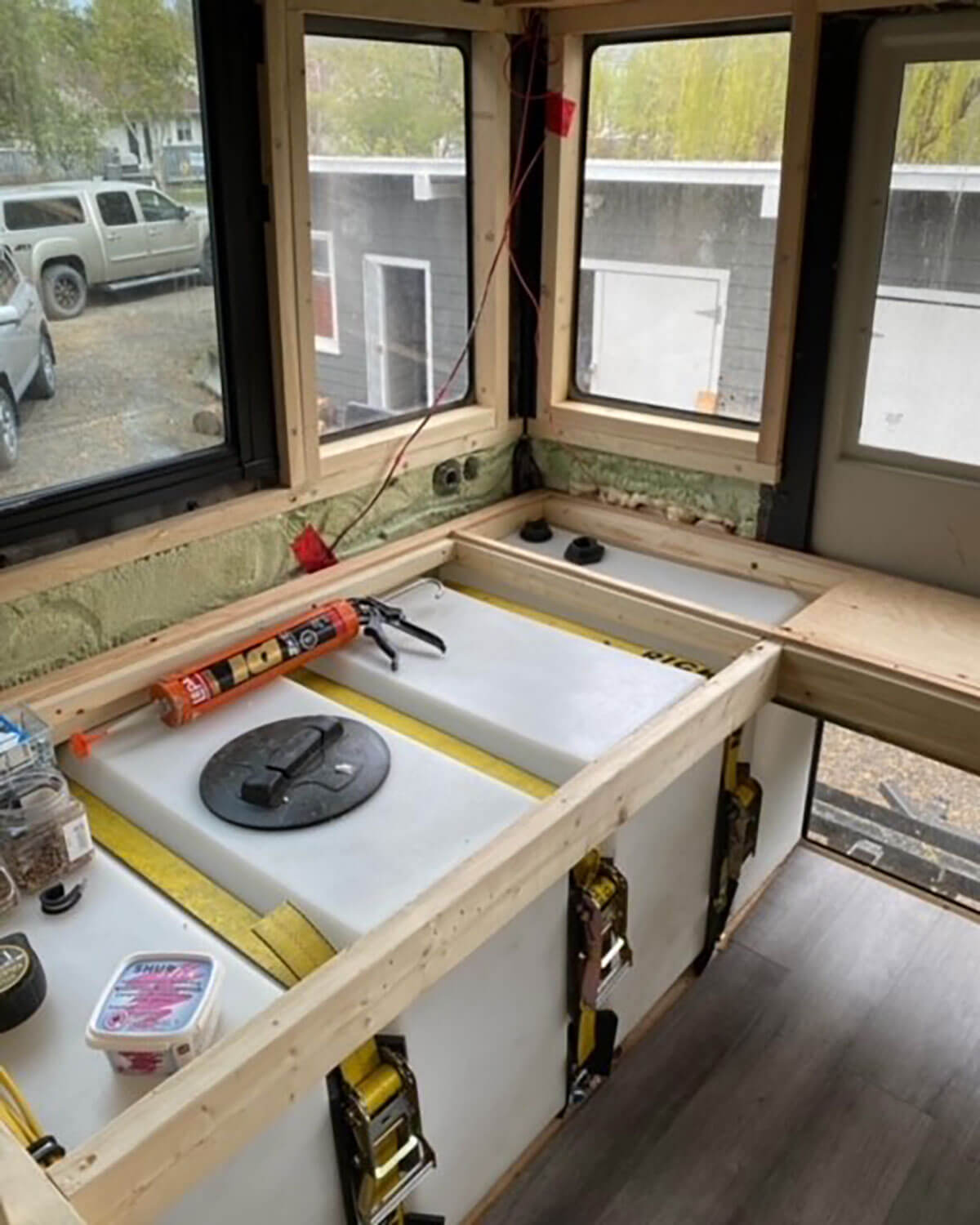

We had never used epoxy resin before, so this step was a bit stressful, but they turned out great. We decided to splurge on the kitchen sink and make it the centerpiece of the kitchen. We used a 32” hammered copper apron sink. It is beautiful!
We wanted a sink this big so we could easily hand wash clothes in it when we are off the grid for extended periods of time and not near a laundromat, we also didn’t want an inefficient washer/dryer combo taking up crucial space in the bus, let alone its water and power needs.
With the help of my plumber/gas fitter friend, we installed a Suburban propane-powered tankless hot water heater under the kitchen sink. He also assisted us in installing all the PEX plumbing.
All our plumbing is clearly visible when we open the cabinetry. Then, in the case of a leak or potential freezing, it is fully accessible. Our 125-gallon fresh water tank is located under the bed so it is not exposed to freezing temperatures outside.
The fridge brand is “Unique”. It is an 11 cubic foot 12V/120V fridge/freezer that is plenty big enough for the two of us to keep lots of perishable foods on hand.
The 3-burner propane stove/oven is made by Furrion. The stove/oven and tankless hot water unit are supplied by a 40-gallon commercial propane tank mounted under the bus. This tank is mounted up high under the bus and doesn’t lessen the clearance of the bus to the ground. When filled, it would likely last an entire summer.

The kitchen sink, bathroom sink, and shower all drain into a 40-gallon grey tank under the bus. Since we are mostly camping off-grid and not in formal campgrounds, we usually just let the grey water drain out the tank and onto the ground. Of course, we use minimal soaps or detergents, all of which are environmentally friendly.
