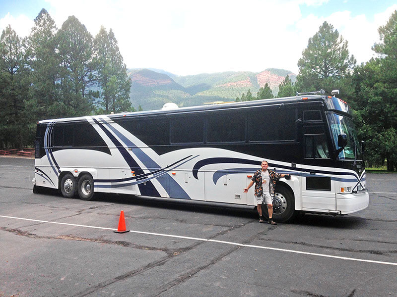

Just purchased our new bus at the Bar D Ranch in Durango Colorado.
When we arrived to pick up our new bus on the Labor Day weekend of 2017, Cy took us on a personally guided tour of the Bar D Ranch. He had designed and engineered many of the unusual features of the ranch, including the retractable roof that covered the outdoor dining areas during inclement weather. Phil and I were impressed with his ingenuity, especially when he told us he had made a few modifications to our new bus.

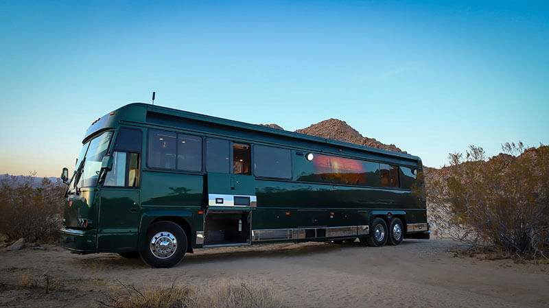

The Saguaro bus is a beauty, and she gets stares wherever we go. Many people have told us that it is the most beautiful RV they have ever seen.

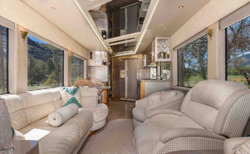

The Saguaro Bus – A 1994 MCI DL3-45 - bus conversion photo
Original Vantare interior. Easy chairs, couch, and table for two.

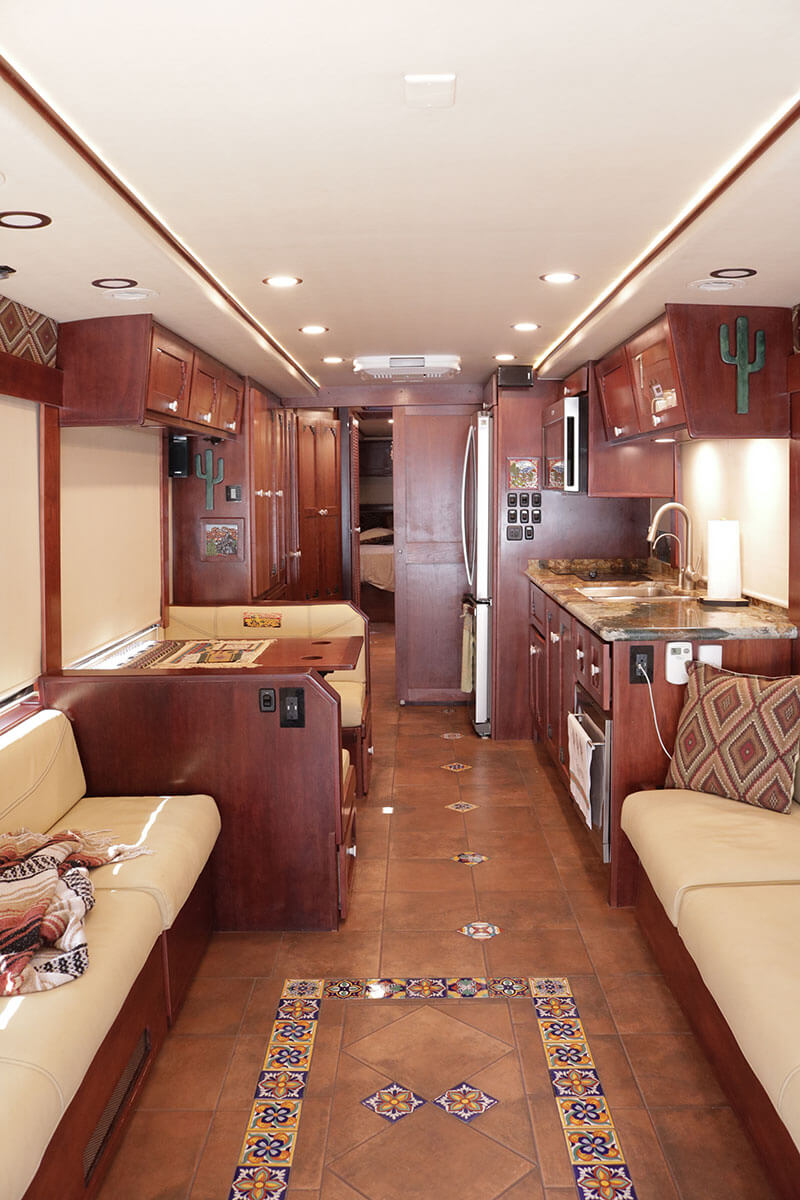

With a southwest style, hints of Saguaros all over the bus, lots of Leisure LED lights, heated floors, beautiful granite slabs making a wishbone pattern in the shower, little green accents on the cabinets, a cabinet for something in every inch, Including a green color cabinet for Phil’s coffee, which I should have mentioned is one of his favorite things at any time… just like my Dad and as long as it was fresh.
Decorative tiles compliment the floor in the great room, an exhaust fan in the floor of the bathroom, a smooth leather-wrapped dash, complimented by all new front gauges, an entry door wrapped with a foam-inserted Saguaro, and a step cover over the entrance steps for their four-legged friends Ginni can’t ride without, four full-length Girard awing’s on the top, two on each side, a raised front and rear cap... hand made from fiberglass, polished rub rails from IBP (International Bus Parts), and custom windows in the kids’ bays, new tires, all new Lion energy Lithium batteries, cat 5 cables going to every bay, all new holding tanks, a new generator and inverters, a redesigned wash down bay, accented by an area that was a skirt and we made into another storage bay, with a bay door we made from an old door from a donor bus, all finished in that custom green color you have to see to understand, accented by custom airbrushed murals on each side of bus giving them that southwest feel anywhere they roam.

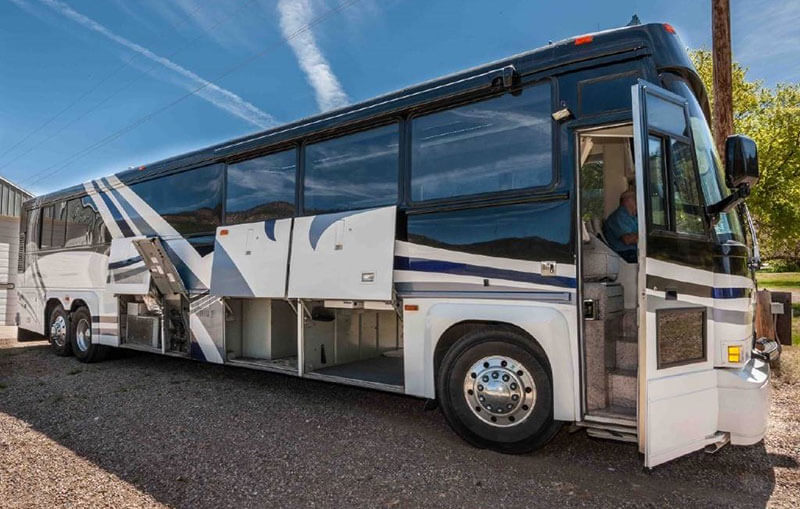

Original exterior by Vantare.

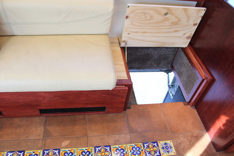

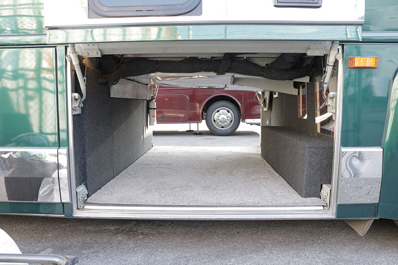

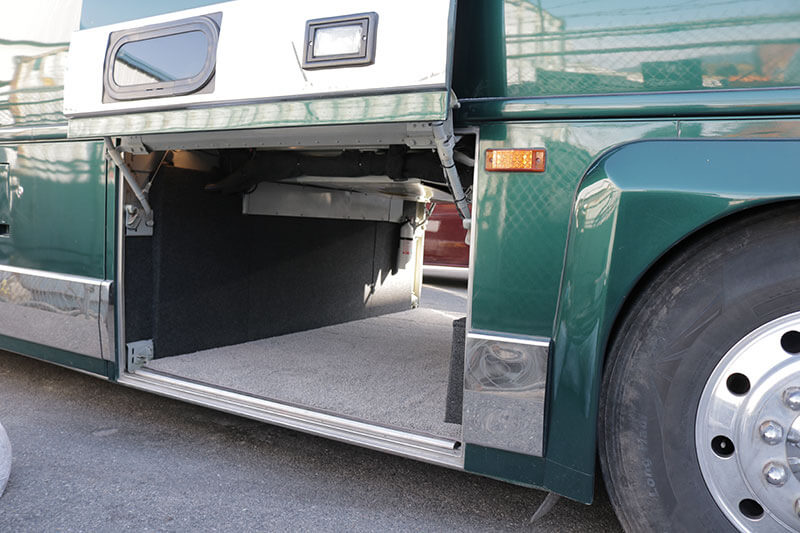

Open compartment with 8 Lion Energy batteries on the right. The carpet and padding easily pulls out to reveal a basic hardware floor when heavy items need to be carried.

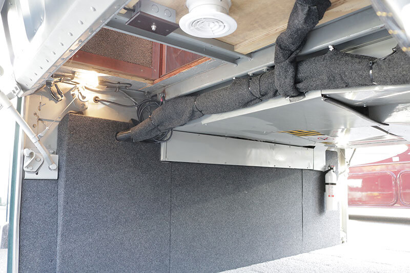

Entrance to the lower bedroom from above. The bay is equipped with forced air ventilation from the main cabin area, 120V and 12V outlets, USB outlets, a cable feed from the over-the-air antenna or the park cable service, 12V and 24V lighting, and multiple Cat 5E jacks.

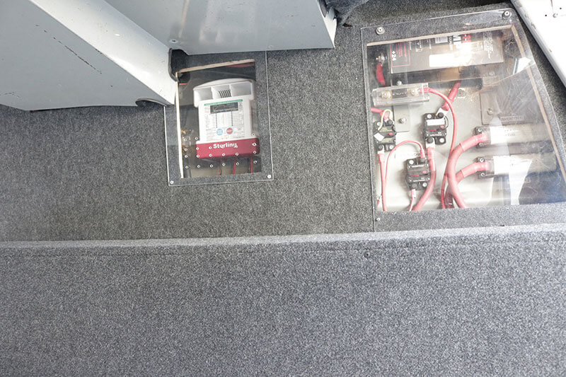

The DC-DC Sterling charger (left hand side) and breakers for the Vanner inverters, the coach Iota battery charger, and the DC-DC charger.

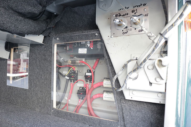

Cutoffs for the Vanners, upper right-hand side.

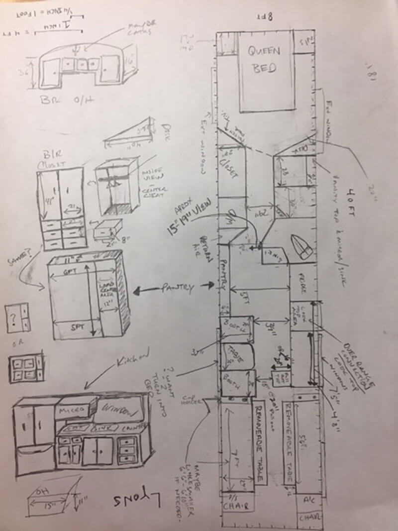

The above image was created in multiple Linux drawing tools, showing the desired final product.
 The punch list for the interior list of requirements covered ceiling to bay layouts, moving from the front dash to the rear wall. From that list, Leisure Coach provided incredible creativity in meeting the design requirements. It would be impossible to praise their work sufficiently in making the project happen. It was an amazing process.
I know I slowed down their process with dozens (hundreds?) of calls and suggestions. Nevertheless, they were courteous and worked to make the magic happen. I planned for the redundancy of systems and that is what I got.

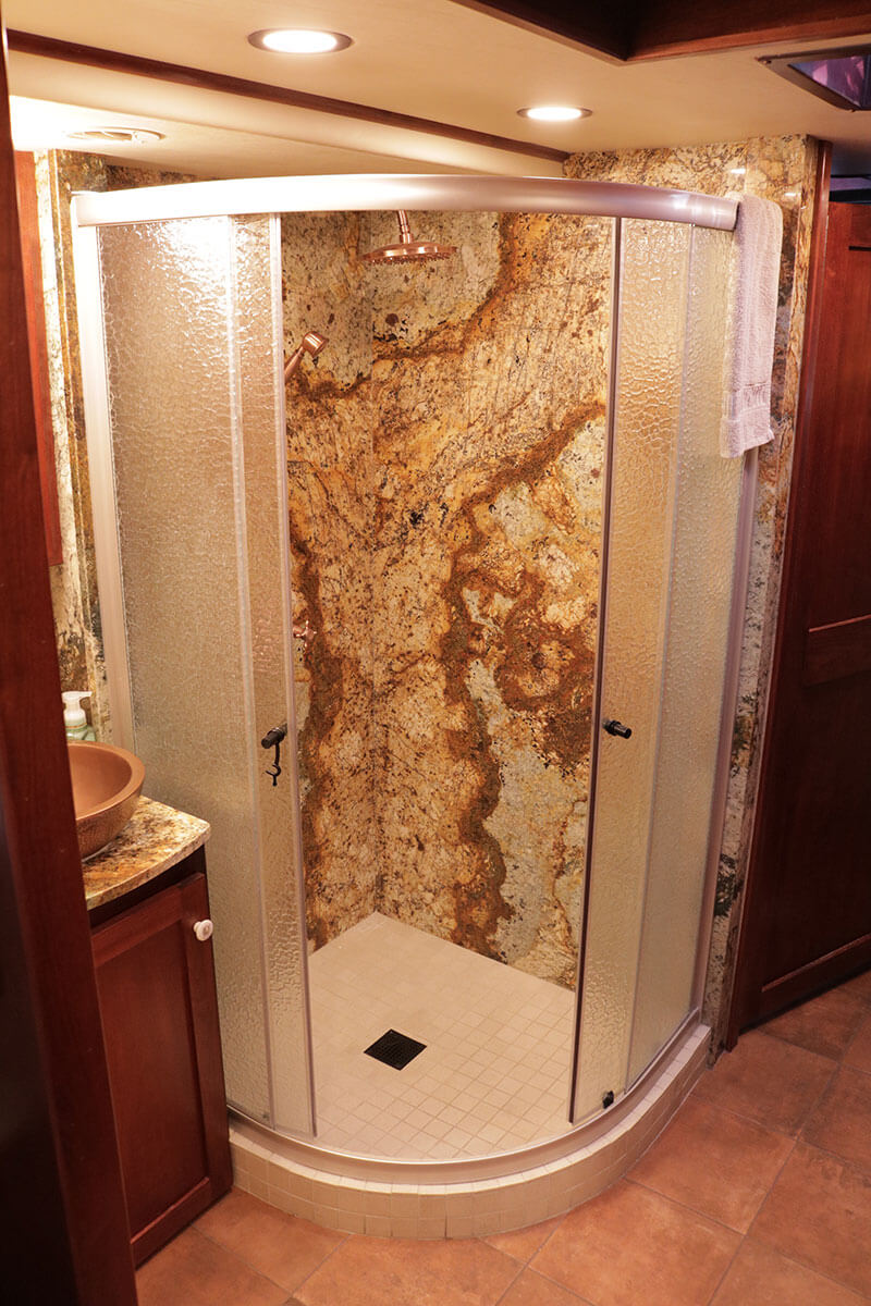

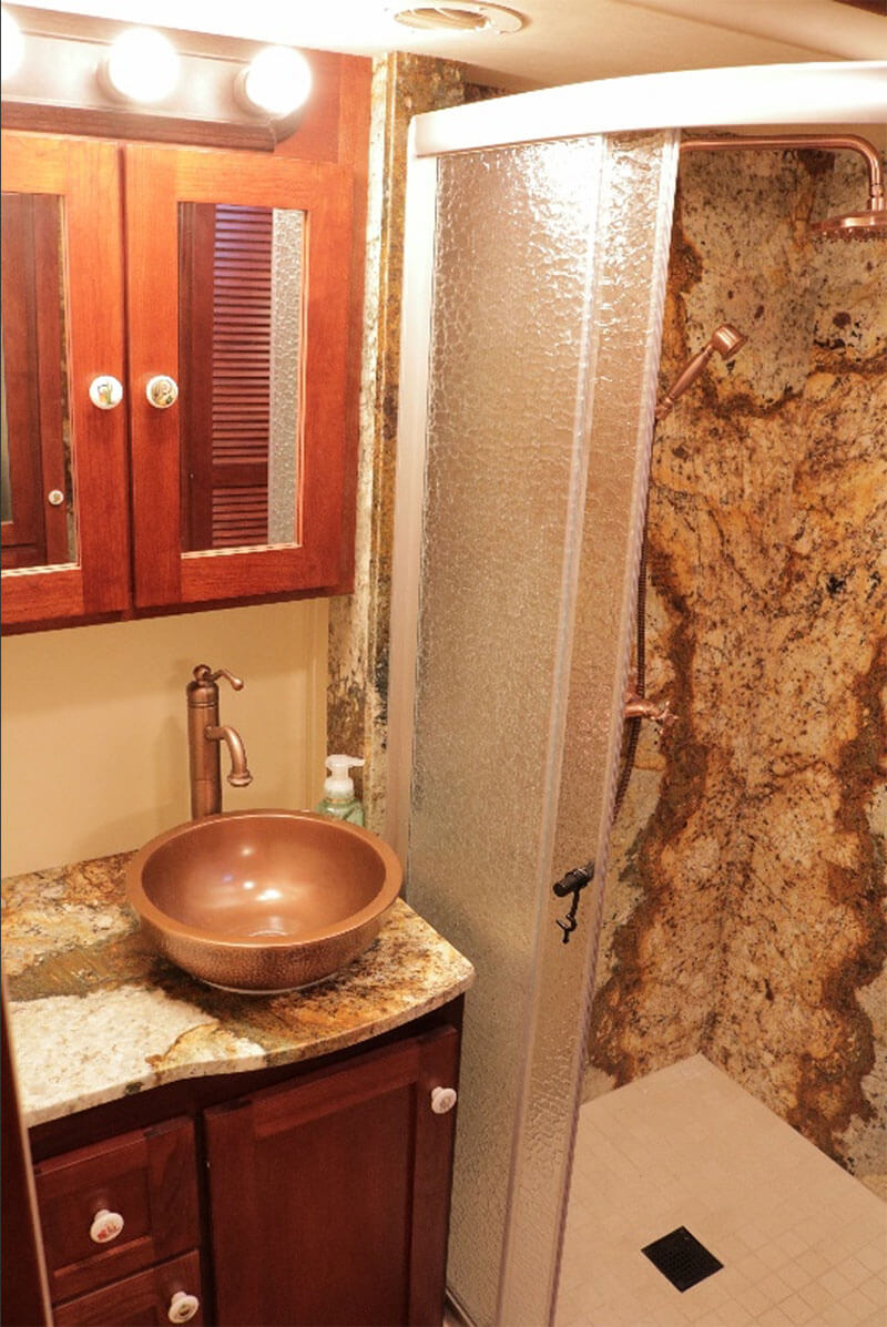

Bathroom/Shower

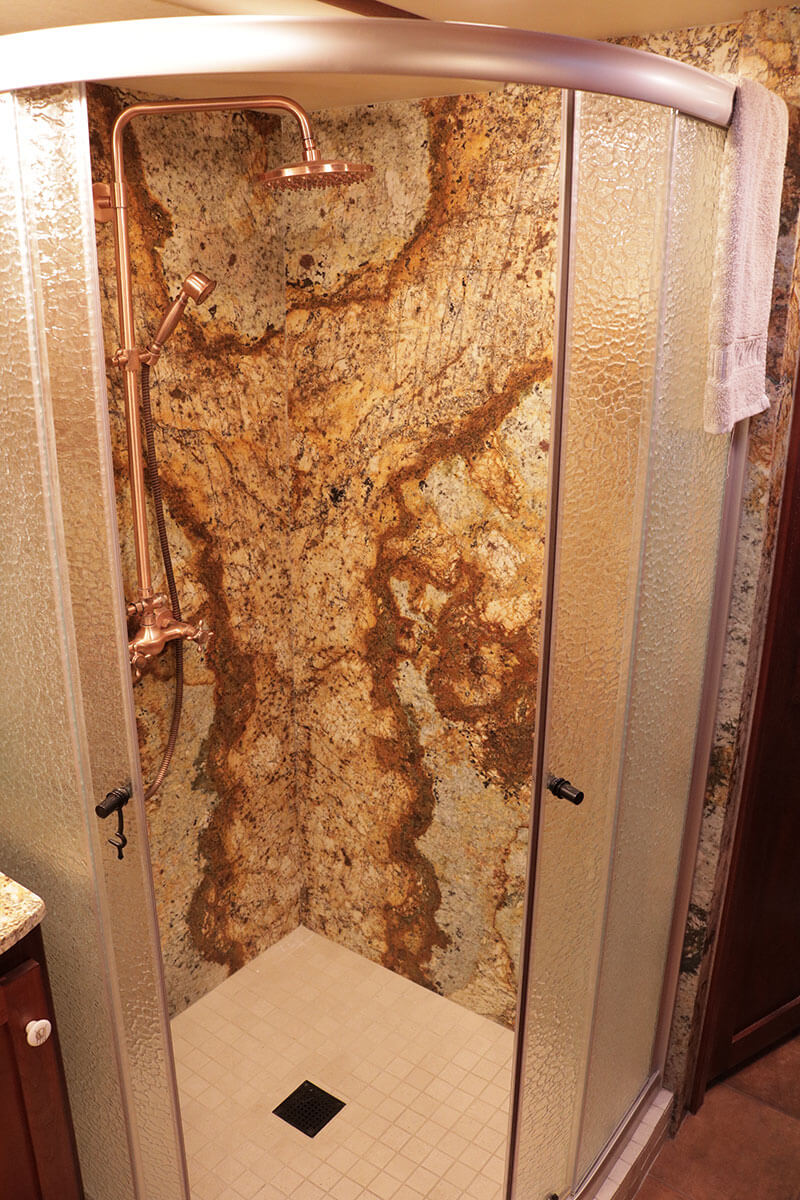

The bathroom tile was the same Desert Canyon marble slab used in the bathroom, shower, bathroom sinks, and kitchen. This consistency of material ideas were put forth by Jon of LCW. It provides a theme throughout the coach and turned out very well. It provides a smooth transition between the functional areas of the bus.

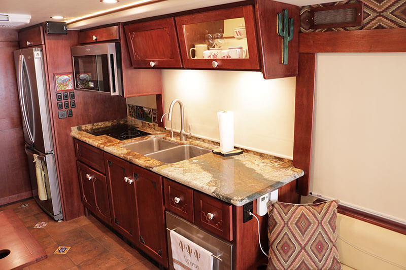

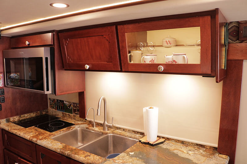

A dishwasher was added to apply extra heat to the dishes and kill off more germs. The jury is still out as to whether it remains or gets turned into more storage.
The lighted curio cabinet is a fun addition. It lets us display gifts of Mimbreno dinnerware from our daughters given to us over the years.
There is an electric cooktop side by side with a Webasto cooktop. Either or both can be used based on available power. The electric cooktop operates on an inverter circuit. There are parallel water pumps and dual fresh water tanks. We have 150 gallons of fresh water total in capacity.

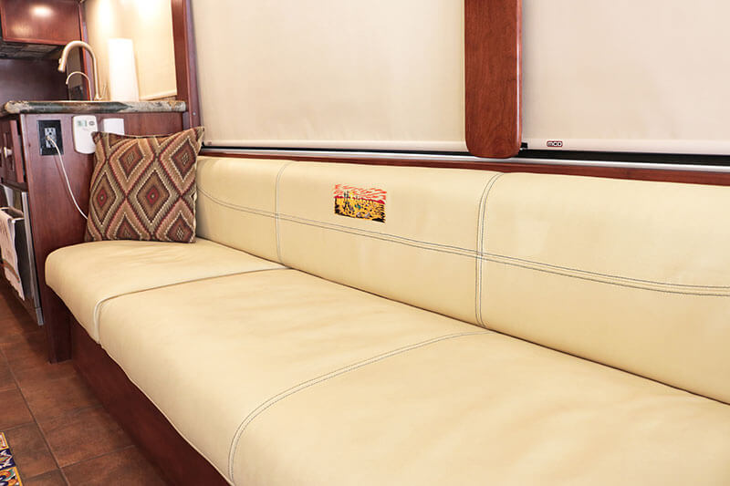

Bench seats allow us to seat many people easily for group outings. Their slimmer design also affords more space for moving about in the main cabin. Additionally, these seats slide out for more comfortable seating or providing extra beds.
There are long bench seats along each side of the front cabin area, each also doubles as a bed. The dinette drops down to a bed in standard RV fashion. And the front luggage bay also sleeps 1-2. The rear bedroom accommodates 1-2. The front bay is kept cooled and heated by means of forced air brought down from the coach floor area. The concept is that the underbelly cabin is kept heated and cooled as is comfortable for those upstairs.

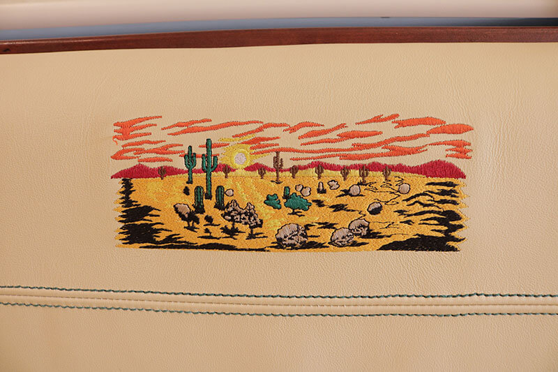

The Arizona theme continues with the pattern stitched into the seats. This design is loosely taken from the murals on the coach exterior.

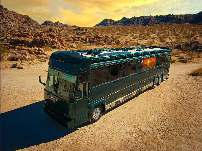

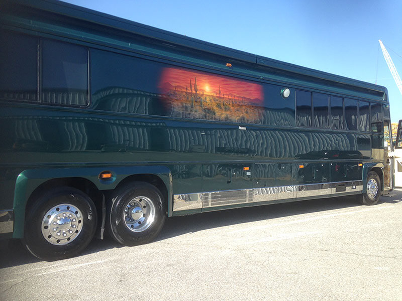

Cutting down on the Arizona heat the roof is coated bright white. Along with foamed walls, these features make a significant difference as compared to our MC9 which has neither of these advantages.

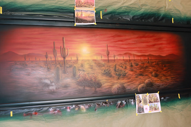

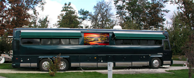

The airbrush artist was masterful in how he approached and carried out his work.
Reimagined exterior built by Leisure Coachworks.

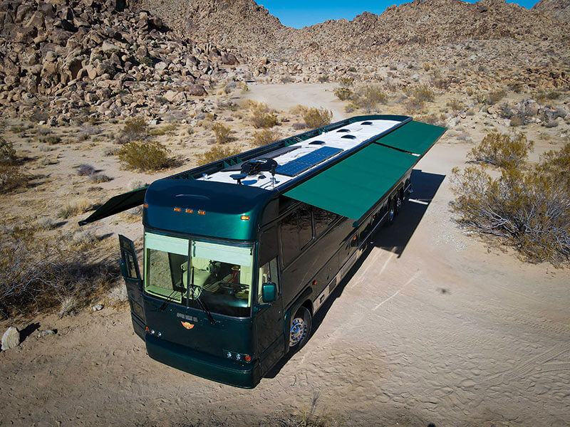

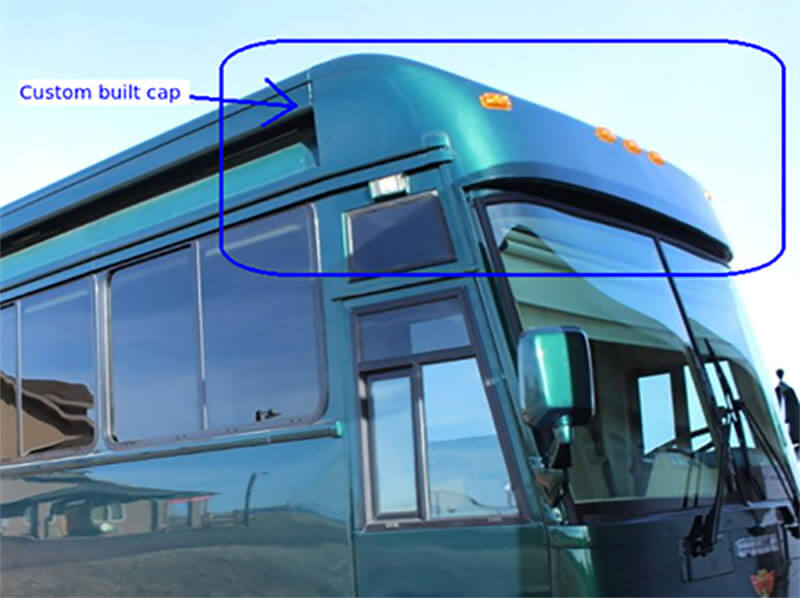

The front endcap is crafted from fiberglass by the LCW team.
Girard awnings were selected as they matched the bus lines and hid any hardware such as solar panels and a roof A/C unit without being obvious. One small Arizona desert scene mural was airbrushed on either side of the coach. We wanted the desert scene indicative of our home state of Arizona. Stainless steel bumper guards were added to keep the dust and dirt from becoming too obvious as we live off a long dirt road. The Leisure Coach crew built a beautiful front endcap out of fiberglass which dovetails into the Girard awnings. The look is aerodynamic, low profile, and aesthetically pleasing.

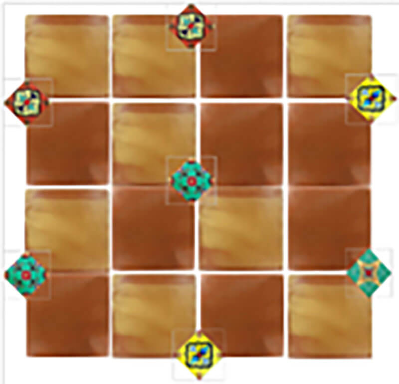

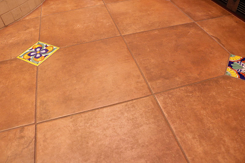

Several different configurations of the Mexican tile and Talavera inserts were explored before the final design was implemented.

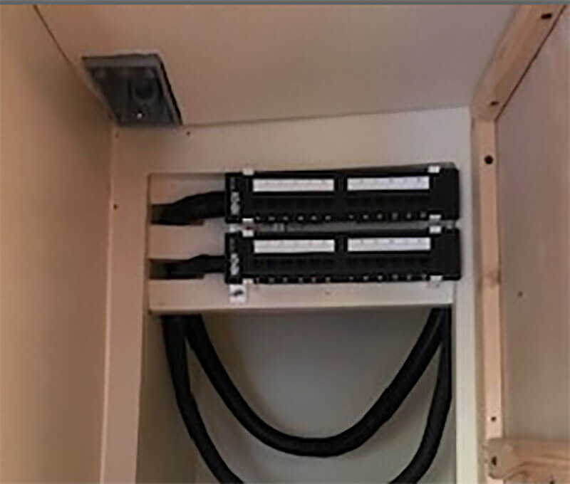

Patch panels supporting coach-wired networking.
A mobile office area was set up in the rear of the coach, and there is wired networking throughout the interior and bays. I’m not personally a fan of public Wi-Fi for many reasons. There are redundant networking jacks throughout the coach – dual patch panels were installed for network configuration flexibility.
A Plex media server serves up digital entertainment in the coach while connected or disconnected from the Internet. The media server runs on a Raspberry Pi (miniature computer) and supports the Roku Plex media clients displayed on the front and rear TVs. Raspberry Pi servers provide additional support and networking services to the coach.

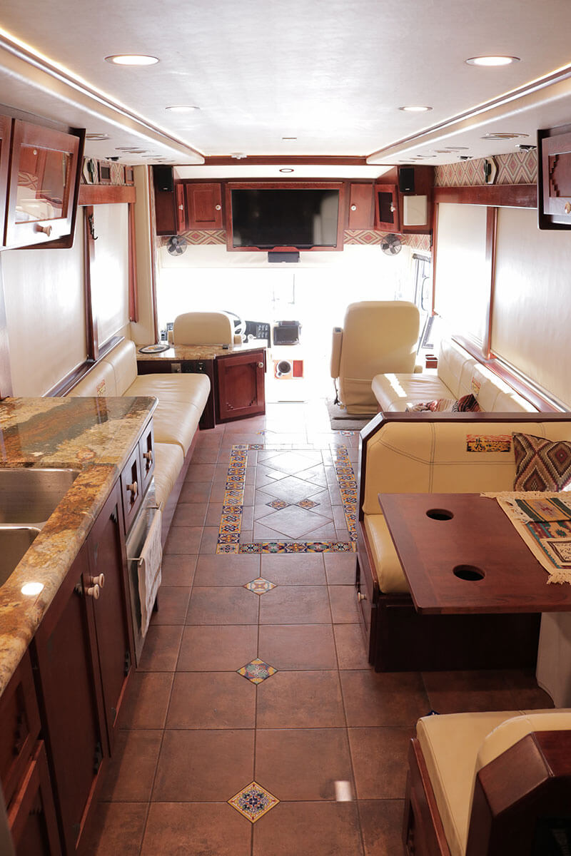

Looking with a clear line of sight from the front to the back of the coach.
The inside look of the new interior. Picture showing midsection of the bus looking forward.

I remembered the ad for Engine Heat Protection’s product called Rollboard displayed in Bus Conversion Magazine. I requested LCW include this blanket as an insulator between the engine compartment and the bed. This blanket material was placed directly under the bed above the Series 60.
Fast forward to the time after the conversion was completed; we noticed the bedroom was no longer stifling hot at the end of a day’s drive. This was a good start, but it was still uncomfortable. The overheating bedroom battle was off to a good start, but not good enough. If a single application of the blanket helped some, possibly more EHP blanket would be even more effective.
We worked directly with Penn Lenson of EHP, and he encouraged me to apply the EHP Wet Blanket directly on the exhaust system and turbo. I was a bit intimidated by the project, but with guidance from Penn and Gary Hatt of Bus Conversion Magazine, the application was completed, was not difficult to apply, and looked excellent – if I may say so myself. After a few trips the following summer, my wife and I realized that the bedroom was no longer a hotbox after a day’s drive!
We hadn’t thought about it for a while as the room was a comfortable temperature after the drives and we didn’t give it a thought. What a tremendous surprise. This was in spite of the fact that the engine overheating problem had not been solved. We were still running under borderline overheating conditions and the bedroom directly over the engine was no hotter than the rest of the bus. Based on this test under extreme conditions I highly recommend the EHP blanket.

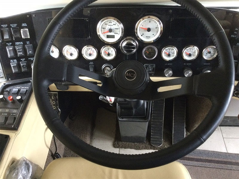

Next, I would reconsider a newer coach with newer electronics vs. the older electronics. Even if it meant a coach with more miles – with the provision that it was a coach that had been well-maintained. I’ve fielded complaints from diesel mechanics, and it has been hard to find a mechanic to work on the older DDEC and Series 60 engine when I’d run into a couple of more complex engine problems.
Dashboard of the bus.
I am not saying for sure I would have made a different choice, but I would have had more of a debate on the topic. I’ve also found the older engine control module doesn’t support certain other upgrades such as a Silverleaf dash setup. I’ve had several talks with Silverleaf but they eventually said that with the older DDEC II module, it wasn’t worth the effort to use their product for that application because it does not send a sufficient amount of information to monitor.
The Saguaro Bus at home in the desert.
