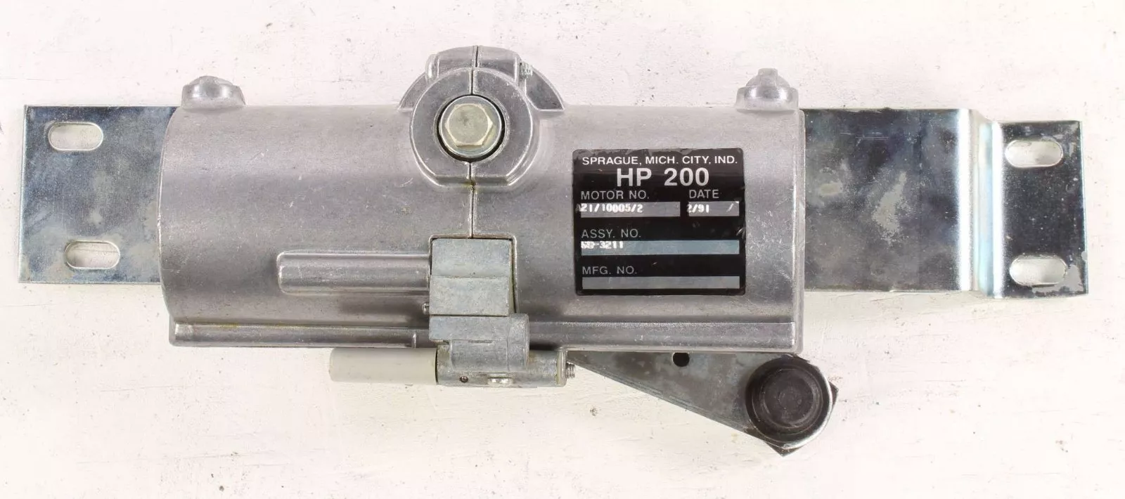

My bus air wipers work pretty well, but they are exhibiting a strange behavior, and I'm wondering if it is indicative of bigger problems in the future. When I turn the offending wiper off, it moves to the center of the twin windshields, as I assume it should, then slowly decides it wants to be on the outside of the windshield.  It starts moving to the outside very slowly and then slams to the outside, staying there.  I think it may be a leaky valve or something similar.  Any ideas? Post by: Sebulba

Have you recently overhauled or disassembled the control valves or wiper motors themselves, or have you reconnected any airlines to them? If the Park function seems to be reversed (you said "it slams to the outside and stays there"), that would suggest that the airline is perhaps not where it should be. There are three airlines to each motor: Run, Park, and Exhaust. Is the control valve hissing or leaking?
When I overhauled my Sprague HP-200 wiper motor, I inadvertently reconnected its internal timing rack incorrectly, and it operated strangely until I resolved the issue.

Depending on the type of lubricant that was used, the wiper motor can be affected by any moisture in your air system. Carefully disassemble and clean the wiper motor valve.   Don’t lose the O-rings. They may need to be replaced.  My Eagle wipers had dried lithium grease in them and did exactly what is being described.
My wiper motors were too far gone to operate correctly, so to save my sanity, we went with new electric motors and never looked back. Clean your windshields thoroughly and apply Rain-X in the meantime until you can repair or replace the wipers.  P.S. Mark your air lines and their orientation on the motors before disassembly.

I have done nothing, and it has always behaved this way for me.  It parks the arm where it should, and then it creeps, then slams to the wrong side.  I wonder if the Park feature has a leak in it or something. Don't know enough about how it functions to diagnose.
