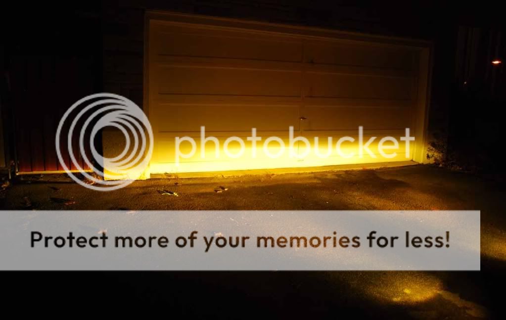

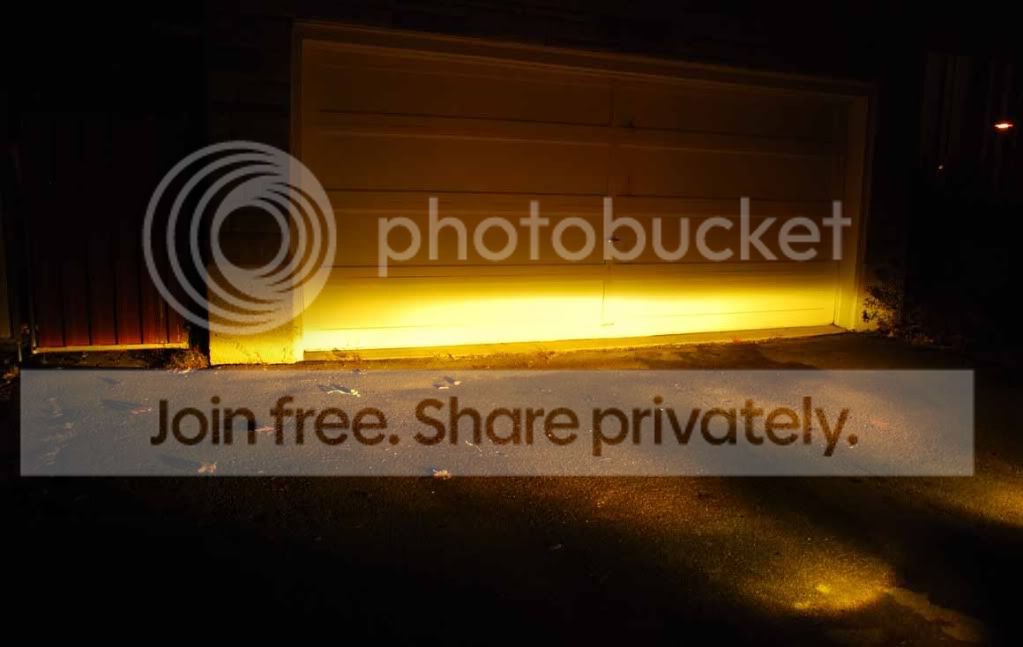

One comment be fore I answer your question - if you have "aux" lights, they should only be on when high-beams are being used and should be "off" with the low-beams.  Fog lights are only to be used with low beams and should be "off" with the high-beams.
Fog Lights have a very obvious cut-off if they are true fog-lights:
See this document by Daniel Stern (really nice guy by the way)...  The basic jist is, if the following conditions are met, do the follwing:
  • measured height of light 0" to 18" from ground, then @ 25' the cut-off shoud be @ -1.5" the light height
  • measured height of light 18.5" to 28" from ground, then @ 25' the cut-off shoud be @ -3" the light height
  • measured height of light 28.5" to infinity from ground, then @ 25' the cut-off shoud be @ -4" the light height
-Tim
[edit] Paso One has some good pointers, make sure the bus is in the typical operation condtion (load, fuel, etc.) if you have manual air valves or air up the bus properly if they are automatic.  I like the Daniel Stern method, as you can do it on any flat road with a tape measure (without hauling around a sheet of plywood, or a giant sheet and frame with lines on it).  You also need to make sure your lights are aimed straight (like Paso One mentions).  You can do this by parking against a "straight edge" in a parking lot (the concrete curb), and taking a measurement of the distance from the curb to the light, then at 25' you mesure where the hotspot is (or in the case of a fog light, find/measure the edges of the beam from the curb and divide by two) - the two values (at the bus and at 25') should be the same.  In order to work on one light at a time, just have someone stand in front of or put a jacket over one of them.  With our auto-ride height air-valves, the bus should automatically keep the at the correct height for each corner, thus loading differences should not drastically affect the aim of your lights... [/edit]
