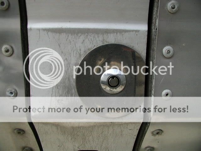

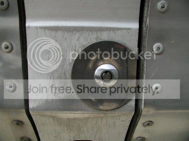

Reply #6 on:
May 23, 2009, 06:34:17 AM »
I have cam locks on my baggage doors. Look much better than padlocks. Here's a pic of the ones on my MCI
I installed the same kind on my 4104 when I had it and bought them from Butch Williams. He can be reached at butch at rvlocks.com or call him at five seven four-six six four-three three one three. You can get as many as you need and keyed alike. Last time I spoke with him he was working on a nice entry door locking handle using a cam lock.
Logged
