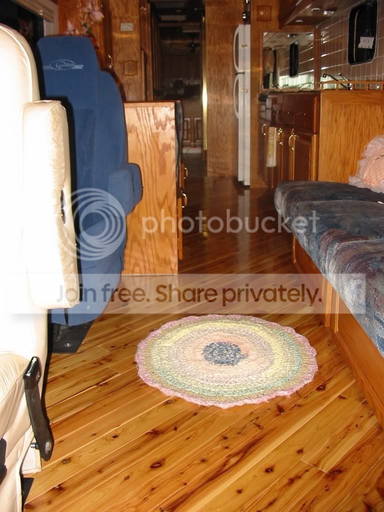

Ace suggested we do our Australian cypress Floor at a 45 degree angle.  We are very happy with the results. As was mentioned diagonal will hide any small discrepancies in the T&G joints which occurred during installation. Lengthwise will show every discrepancy as well as give a more pronounced "tunnel look". We did not care for the crosswise look, seemed to make the interior appear shorter.  Jack
PS: We chose flooring with micro bevel on ends as well as sides of boards.  This gives a little more traction when walking while bus is moving, as well as giving a better (matching) appearance between board ends and sides.

Jack, that is one beautiful floor. Well done! ;D

Yes, excellent  floor Jack.   When did you install?
Lengthwise will add the most illusory length.   Still, Jack's diagonal pattern adds to 'cool' factor.
JR
Thanks for all the compliments. The floor is prefinished Australian Cypress that we purchased from Lumber Liquidators. It is T&G on ends as well as sides and 7/16" thick (solid wood). We installed it using a floor nailer, putting nails about every 4 ".  We should have put down a layer of 15# roofing paper first, we still ended up with a few squeaks if you step in the right spots. We installed the floor in '03.  The finish has held up great, although we do have a few very small dings from me dropping a few things (mostly tools).  Jack
