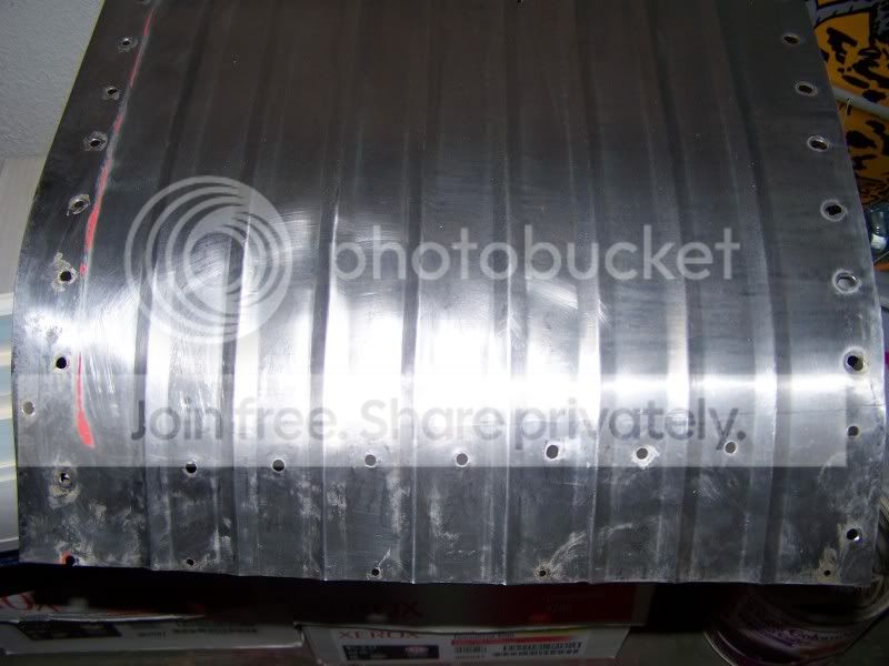

I got too thinking IBS wanted $800.00 per baggage door skin and that was no installation or fixing any sub structure I had to install them. Now that probably is a fair price but hey I'm a sheet metal man so I decided to fix the skins. They did not come out to bad. I planished the damaged area flat again using my pneumatic planishing hammer. Then I rolled the curve into it again and then used the Pexto edge roller to put the corrugations back in after making some wheels for it on my lathe. It's been a full day. Did I mention I fabricated the verticals also. I forgot to bring the 3/16" rivets home.
before
after ( not bad for a hillbilly )

Nice job, I don't know why you didn't do this in the first place??
Isn't it nice to have the proper tools?
Old buses like ours should have a bunch of "personality" dings anyway!
Who wants to be perfect?
