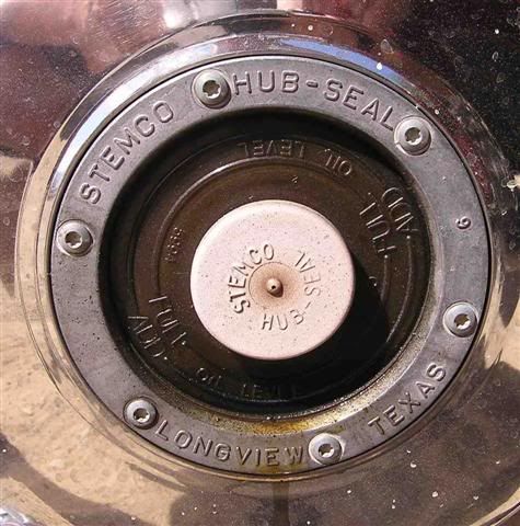

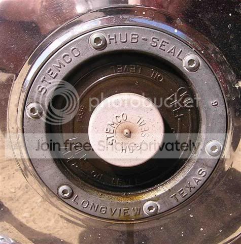

Re: Front Hub Grease
« Reply #11 on: July 22, 2009, 06:56:37 AM »
John,
If you are filling your hubs up to the bottom of the plug you are putting in WAYYYY too much.
See the photo I've included for the full and add marks.
the low mark is about two thirds of the way from the plug down to the edge and the full mark is about a quarter inch closer to the plug. By over filling, your inviting seal failure, especially if the vent hole on the plug becomes plugged.
The seal isn't really meant to be run IN the oil, it's meant to retain the oil on the lower metal portion and act as a wiper and seal on the rubber part.
Only the part of the bearing is actually always in the oil and that picks up the oil with the rollers and splashes it the rest of the way through the bearing.
