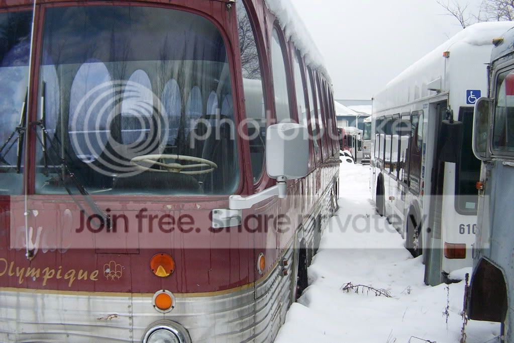

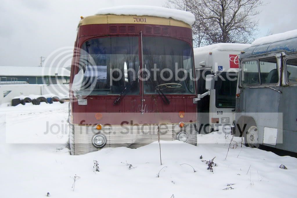

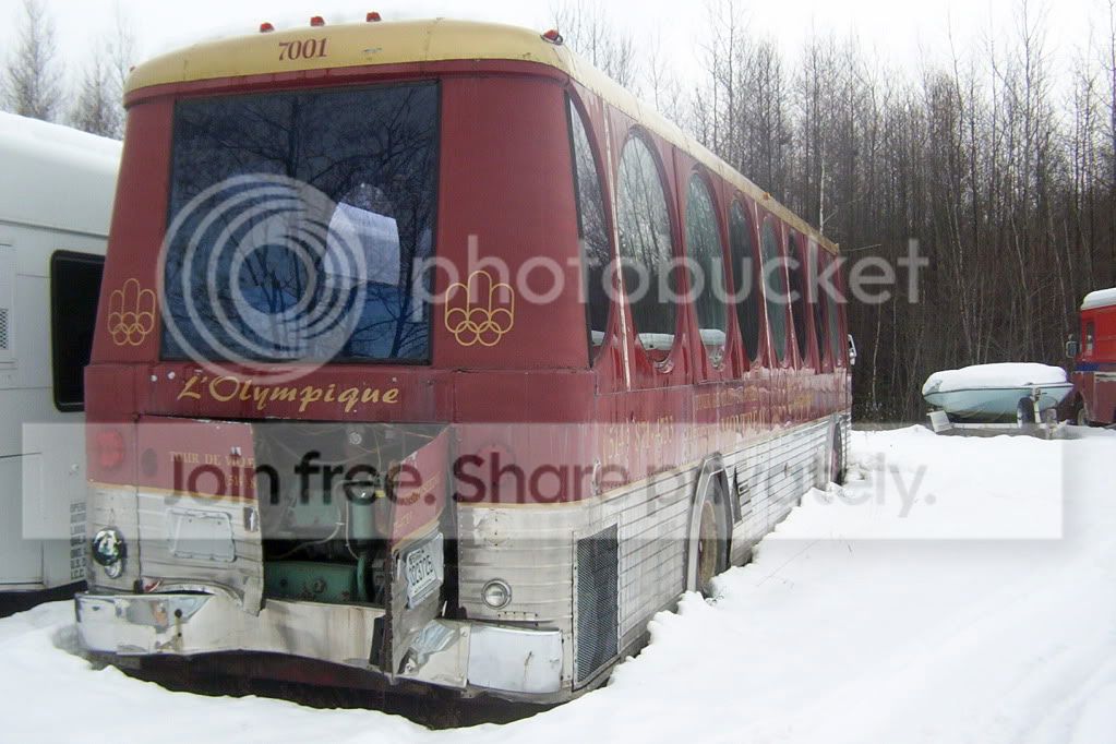

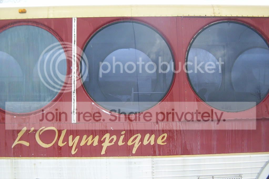

« Reply #1 on: September 05, 2009, 05:48:36 AM »
That bus with the round windows is cool any more pics of it?
Offline zubzub
  • Posts: 1212
    • pics of my bus etc....
Re: question regarding rear brake relay.
« Reply #2 on: September 05, 2009, 07:58:39 AM »
I have a few from last winter.  This was the 76 mtl olympics bus, my gus guy said there's is talk of tarting it up and sending out to vancouver for the olympics...it's pretty rough but there's enough stuff around he could do it.  Saw my first V6-92 changed out of a transit yesterday, not as easy as it's sounds but I guess easier than it could be.
