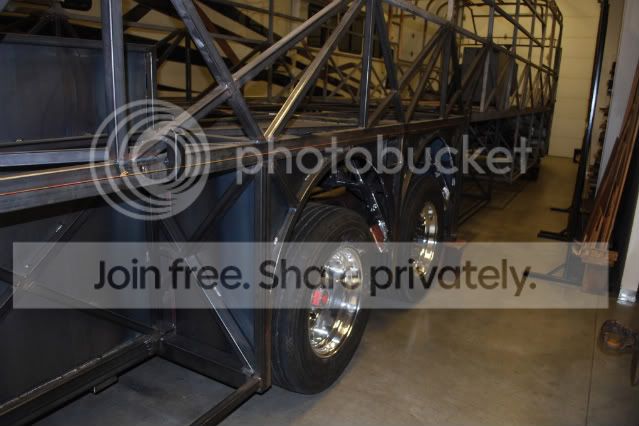

This whole thread was worth it just to see the pics of your bus project. That is INCREDIBLE! I stand in awe. I would love to see more pics of it. We were disappointed that we couldn't stop and see it in person. Maybe someday.

I am putting 4 of them on my 15.
Good luck Wayne
Wow, Rusty,
If that is a current picture you have about 3-4 years worth of work ahead of you.  It kind of nauseates me to see that and remember my coach when I had it all tore down and welding on my frame.

Thank You When I was pricing the tires One supersingle was just a little less than two regular tires. The Rims were 500 a piece. I will wait to buy good tires untill I get closer to being finished. If you want to see more I have my projest on the Eagle web site. Go to http:/eaglesinternationals.net, Go to the forum then to Eagle projects my thread is under 1994 Eagle 15/45 by Wayne Schell.
Enjoy Wayne

Wayne .....  one word ..... AWESOME ....
