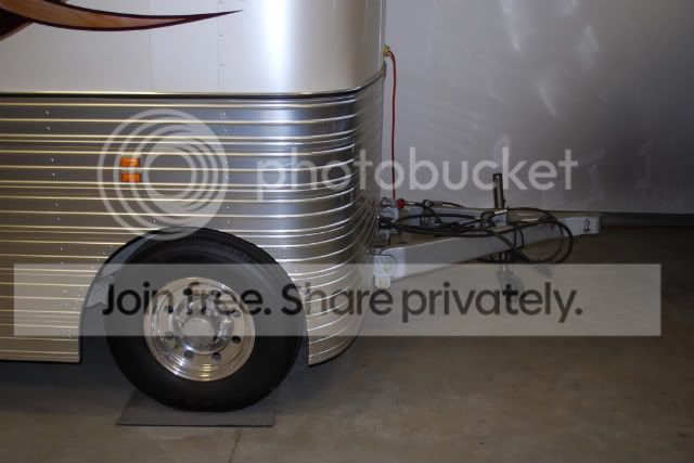

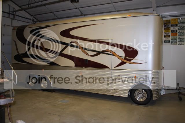

My wife and I both like to go fishing. I did not want to use the bus to back the boat into the water. I needed a trailer to haul both the boat and a vehicle to get the boat in the water. I also did not want to over load the frame on our eagle. I found a trailer built by Competive Trailer in California that has a steerable front axle. This trailer follows the bus very well you hardly know it is back there. The nice thing is it can be backed very easily. When I but the bus in reverse a relay operates a hydraulic motor that rotates the front axle and puts reverse caster in the axle. I have put the trailer in some very tight spots with little effort
good luck Wayne

Good Golly Miss Molly, That's sweet! ;D
What is the length and capacity?

That has got to be the coolest trailer I've ever seen!!!
Old Scool Bus
  • Guest
Re: 4 down trailers or wagon style
« Reply #12 on: November 30, 2009, 08:14:25 PM »
That is Frickin SWEET!!!!!
That is what I plan to do someday but chopping up another bus that matches mine and doing it.  COOOOOL!!!!

Dang rusty , Your in the wrong busness lol . and they say it can't be done . You the man

Rotating the front axle to change the caster for backing - what a most excellent idea! The best of both worlds!
Dang, another project for the wish list.
What system is used for the trailer brakes?
Do all 3 axles have brakes?
More pictures of the front axle mechanism? That is a fantastic trailer. Thanks for sharing.
