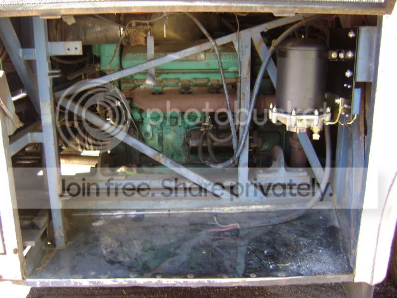

This is where we installed one on our 01 Eagle. I know it's an MCI thread but it's still a drier install.
Not sure where in an MCI you can mount it, just food for thought.
The air line come out of the compressor, over to the ping tank on the opposite side then back the the drier. I installled a switch for the heater with an LED so I can see it if it's on, that is if I remember to look!
