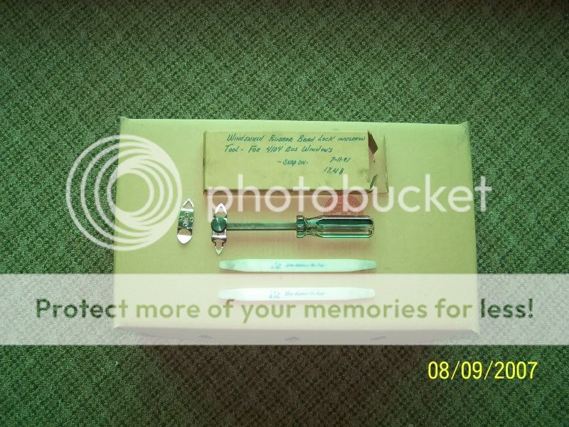

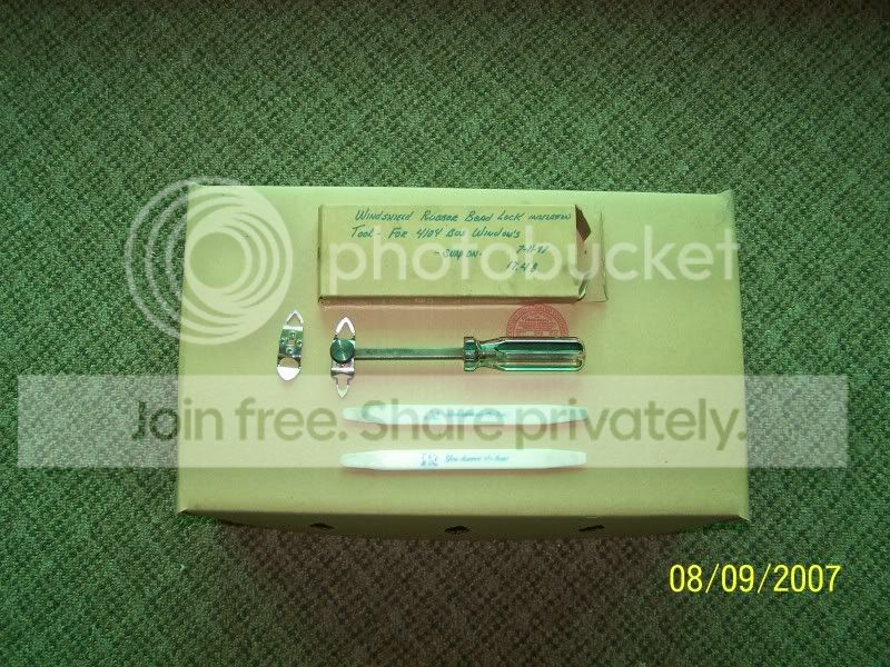

On our Eagle we installed the rubber first with a piece of 3/8" rope under the inside lip to aid in installation after the glass was in place. Pulled on the rope over and around the inner frame that is secured to the main frame. Worked the rubber seal with a tool made from UHMW for installing glass. Then installled the lock strip with another tool made for the job. I used a deluted spray bottle of soapy water to make it easier to work the rubber.
This was to install the original glass, not new. I did this all by myself with a cheap suction cup tool from Harbor Freight.
Sure hope it goes better for you the next time.

Ruthie, the tools Paul has in his photo.........are the tools to use.......those composite hand tools are awsome and you can find them at Harbor freight also and they are about 3 bucks.  The cord locking tool is also the tool to use.
I broke two windshields when I was installing my front windows, but it was my fault, when I raised the roof I closed the opening up in two directions for a total of maybe a 1/4".   After backing up and opening the windshield opening.....it went right in!  It's a two man job!   Soap and lots of water make it work, put the gasket in the opening, then start the center post section by pushing it into the groove while working the top and bottom gasket over the window take your time!
Pat
