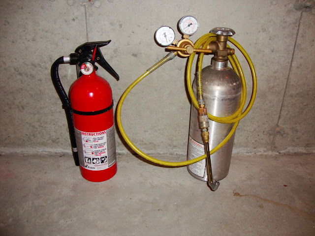

I have used Nitrogen in my race car's tires for years.
Here's my portable set up
Note my Schrader (sp?) valve on the end of the hose!  I used the tank to fill the inside rear tire on my bus after having new tires installed and getting a faulty valve stem.  The shop installed a new one free of charge, but that nitrogen tank filled that tire from 40 to 90 psi numerous times!
On air, I get 10psi rise in tire air pressure on the track in three laps.  With nitrogen, only 4 psi!
I use it in my car trailer tires.  I've never had a blowout since.
The benefits are true.  The cost??? Who knows.  It's all part of the racing budget. LOL!

Umm, all gases expand exactly the same way.  The equation is PV=nRT, also called the ideal gas law.
If the absolute temperature goes up 10%, then either the pressure or volume (actually, the product of the two) must also rise 10% -- it doesn't matter whether the gas is nitrogen, oxygen, helium, or even steam.
There are exceptions to this rule at extreme limits, when gases are said to be "non-ideal," but that does not apply to air versus nitrogen in tires.
Note that any liquid component will change the dynamic.  So if you have entrained water in the air supply, then, yes, as the tire heats, the water will vaporize into steam, and that will increase the pressure (or volume) by a greater percentage.  This is one reason why the air supply should be perfectly dry for airing tires.
... On air, I get 10psi rise in tire air pressure on the track in three laps.  With nitrogen, only 4 psi! ...
Then you had water in your air supply.  See above.
Nitrogen molecules are larger than O2, so they do not leak out of tires as quickly.
OK, this part is true -- but just barely.  The difference in size is minute.  Also, if this claimed benefit is really operating at any significant level, then, theoretically, your tires would be mostly full of nitrogen after a few top-ups anyway.  Air is 80% nitrogen to begin with, so after first airing up the tire, it will be 80% nitrogen.  Now let's say that all of the oxygen leaks out, and you find your tire pressure to be 20% low.  You fill the tire back up with air -- now you have 96% nitrogen and 4% oxygen.  If that 4% also leaks out, when you top up again, you'll have 99.2% nitrogen, and only .8% oxygen.  Etc.
