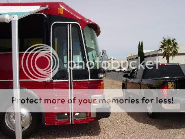

Howdy Eric. Having the double doors was always a pain in the you know what. this is the before and after.
  Before
 After welding the doors together
And this is how it looks now
hinges
lock
Tight on funds right now,so I wanted the functionality of a single, with the appearance of a double, ;D ;D
 I used 3 commercial SS ball bearing hinges and a surface mount rim cylinder latch lock. Still use the original camlock dead bolt that was used before door conversion. I hope this helps,good luck.  V. 8)

Van- Exactly! i was hoping i wasn't alone in the door dilema.are the 5 pieces of iron the only thing holding them together?

Eric, yes the 5 pcs. are it. I actually followed SUNCHASER ART's build, and with the exception of doing a full skin to recover the door (broke right now), tried to make it usable as is,by modifying the center rubber strips to seal the door. On an Eagle, the weakest part of the door( why they never seal right) is the upper portion ( around the glass), so I pre bowed the upper frame slightly to provide a proper seal when closed. After a few test runs down the freeway at speed, I was pleased at how snug the door was, even at 80 mph. I look forward to the artical in the BCM (as well as the issue  ;D ;D) but here is a link to Art's build site, http://www.webcove.com/eagle/.  Check March 05 for the door build, good luck. V
