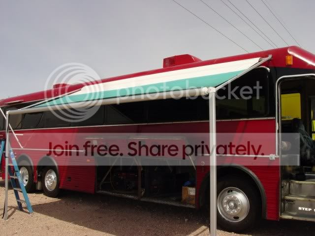

Chaz, see if this link works, Eric Brown (Ericbsc) here on the board is a Carefree dealer, and did me right when I got mine, needed the legs and hardware, which he got to me the next day :) I mounted the awning rail 6" above the drip rail on our Eagle, your bus might be difernt. Eric's number is 864-599-zero two two 0

 here's ours, LR
