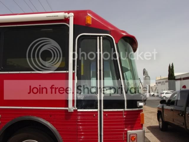

Thanx again Van, It was good talking with ya. I went to that site and it looks like I have an older model yet!!! As I thought. It may be a predecessor to one of those shown. I just didn't see the same configuration to any of the hardware. I may try to take pix of what I have and post it, but basically, I think I can use the info of one of the models shown. Three of them look similar: Spirit, Fiesta or Simplicity Plus.

I think I would actually like to add that Newbee. But, again, I'm not sure I can. The "age thing" has me concerned. I also read something that what I think they do to the regular canopy's is "weld on" (as it were) something to protect the canopy when it's rolled up. I think they just mean they basically "melt" another layer of something on the first foot or so from the bus to protect it. "I think"!!  And as far as adding a foot or so with the aluminum protector, I would really like that but I am concerned about possibly having to shorten the arms/legs the way it is. I haven't done any final measurements yet, but I may have to do some "modifications". If anyone else has put one on a Buffalo, I'd like to know if anything like that has to be done.
 Because of the "step" on the top of the Buffalo, putting it over the door would be VERY hard to do. The end would basically have to hang out in the air. But a smaller awning could maybe be put there.

Got it!!!!!!!  Thanx Laryn! It didn't want to work at first, but it came up. I just breezed over it but didn't notice anything about my one main question: Do I HAVE to attach the bottom of the leg at the floor line of the inside of the bus? I'm just wondering if the distance from where the awning is mounted to where the bottom of the leg is mounted makes a big difference. I know there are some adjustments on the pieces, just not sure of the parameters. I guess I will find out when I do it. I just wanted to have that figured out when I call in a couple markers from friends to come over and give me a hand. I'll look it over a little better tomorrow.

Chaz, they recommend mounting the lower leg mount at the belt line for rigidity, it will flex in and out if just mounted to the panel alone, adjust the leg length to accommodate the height of the roller. This is not to say the lower mount cannot be mounted higher if needed, as long as you add some support behind the area needed to prevent the flexing that will occur with the awning open and the weight is on the legs. If your side panels are part of the support structure, the height of the lower bracket might not be so critical. install the awning rail first then measure down( plumb) to accommodate for the length of the fully collapsed legs, so you do not end up short, you can then extend the measurement if needed.
I only had to extend mine 1 Hole to match the bottom, had I gone higher, just would extend that many more holes.
