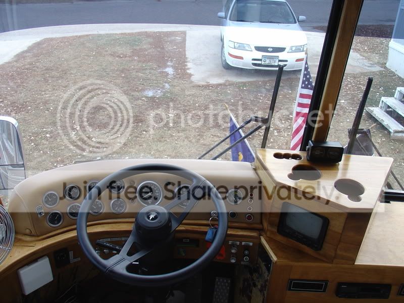

  Here's a picture of the dash in my Eagle I don't know if it help , but here ya go

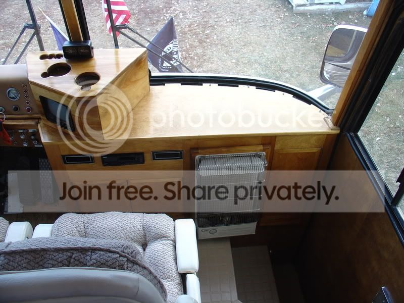

« Reply #7 on: July 05, 2010, 02:26:28 PM »

The bad part about my dash is that the bottom of the windshield is lower than the edge of the firewall or whatever you want to call it.  I can't just go straight across like you did.  I actually need to go up to accomodate all of the defrost ductwork.  I wish it was as simple as going straight across.
Andy, how did you deal with the defrost ductwork and vents?  Also, did you use plywood for the top or solid wood?  It kinda looks like solid wood, buy I never know for sure.  Thanks for the pictures.
Arthur, wouldn't MDF be kinda heavy?  I would also worry about water if the windshield or anything ever leaked.  The only thing I have personally used MDF for is a countertop I made a dozen years ago.
I'm starting to think that vinyl for the dash with maybe laminate for the firewall might be better although Andy's dash is the look I was originally going for.
