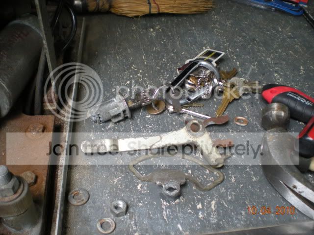

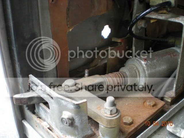

So, I have a leak in my air system that I *still* haven't fixed yet. Since my doors are held shut by the air system, after all of the pressure leaks out, my door swings wide open! NOT OKAY! I'm worried that someone will go in there and steal my awesome stuff.
So, I went about trying to fix the lock. First, I thought that I could just easily replace that little cylinder (it had corroded and so my key didn't fit into it anymore), so I began taking the locking mechanism apart... and discovered that everything was just stuck and corroded together. Nothing moved, even with the bang of a hammer! I just bent stuff... nothing actually worked anymore. I decided to just take the whole thing apart and try to bend things back together and lube them or something...
erm. no good. I ended up breaking some things. As I was about to start looking for the replacement parts from Prevost, I realized... I DONT WANT THIS LOCKING SYSTEM!!! It's lousy! I want one of those nice and simple RV-style, house locks. None of this air crap!!! What happens if suddenly, something happens again to my air? What if I have a steady leak, and if I land somewhere for a week vacation, or store my bus for a month... what, my door is just going to pop open all of the time?? Yeah, I realize that if I lock it, then the air release won't release it, but can't I also have the door shut, not locked, and staying put??

I too have a Precvost with an air operated door and also experienced the door opening after the loss of air but, once I understood how the door works, I wouldn't change it for anything. It seals tight when in use and keeps all road and air noise gone. It locks and unlocks with a key just like any other lock. I did have to replace a "Norgren" valve under the dash and then it worked and has worked like the
engineers designed it to.

Like Ace and Eddie,I to kept air door lock and just plumed in a aux tank with a check valve to keep it from back feeding into the bus air when it goes down..I put a button elect switch just above door handle to make it easier to open with one hand..Just run wires to pressure release valve for door..penetrating oil will help door release mech..Bob 89 prevost
