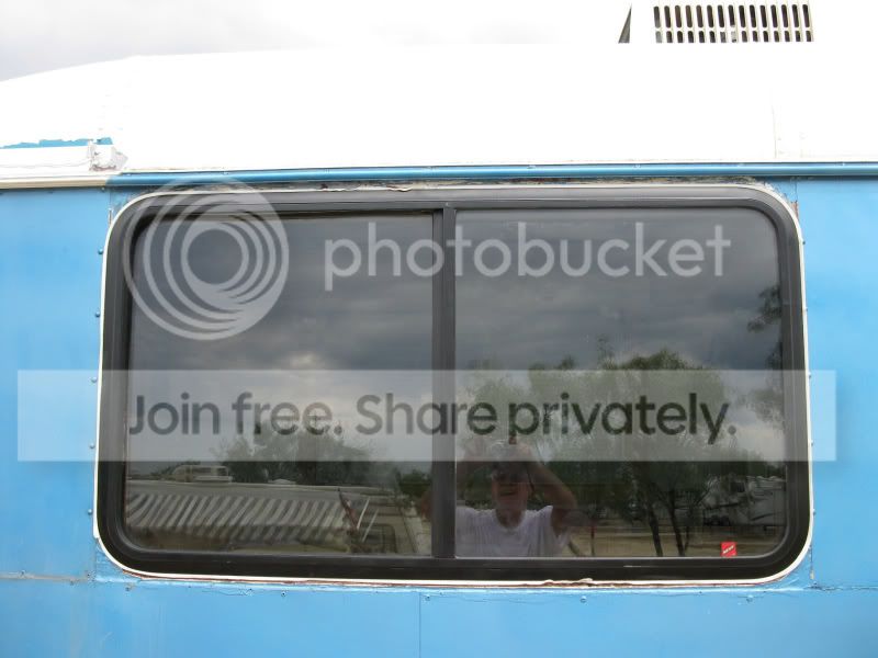

« Reply #13 on: October 25, 2010, 01:41:27 PM »
Here is a photo of the Hehr windows we installed to give you an idea of what Cody and I are talking about.
