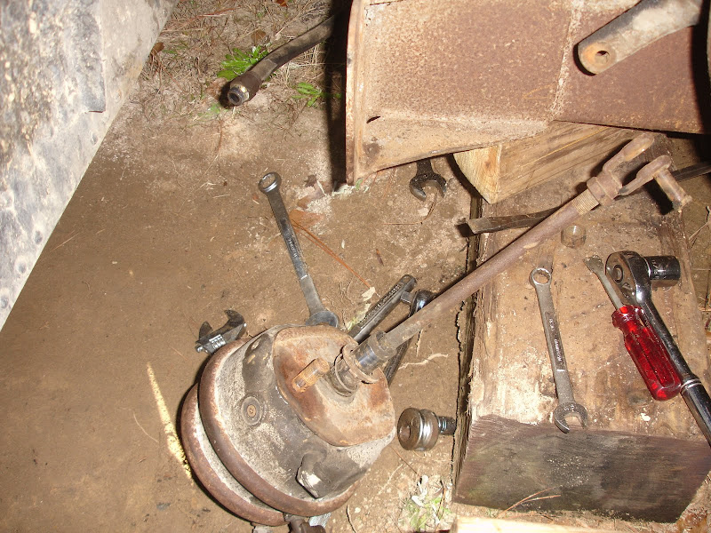

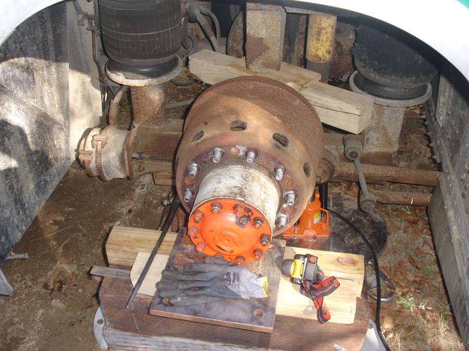

Hey folks, thought I'd start a new post to show my progress with the removal and disassembly of my DD-3 brake actuator. I'll try to keep adding pics as I get parts from Luke for the rebuild. Let me know what you think....

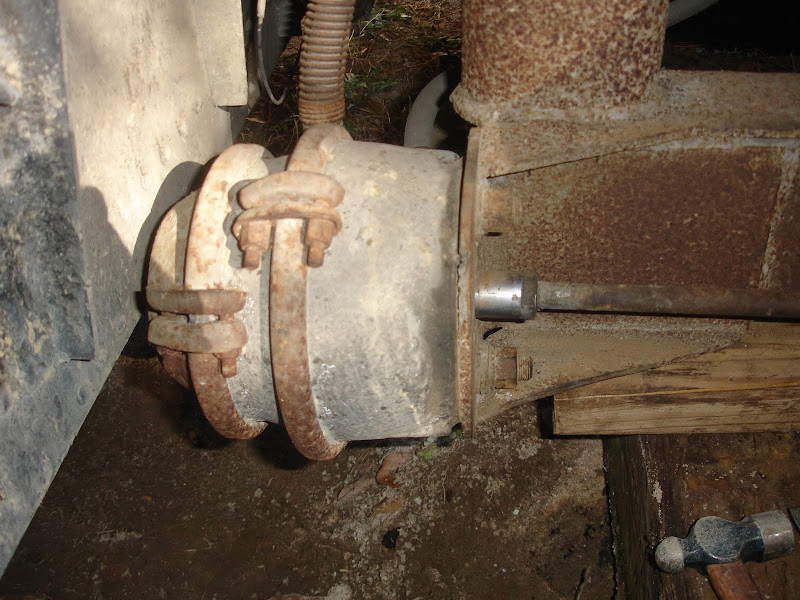

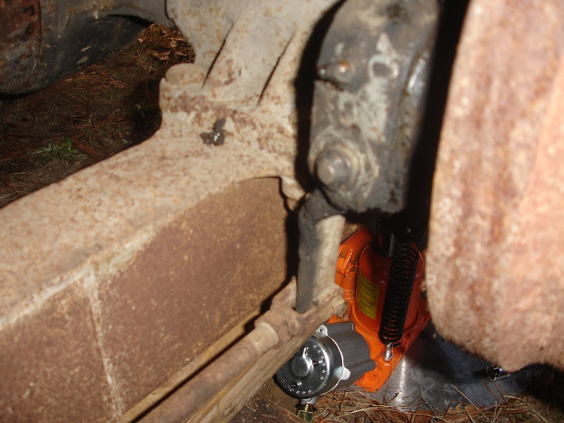

Here's my blocking and cribbing technique....

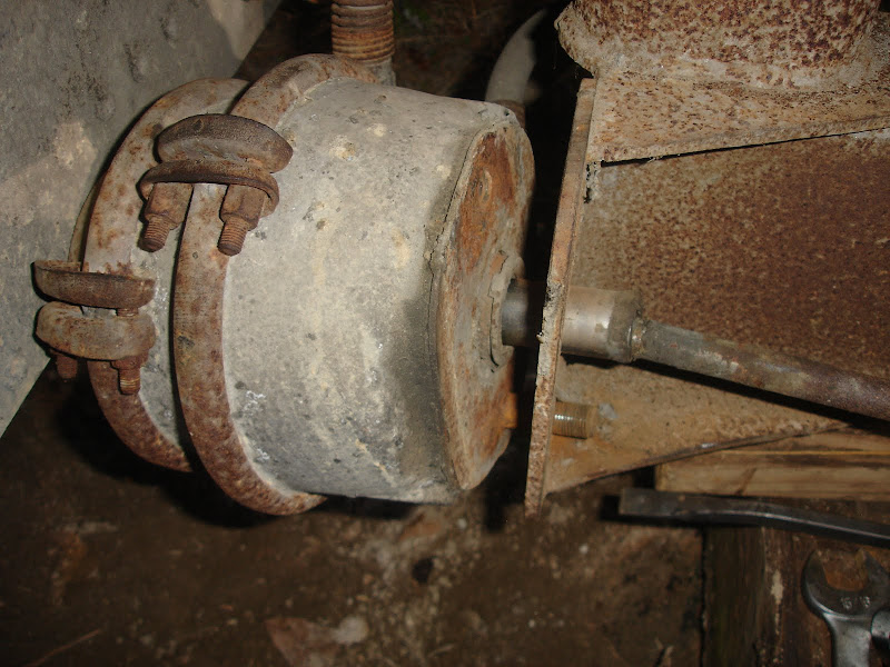

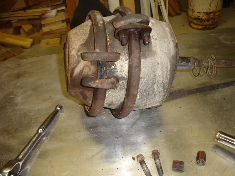

Pics of the can before removal...

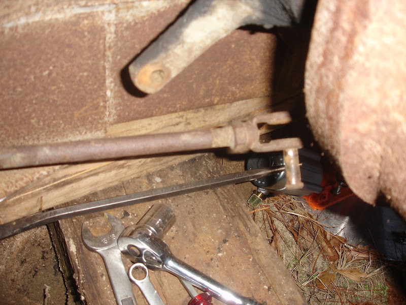

Push rod to slack adjuster connection....
Pin removed from yoke and adjuster...
Can unbolted from frame...
Ahhhh.....removed at last...

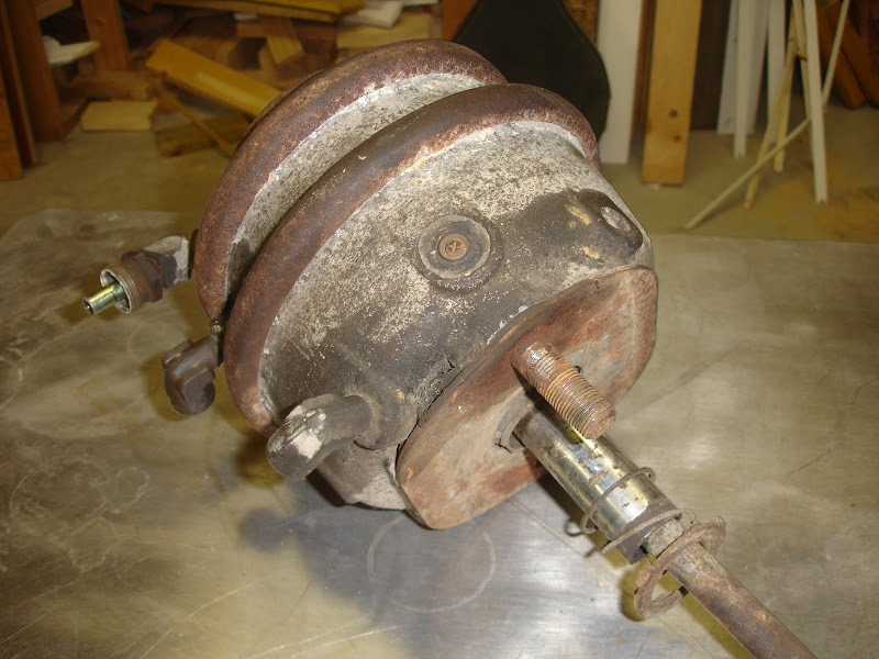

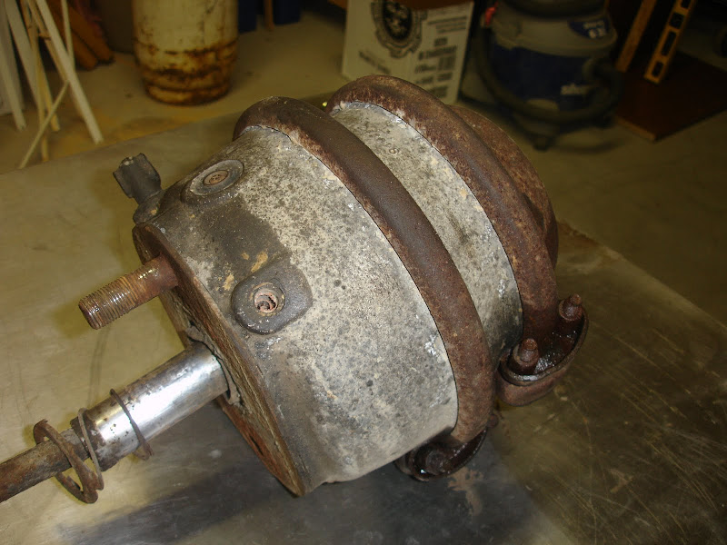

On the table in my shop, ready for disassembly...
Another angle...

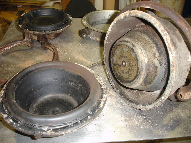

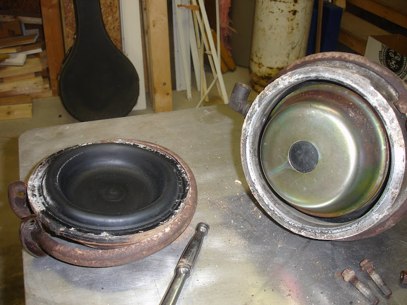

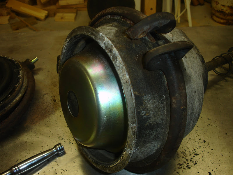

Auxiliary clamp ring loose...

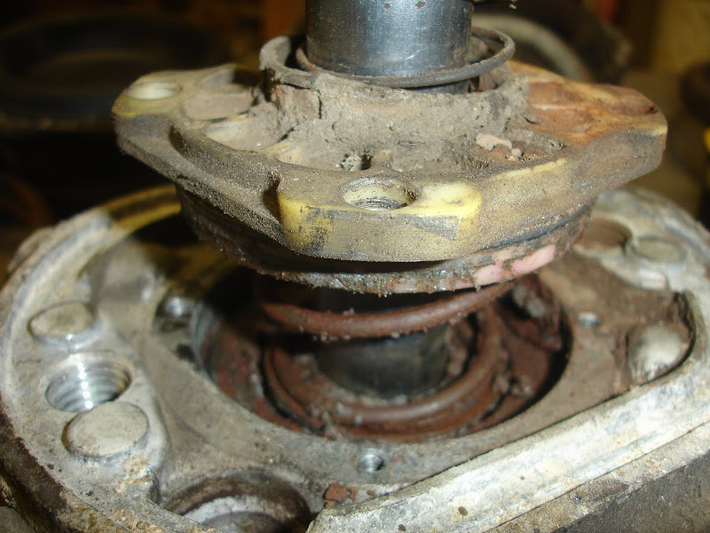

Auxiliary pressure plate and diaphragm removed...
Service clamp ring loose...
Service pressure plate and diaphragm removed...

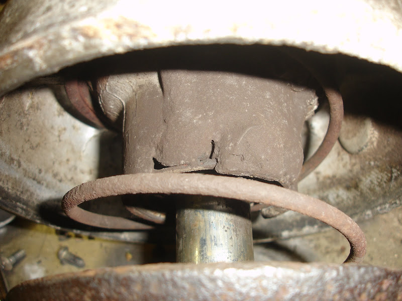

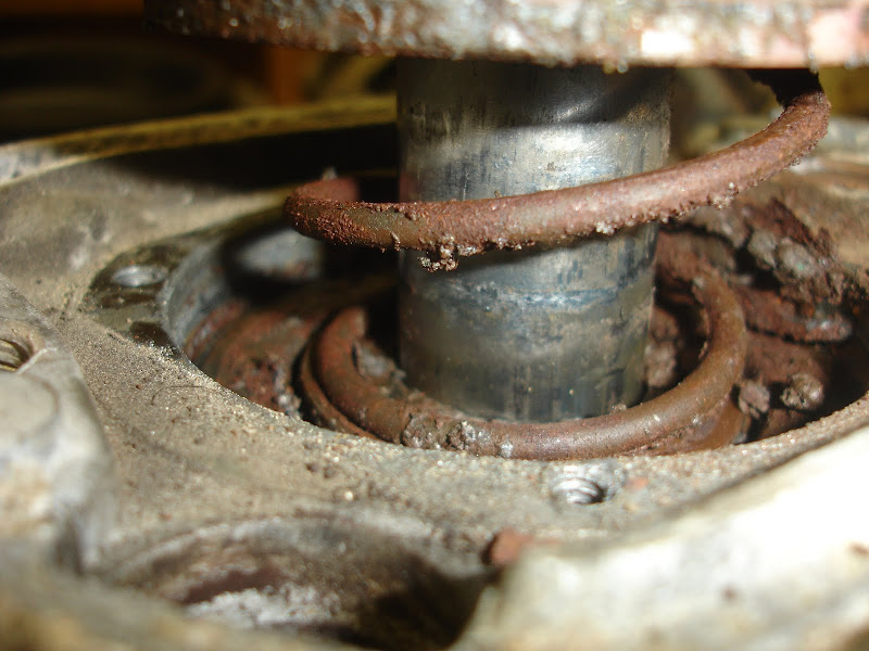

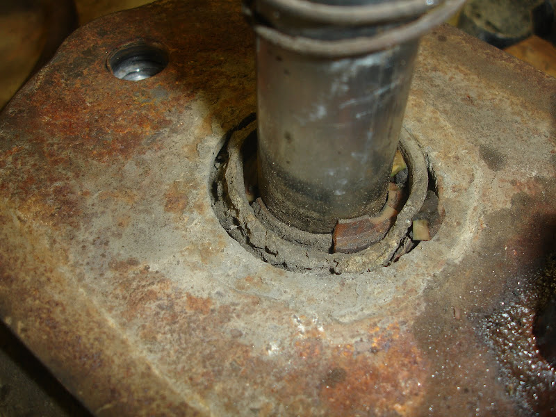

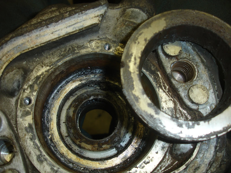

Here's a look at where my push plate shaft exits the non-pressure plate....looks a little damaged huh...and yes, there is supposed to a boot here... :)

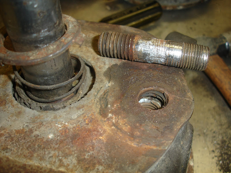

Had some trouble getting one of the mounting studs loose...

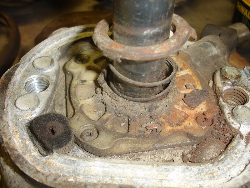

Here's a view with the spash guard removed.....nasty...
Lock cap unbolted...
This thing is in bad shape...

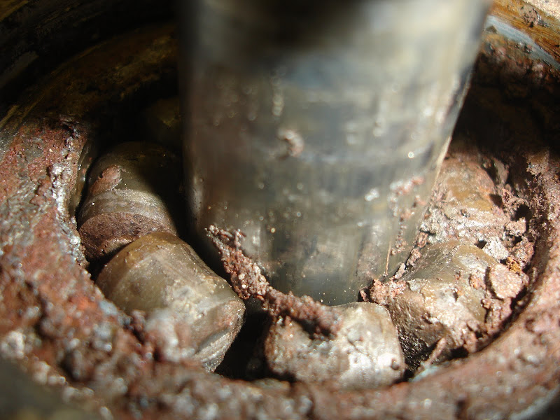

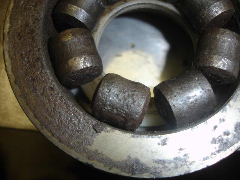

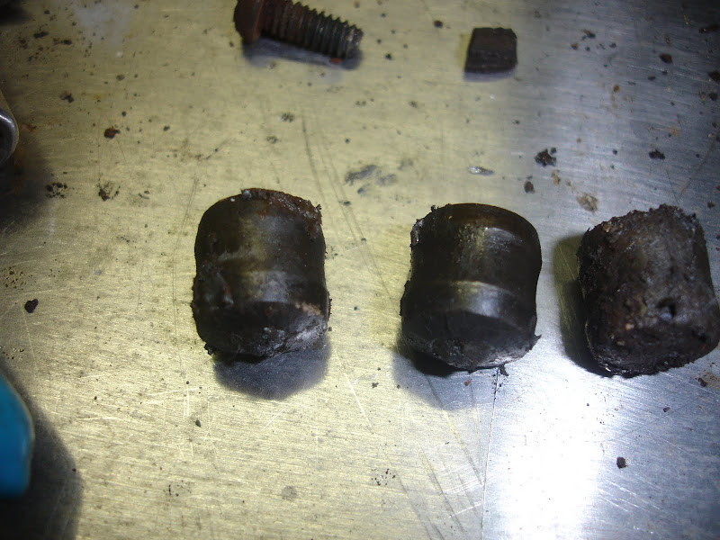

Here's what's left of the rollers...actually a few of them appear to be OK....
Here's a close up of the rollers removed....the one to the right is a good example of how they shouldn't look...
A view of the push plate and shaft from the inside of the non-pressure plate
Here's a shot of the collar removed with the piston still installed...the rollers fit between the two...
This is a close-up of one of the main reasons for not being able to get my brakes to release.....a special hats off to the previous owner for not keep up with periodic maintenance....

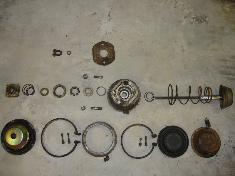

And last, but not least, my own version of an exploded view....
I've got my part list created and I'll be giving Luke a call tomorrow to see what the damage is. I've actually had fun (considering what I've had to do). It really wasn't all that bad. I would definitely recommend this approach to anyone who has the mechanical background and the tools necessary to get the job done. And I would like to thank all those who helped me in this post ----->http://www.busconversions.com/bbs/index.php?topic=18442.0.....without your help, I couldn't have made it this far....

Great pics Is one of the diaphragms ruptured?

Nah...the diaphragms looks good.....no dry rotting or cracks at all. It looked as if the can had been rebuilt in the past. I'm guessing that the roller condition was causing the whole problem....at least I hope so anyway.

Yeah I did. It was leaking from around the rear of the can where the push plate shaft exited. As far as I can tell, when you push in the park brake valve, the lock port air line is pressurized which supplies air to the back of the piston to relieve the rollers and the mechanical lock they apply to the push plate shaft. I can only assume that the air was leaking past the piston sealing ring because the rollers were locked in place (due to rust and corrosion).

most of the damage that I can see in the photos looks like it is from moisture in the air system. of course sitting and no grease does not help either.

A couple of suggestions:
You might want to crib under the beam where your jack is. Cribbing under the end of the axle means you can't turn the drum when you adjust the brakes.
It's a good idea to mark the parking and service chambers before you remove them, so you can get them "clocked" correctly on assembly. You may have done this, but it didn't look like it. If you didn't, your excellent pictures should help  you figure this out.
I see some cracks in your service diaphragm around the circumference where it seals on the chamber. I would examine them very closely and consider replacing them.

Bob and Chris, I do plan to remove and replace both the inversion and relay valve(unless they are in good condition and can be rebuilt).....and change all the air hoses in this compartment...
Chris, I do have it cribbed under the axle. You can't really see in the pictures. I blocked out on the end of the axle to give me some added feeling of security. Unfortunately, I'm working off of the ground and whatever this point of the bus weighs (I estimated around 6000#), it was enough to drive my jack, and the larger piece of 3/4" plywood beneath it, down about an inch. I ended up finding some larger pieces of steel to use as a bed plate for my jack, and all of the cribbing, to help distribute the weight evenly to minimize the sinking issue. I also decided to leave the jack in there for good measure too...
