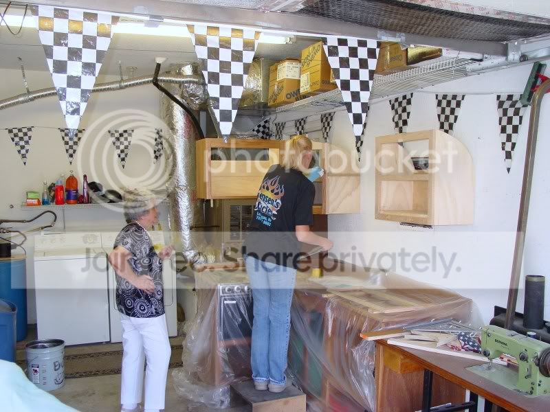

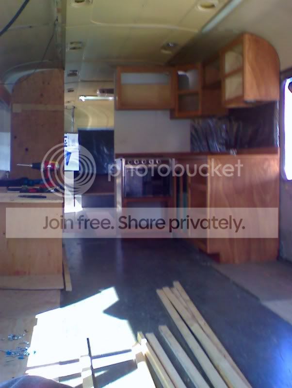

We did our own, no experience necessary, you'll get that as you learn lol. I felt no one was gonna put as much love into it as I wouldin making them fit and be strong enough to hang from. Kreg Tool and You-Tube got me up to speed rather quickly I might add. Here is a pic of ours good luck.

Van, those are nice cabinets.
