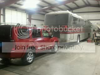

towing 4 down
« on: September 19, 2011, 07:38:41 PM »
I always thought it was silly seeing all the flat toads behind buses, with the wear and tear on tires and suspension. My intentions were to dolly our Kia but watching others at campgrounds and hearing stories we decided to trade our Ridgline in for a jeep. Neither one of our vehicles would tow flat. Jeeps seem to be the dominant toads by far so if you can't beat em join em.
