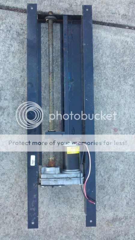

Doug bought a couple of these yesterday and we can't figure out how it's wired for in and out direction. I did a search and came up blank. With two wires coming out, one black, one red and two studs. Is one stud a ground? How do you wire it for forward and reverse?

Paul, it is in the switch it reveres the current ask Doug how many he needs I have some HWH F/R switches in a panel with the off and on and locks also George gave me a few years ago,if memory serves me red wire is out and black is in nether wire is grounded

That is a permanent magnet motor and it is reversed by reversing polarity, much like a power window in a car.
You can use a DPDT Center Off switch, preferably spring loaded in both directions to control it. A power window switch should work as well.

The type of switch you want is a 'double pole, double throw' type (six contacts) I had to wire one up some time ago for a project I built (a mechanism to move an LCD screen up and down). It took me ages to figure out how to wire the switch up, but my brain was probably being slow that day.
BTW - it's hard to judge the size of that slide mechanism in your photo - is it from a room-extension slide, or something smaller? If it

This is not mine, and it's not for slides. Doug has other plans for their use.
The unit is about 36" long. We are assuming they were for slides.

That setup does not appear to have limit switches, which I would consider adding so that the motor cannot be powered up against a stall condition (unless they are built in already).

The limit switch is built into the motors Len

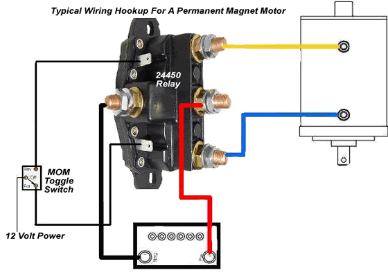

Thanks all for helping me understand what we are dealing with. I think I'm closer to understanding how it works. I just need to wrap my head around the diagram below. The motor is not grounded, each wire lead feeds the direction of the motor, forward or reverse. Does the motor have two separate sets of magnets for direction? What am I missing? The motor will not work without this relay?
It was taken from this site.
http://texasindustrialelectric.com/relays_24450.asp
Logged

Why do you think that the motor won't work without that relay - has the motor manufacturer said that? If not, it just looks like an alternative (better for higher currents) way of reversing the polarity than doing it at the switch.
Regarding the ground - on DC components, ground is used as a common negative* connection for everything - which you can't have if you want to be able to reverse the polarity to one component. The motor doesn't need to have two sets of magnets (or field coils), one for each direction - as with any normal DC motor, if the polarity to the armature windings is reversed the motor will turn the other way.
Now a question from me:- if the limit switches are 'inside the motor', are there proper (and adjustable?) mechanical switches in there? There might be, but if they're inside the motor I'm not sure how these would be arranged to detect the limits of travel of the external ballscrew. Alternatively, is it possible that the built-in 'limit switches' are actually stall-sensing circuit somewhere - possibly inside the motor or maybe part of the original wiring harness or switch? I might be very tempted to adapt this slide mechanism into whatever device (generator slide etc) that I'm building, then, once I knew exactly where I wanted the 'in' and 'out' positions to be, fit my own brackets and limit switches in the appropriate places
