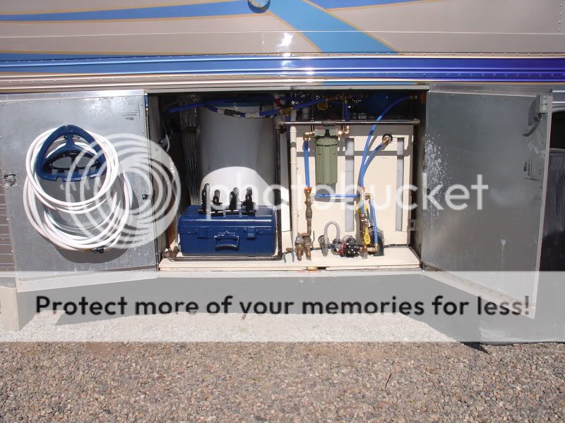

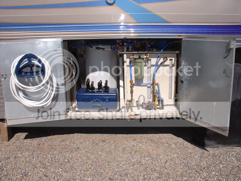

Here's a picture of my water closet, fresh and gray  water tanks water heater and on the other side of the water heater in the Generator. I have to open bays.
