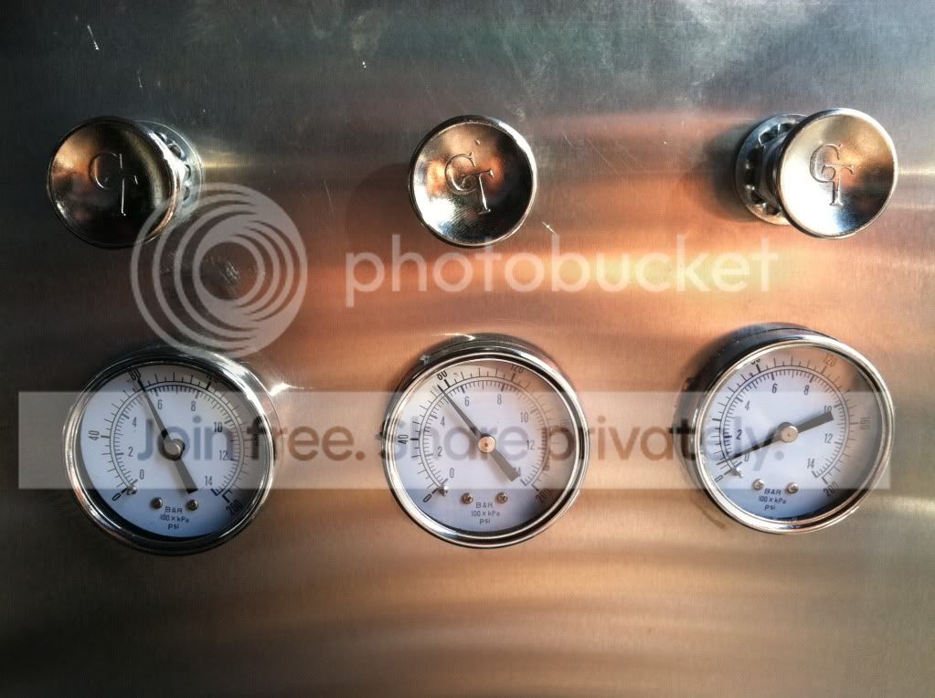

Bussman84, here's a shot of my valves and gauges, nothing fancy at all. Left gauge is left rear, middle is front, right is right rear. Sitting on incline, almost all air out of right to level coach. Looks like I need to do some stainless polishing. ::)

  I intend to only run fuel down to half a tank, and fill the water up full with empty waste tanks, and run until the waste tank is full. I just cant imagine ever having all the tanks empty, or all the tanks full, at the same time.
  I expect to see a max weight change on the front axle of less than 500 pounds from burning fuel, and virtually zero weight change at the rear.
  Bussman, where did you get the push/pull valves?
