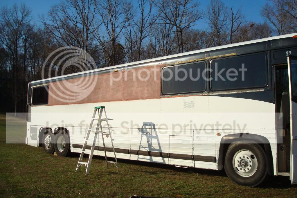

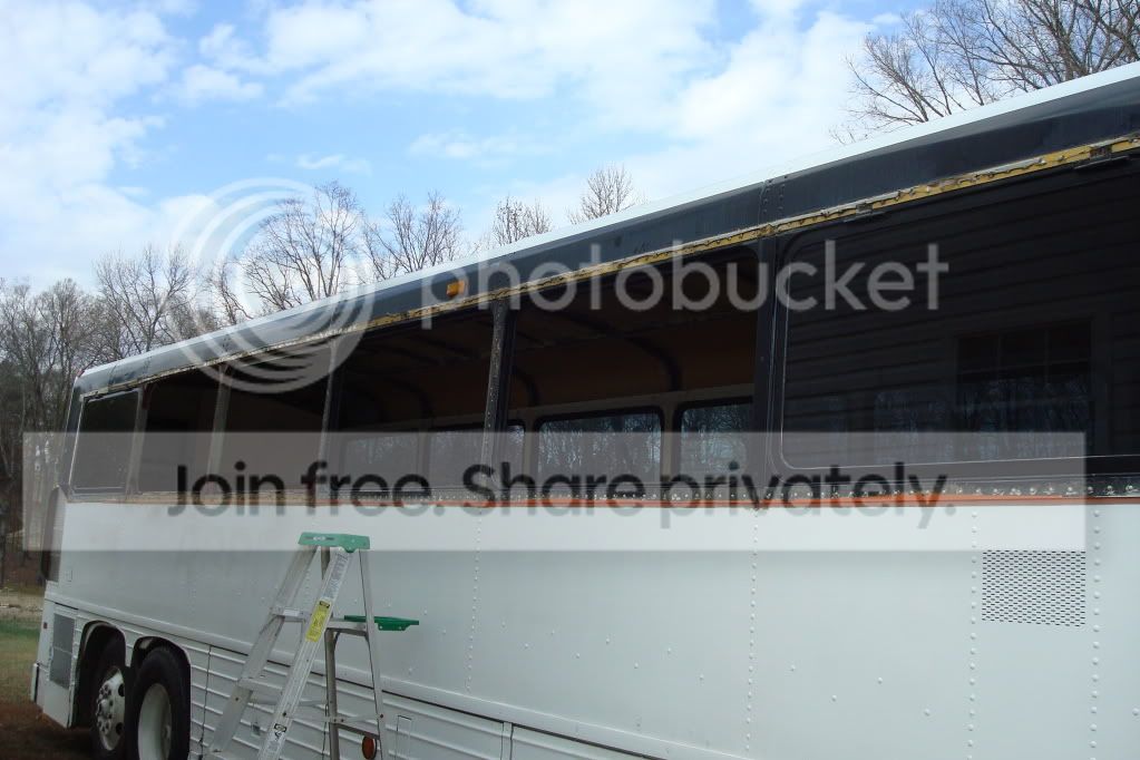

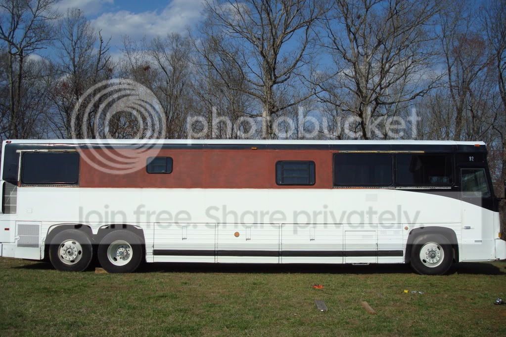

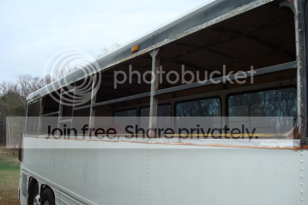

Preston.. I used steel sheets in 10ft lengths.. I pulled all the windows out where I wanted the new skins.. It is a lot more work than it seems..
Then I welded in new 1 1/2" steel square tubing for extra support..
Then I sheeted over the new bracing with 1/16" sheets of steel in 10 ft lengths..
and last I cut out the openings for the RV windows and installed them..
