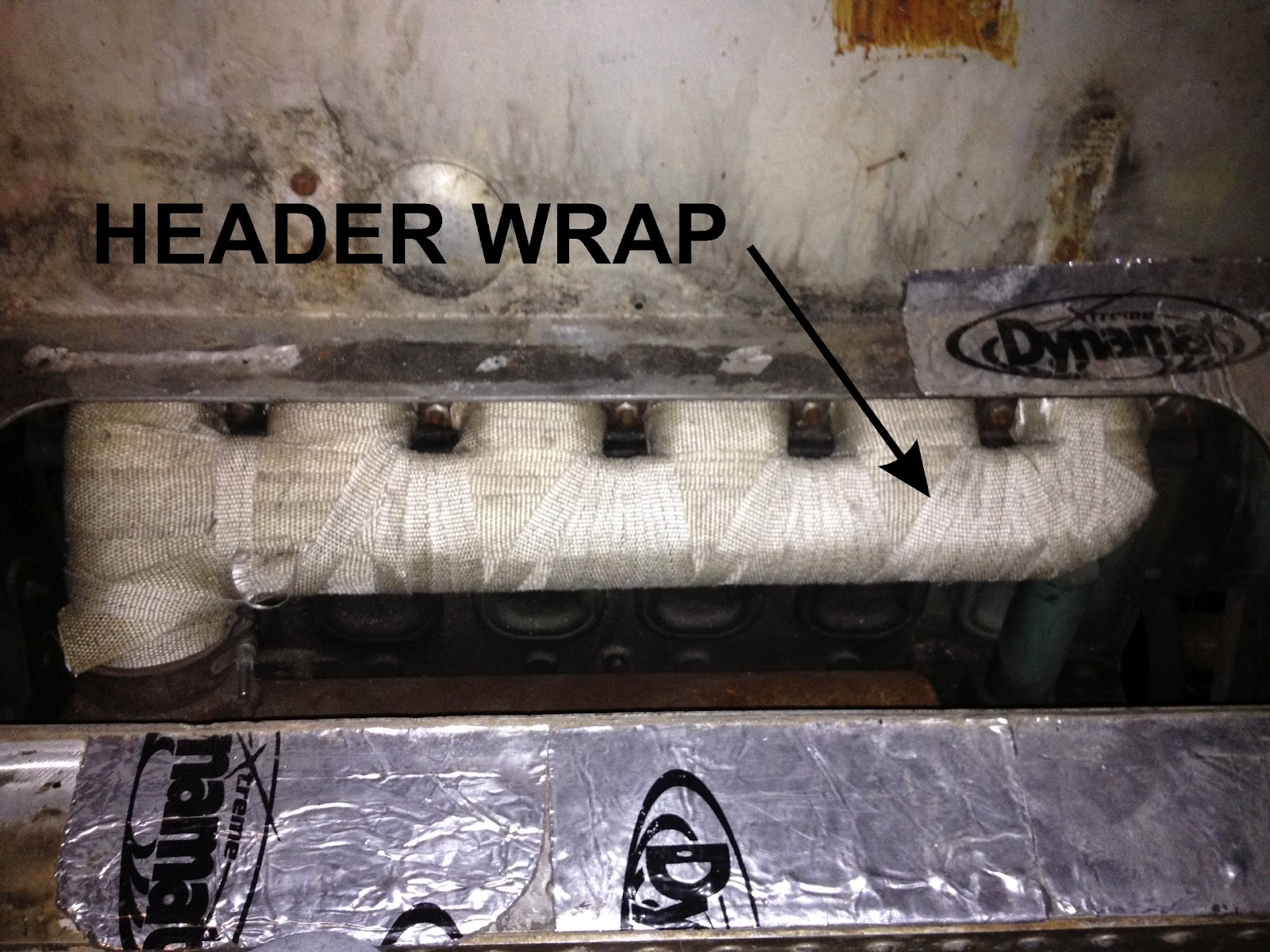

I wrapped my manifold with three layers of 2" and 1" width fiberglass composite for about $70.00, and took about an hour - most of that figuring out the best wrapping pattern.  Don't know how that compares with the other options.  I bought 1" glass blanket to wrap mufflers and insulate engine compartment above the manifold, but have not installed yet.

Bad idea to wrap a cast iron manifold on a 2 stroke with that type wrap fwiw Grodie

« Reply #8 on: October 16, 2012, 07:39:10 PM »
luvrbus,
What's the issue?  Too hot?  Too much expansion?  I don't want a cracked manifold.

I have the 6V92T DD. Should the cast manifolds be wrapped or just the turbo and exhaust pipe?  Why should you not wrap the cast manifolds with the tape as shown above?

Cast if allowed to cool and heat fast will become brittle and break I replaced several on DD that broke wrapped with tape,Thermo/Tec has a warning on the package about wrapping cast iron manifolds on their wrap packaging
