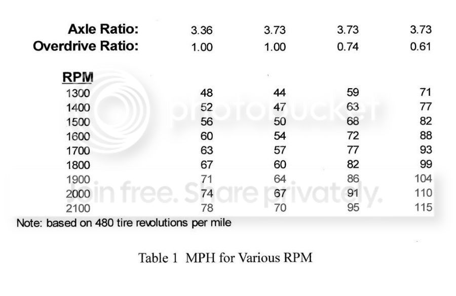

Depends on what speed you like to drive.  Lots of folks use the HT740 with a four stroke.  Not ideal but it works.  See chart below from my engine conversion article series in Bus Conversion Magazine.
The first two columns represent an HT 740 with the most common rear end ratios, while the last two columns represent the impact of world transmission overdrive ratios (or AutoShift with .74 overdrive).
The "ideal" cruise rpm for most four stroke engines is 1400-1500.
Jim

The ISM needs to be behind an over drive transmission.  You will get much better fuel mileage if you do.

3.33's with a direct drive trans preferably with a lock-up torque converter will cruise 64 mph@1700 with 11r24.5 tires. A 2 stroke might be happy there but for a 4 stroke to get good mileage it will want to see a cruise rpm range between 1350-1500 rpm if you are talking pre 1998 specs. More MPH means spending more fuel$$ no matter how it's geared.
If you upgrade your trans to an Allison World you will need an axle ratio of 3.90-4.10 depending on tire size. 4.10's will get you 66 mph@1375 with 24.5 rubber with the World .64 OD or 3.90's with 22.5's.
