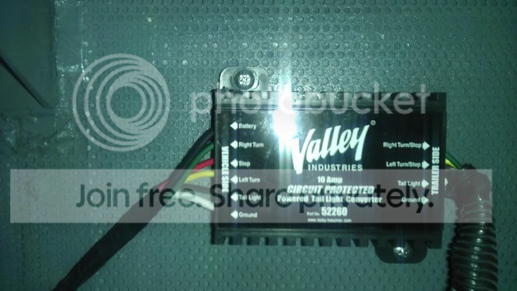

Have fun upstate, stay safe. I had done that on my Mci also, I used a three light to two light converter from walmart (works great).

Ed I went thru 3 if those from wal mart before I found the problem! They didn't carry enough voltage and each one burned up!
I got a good one from amazon that hasnt failed once!
I meant to say " couldnt carry the amperage, not voltage"!
If you look at the ones from wal mart they are rated at like 5 amps or maybe 7. About what a boat trailer or lawn trailer will put out but if you use a full size trailer with some lights, even led's you might want to step it up!

Glen all my exterior lights are 12v so No to answer your question!
If your bus has separate turn signals and whatever your pulling does not, then this device is a must have! Just make sure you get one that can carry the extra added lighting amps. Most of them are for open trailers such as a boat or utility trailer where they only have the two main rear lights (all in one). If you plan on tugging a full size cargo trailer with running lights all the way around or even a car, i would suggest one of the higher amp boxes!
Hasnt failed in two years where the ones from walmart lasted about a week or maybe A trip before I had smoke and no lights!

Thanx Ace
Looks like I will need to go with a converter then
