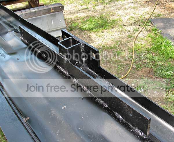

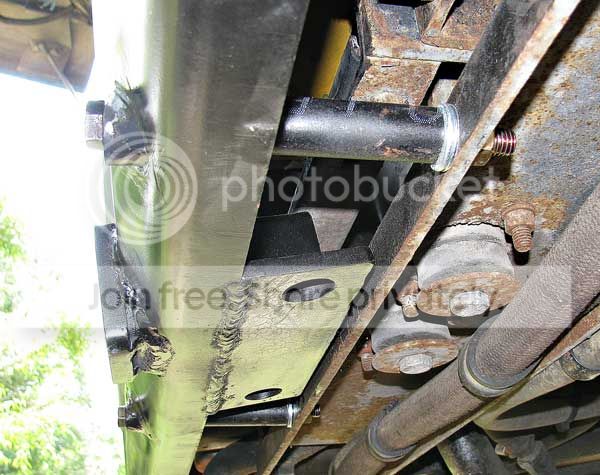

This is the bracing I put inside the bumper. Final version changed a little. I had to cut notches in the brace to clear air conditioning pulleys.
It still gave a little, so I tied it into the lower engine mount.  It doesn't give at all now.

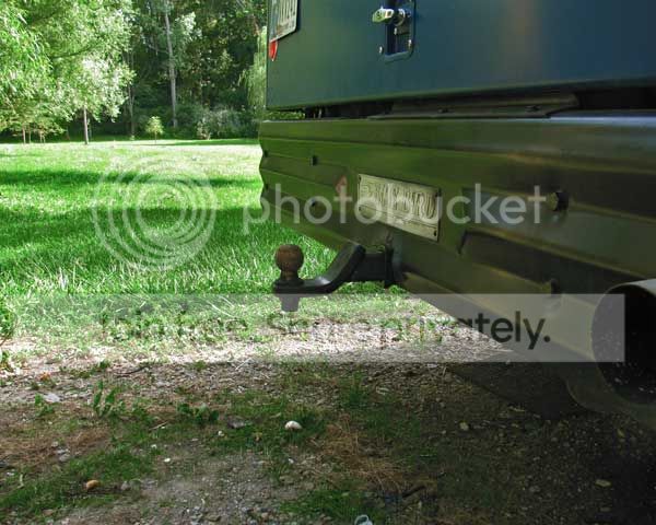

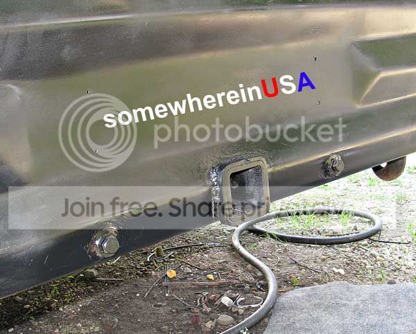

Here is view of everything installed.
Putting the pin in is a little tricky, but can be done from above or below. Not with the engine running though. :lol:

Well, I'd have to see that bumper in person, but from the photos, I'm not convinced it's strong enough to be pulling a car with.
Granted, I don't have enough data to make a proper judgement, like bumper metal thickness, size and grade of bolts holding it on or what they are screwed into.
Just my opinion.

FWIW it looks as strong as the bumper on my pickup truck, which is supposedly rated to 5,000 lbs.  The previous owner of my bus just bolted a receiver tube to the middle of the steel cross-brace behind the bumper of my MCI.  Flimsy as all heck, but he towed a jeep for 40K kilometers.  I put a real hitch on...
