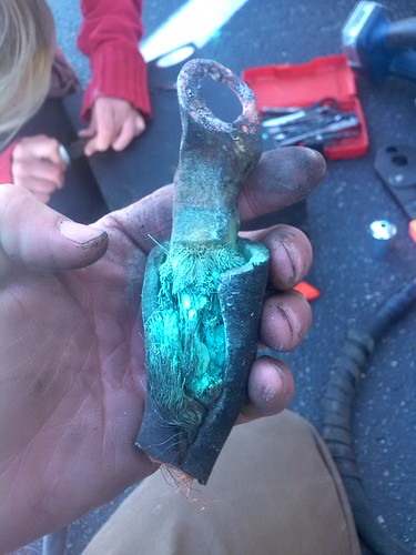

The water was actually covering the plates.  Batteries are charging and I am cleaning every connection I can find.  One was pretty rough looking on the battery.  Looks like the battery door was rubbing on it and welding the bolt to the terminal.

I was really confident after cleaning all the battery cables.  I found this one and just cut it off and put a new 4/0 lug on it.

Actually in the background is my 8 year old daughter.  She was scrubbing the ends to get those copper terminals shining.  Kids and wife are all taking it real well.  It could be worse.  Like if we were on the side of the expressway.
