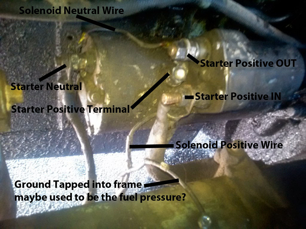

I applied 24v by hanging a wire off the solenoid large positive IN and touching it to the small solenoid positive and it sparks but no sound or action from the solenoid.
I am suspicious of the wire that was clamped to the frame that I recently tapped into the frame.  I am going to take a picture of my setup and label it all to make sure I am not confused.  The manual does not spell out which terminals are which very well but I can follow the ones that lead to ground and am assuming the opposite posts are hot.
I will upload a pic.

Is my understanding correct on this thing?

Ok it looks normal the neutrals are ground the wire you call solenoid positive where is it connected if on the bottom of the solenoid to one of the small terminals it is wired right  check the ground with a test light on the starter connect the lead to the cable of the neutral as you call it touch the point to positive( in) if it lights the ground is good when using a meter or light on the starter always ground on the starter that will tell you if the ground is good on the starter

Cliff - I will get in there tomorrow morning and check that out.  I dont have a test light but I have a multimeter and assume I am looking for acceptable voltage (23 - 25v) between the hot and ground on the starter motor with the starter switch turned on.
One thing supporting a ground problem - While I was first "poking" around with the multimeter I recall testing the ground on the starter to the ground I tapped on the chassis and getting 24v.  At the time I thought the starter motor terminal on the back was hot and it got its ground from being bolted to the engine.  So I will test that after performing the test you mention above.  I could also be remembering wrong (it happens).  Hopefully the cause of this issue presents itself tomorrow.  I am ready to get behind the wheel again.

This morning while putting the relay panel back on I discovered a heavy duty wire from the alternator that came off.  It was the Battery side connection and it was touching the frame.  So I put that back on the alternator.
I then tested voltage as Cliff asked (I don't have a 24v light) and get 0v while pushing the start switch across the starter terminals.  I do get 24v at the solenoid but no sound / no action.
I tested the ground on starter to chassis ground and get 0v .
I jumped the starter to apply voltage directly to the starter motor and get no sound or anything.
I am pulling the starter off and taking it to grand battery after I pickup the appropriate 12point socket.
1972 MCI7 8v71 converted - 1kw solar on roof

I removed the starter (quite easy) and took it to grand battery.  They tested it and it is bad.  Both the solenoid and starter.  I watched and the solenoid did slowly push the pinion forward and it spun really slow and stopped then wouldn't spin again when he tried again.  Voltage to starter direct didn't spin the starter either.
