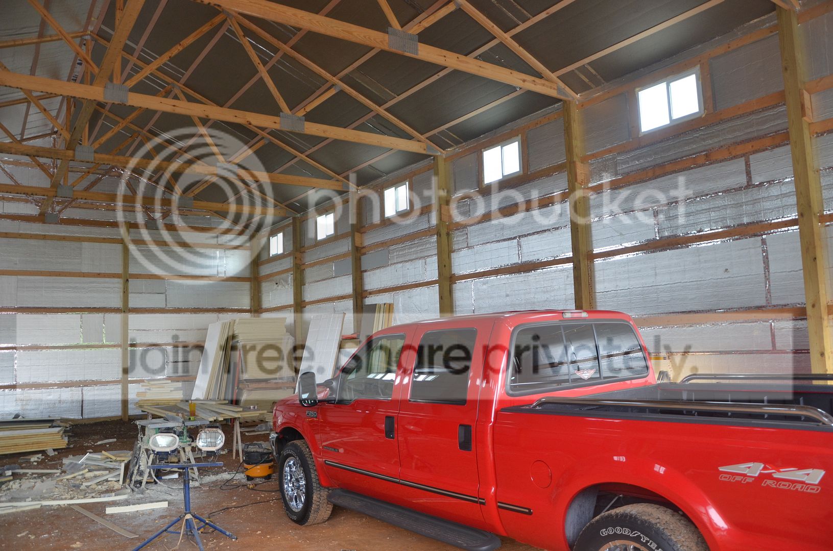

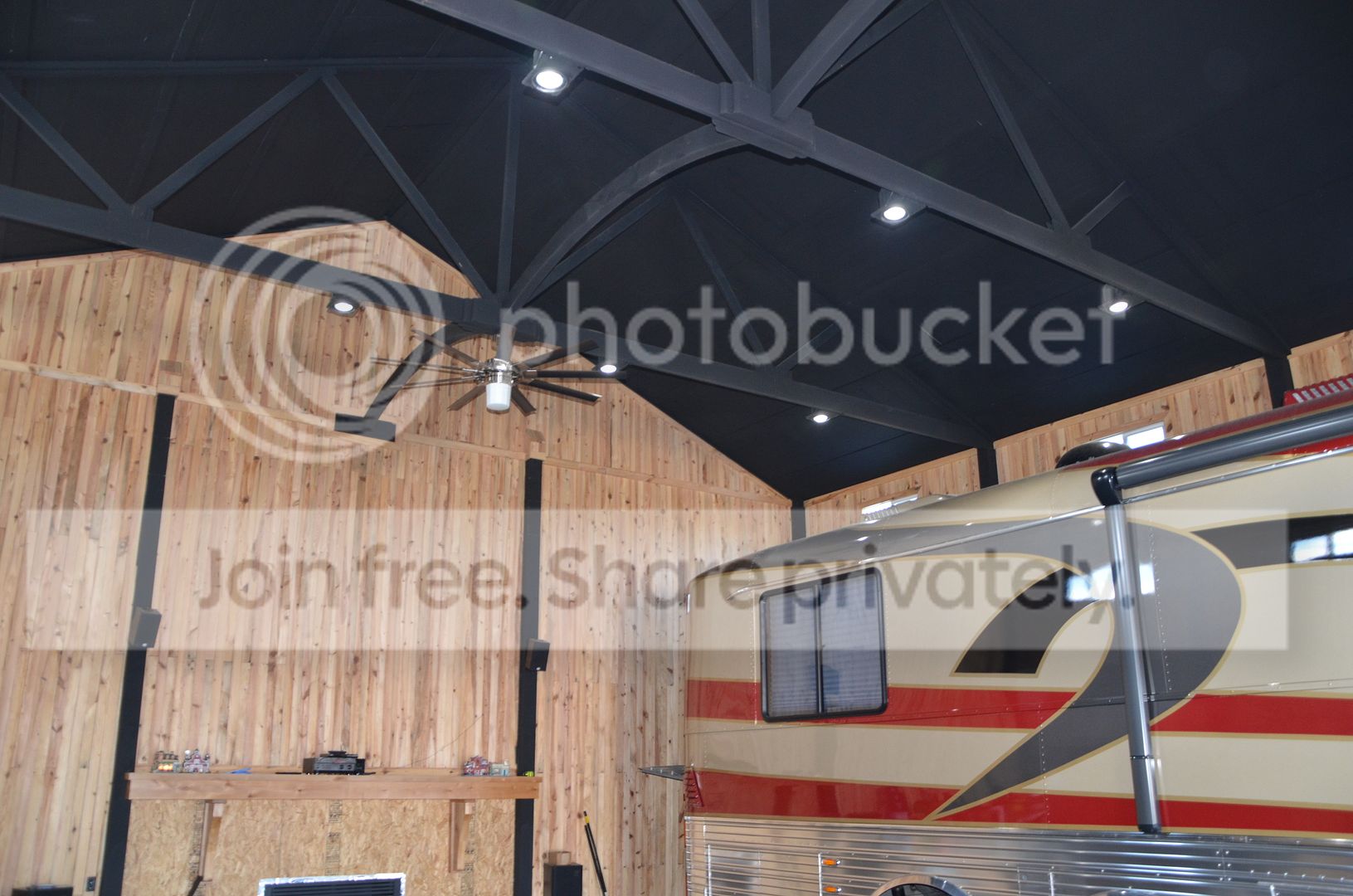

My shop is a metal building with 16' sidewalls. I built the bus barn out of wood. In 1997 metal was about 30% less than wood. Today it is the opposite. Metal buildings are engineered by region for snow/wind loads. There are wood post companies that do the same. One is Hoover. I built the barn similar to such. I went 40' x 60'. Everyone is right about the 50'. You don't reall have a lot of room around a 40' coach at 30 x 50. The cost is not much more until you go over 40'. I have 16'-4" from the bottom of the truss to floor level. The doors are barrel doors with a 14' ht. I had to buy 22' 6 x6's. They are the big ticket item. A 16' was app. $ 35.00, but the 22'  were $95.00 We needed to put the post at least 5' in the ground due to bld ht. The trusses are spaced @ 20' on my metal building, and 10' on the barn.

I am actually having a local builder quote doing it stick built and I am looking into the metal building route to see which is less expensive.  We also have something out here called a pole barn which is pretty much what Eric posted the pictures of so that may also be a better option. You really have me thinking about the 60' size now.  The 2 post car lift will be beside the bus so access to it would be difficult with the bus inside if I only go 50'.
