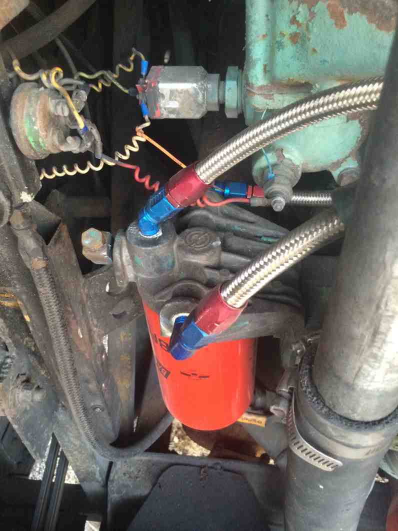

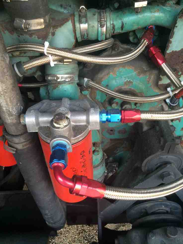

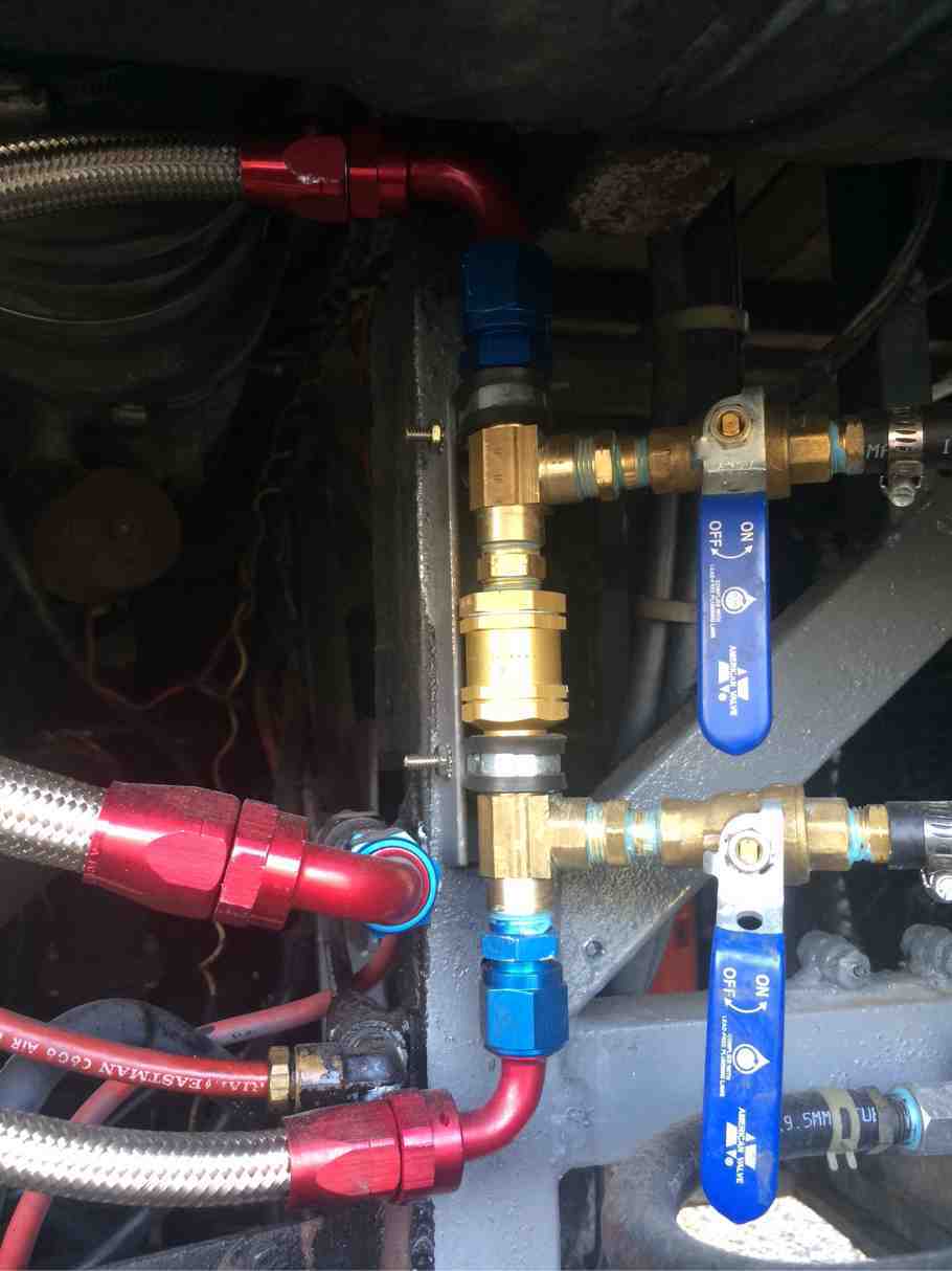

Last summer I removed the high idle solenoid and put in a Jake buffer switch (the old Jake switch never worked right and just sensed the throttle position). Changed the oil, oil filter, air filter, and fuel filters. I replaced all of the fuel lines from just before the primary filter all the way through to the heads and added a priming pump. In the photo the line from the tank goes to an AN fitting AN-10 hose and loops around to the top of a (3/8?) brass tee. That connects down to a Detroit check valve, another tee, and the out another AN fitting and AN-8 hose to the inlet of the primary fuel filter. The tees connect to an Airtex E8153 pump for priming. That pump is a 10-14psi pump, and met the specs of what I could find as being ok to use and not damage the engine fuel pump. The primary filter connects to the inlet of the engine pump with AN-8 hose and fittings. Out of the engine pump, to the secondary filter, and to the engine are all AN-6 fittings and hose.

I don't have a pressure gauge to test the output of the fuel pump and see if that is working ok. The vibration/shuddering makes me think of fuel starvation. The AN fuel lines should be sufficient for the pressure and volume needed, and I would hope the brass tees and check valve aren't too much of a restriction to cause a problem.

First, I may be wrong, but I was under the impression that the check valve was supposed to be mounted horizontally, with the writing up.
Second, 1/2 inch of water in the filter seems excessive. I think I'd address that first and get the water out of the tank and change the filters.
