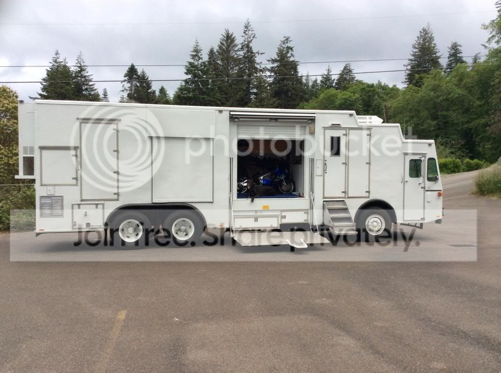

June 07, 2014, 09:59:22 PM »
Here is the vehicle we are talking about.
I will have a lot of interesting stuff to share about it in return for everyone's gracious help.
I call this photo "Top Speed"

Sean, Some of our buses came with a damper valve plumbed in the air intake for shutting down a runaway engine. It could be partially closed or getting sucked closed under heavy throttle. Again, it is worth checking as many possible external problem sources before diving into the internals of the engine. Like the others have said, a hole in the intake or exhaust can create as much of a problem as a blockage. When you have eliminated everything simple and cheap, it will be time to hire a set of experienced hands for checking compression, injector adjustment, and power balance. An oil sample test can give you clues about the condition of the engine before opening it up. One word of caution, stay out of the governor box. Messing with the governor will cause more harm than good.
By the way, your RV conversion looks like it is ready for battle. I am jelly
