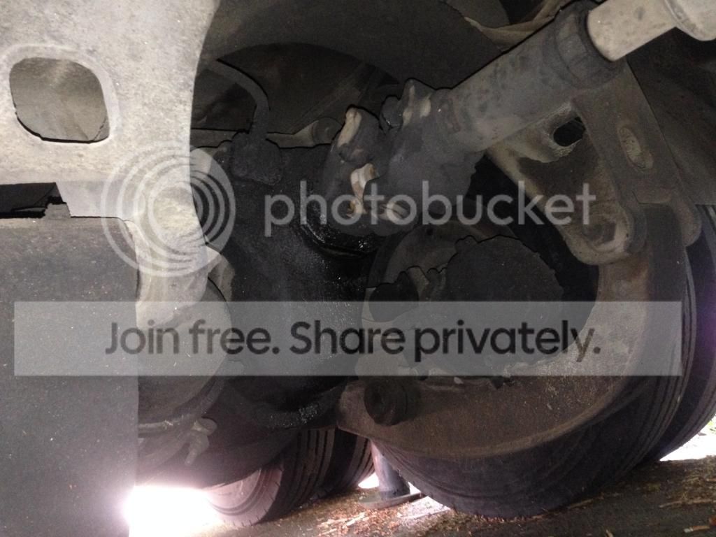

This is a shot of the suspension...as well as I can get my phone to take it....

you know what, you might post pictures of your dash controls...looks like some kind of axle inter lock....need more info. you might be driving 2 axles in places you only need one...

That's Neway air suspension. Usually rated at 46,000lbs for the tandem. Great suspension in that it has an upper trailing link that prevents torque up of the axle. The only draw back is the arms are low to the ground and getting hung up on a curb is not out of the question.

« Reply #71 on: June 10, 2014, 07:20:06 PM »
Yes... does have.  The switch seems to work (Light when you turn it on... PShhhhh...when you turn it off).   I keep it off course, but if it were possible that it weren't releasing... that's one to keep in mind.
Your idea of making a stand up engine maybe the best. There was a mid engined motorhome chassis for using on garage motorhomes. It used a Cummins ISL at 450hp and 1250lb/ft torque. And actually, it didn't stick into the cab. The interior reminded me of a boat since there was a hatch in the floor for top of engine access. Good Luck,TomC
That's good to know TomC.  It does hang low, but then again, so does the motor.  Probably take out the oil pan first.
well that is being used properly:
http://www2.dana.com/pdf/AXDR-0130.pdf
