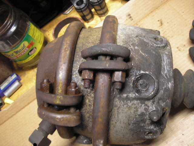

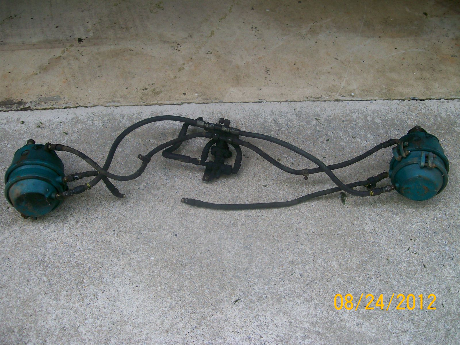

Offline eagle19952
  • Posts: 3891
Re: Parking Brake Problem
« Reply #14 on: June 11, 2014, 08:51:27 AM »
There are grease zerks on the DD3's I also doubt a relay problem
They are located here: tho covered with crap, you can see them, that are also left and right and there is an upside down that needs to be down to drain water and road krap.
On the left DD#:
