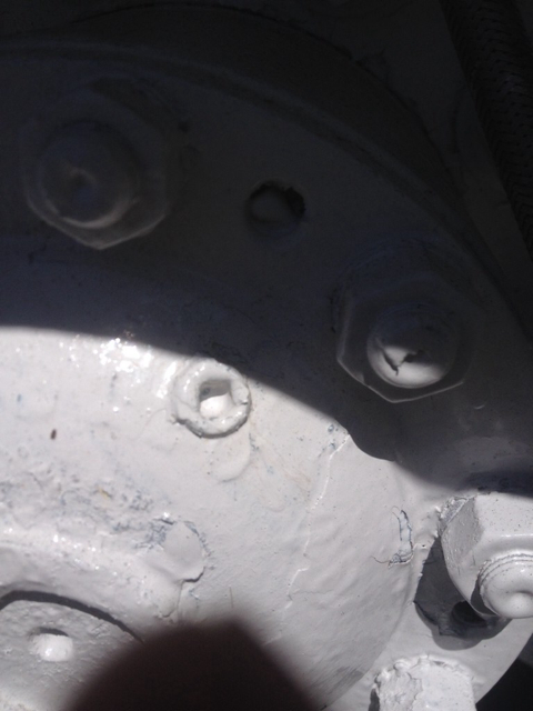

Scott, yes the drive hubs recieve oil from the differential.  The plug is to fill the hubs when they are installed dry after a bearing change, etc.  They will automatically fill to the correct oil level as long as the diff has the correct oil level, which is fill right to the fill plug on the diff housing.

Offline brmax
  • Posts: 603
Re: Convert oil filled hubs to grease
« Reply #8 on: June 29, 2014, 09:59:47 AM »
I believe you have it covered, And that particular style rear housing is using in the same oil supply I agree.
That drain and fill plug on the axle picture can be very handy in draining before removal "less mess" its a pain cleaning wheels. Using them to fill would be a study out of my league,  my experience says that plug option was on the luxury list so having it in correct position to fill is probably in a book, and after this I will try and look a bit.
I am more interested in helping find the color or problem with gear oil, what may be air bubbles from expansion or exactly im curious to help fix that. The tubes or axle vents are high and a buss in water that hi I want to see pics. Sorry! Im around rivers and some unfortunate times floods, and with an Army past with river operations as a mos  lots of vehicles unloading in water was the task just here to help.

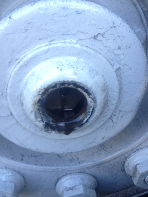

Interesting. As for the overfill, mine bled out some fluid when I first drained and refilled after replacing the covers. Eventually they level out and it doesn't leak a drop. Again, I just need to repeat the drain and fill procedure in the tags cause the oil isn't staying clear.
It's getting milky almost as if a small amount of water is getting in there. Might be time for some new plugs. I agree on the paint over the caps. I have to pull the plug to see the level. Annoying. Thank you so much. You guys are forever helpful.

Offline bevans6
  • Posts: 6008
  • 1980 MCI MC-5C
« Reply #10 on: June 29, 2014, 10:52:56 AM »
