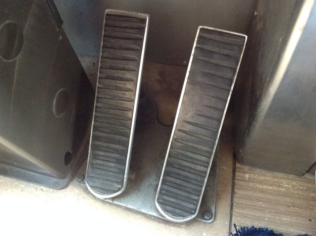

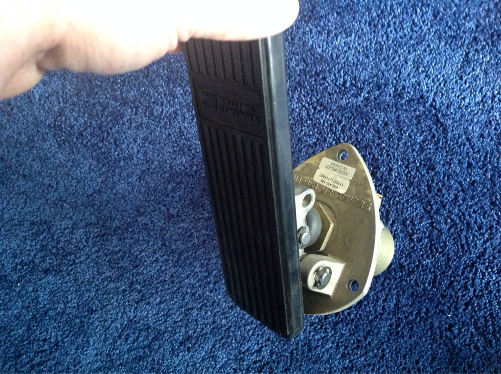

I should probably keep a series going about the installation process.  But, I'll continue to have lots of questions along the way.  I know some of you have already done this, so any help would be appreciated.
Below are a couple pictures.  How do I install the pedal?  Do I cut the MCI floor plate in two?  Or, do I keep the plate and just cut a big hole in it and set the new pedal on top?

    IME, it varies.  I put mine in and it was *just fine* with the stock driver's seat.  I put in a (much more comfortable) replacement seat and found that the angle was wrong.  I moved the floor unit a little (mine was "all the parts above the floor" so it was easy) and that fixed it.  But basically it seems mock it up and sit in the seat and try it.

Keep the floor plate and modify as required.  The Williams pedal comes in two different angles, you might find the 45 degree more comfortable.

With that pedal you can rotate it to the most comfy position for your style driving just get it right the 1st time
