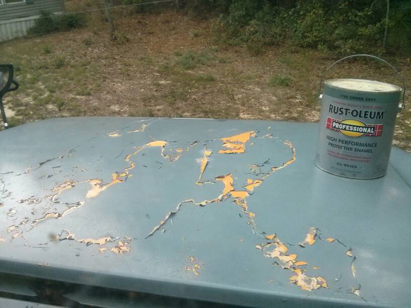

Lol. I'm watching my bus as the paint slowly peels. Each day brings worse peeling. I notice its mainly where the sun hits the paint.
Is there any paint at tractor supply that's any good? I know to avoid Rustoleum now.

Just as an aside, most of the peeling of original finishes is related to the factory use (no choice) of water borne primer. WBP has to be baked shortly after spraying to drive off the water in order to eliminate rust.  The problem is that the color coat can't penetrate and bond to the super hard baked primer and soon fails.  Subsequent paint jobs fail unless all the color coat of the original paint job are removed and the primer well sanded. Curiously enough, once the baked primer is sanded, subsequent coats of paint adhere just fine.  Go figger.  Jack
Sent from my Nexus 7
Just wait a bit longer, then you won't need to strip off any paint yourself  -  it will have auto-stripped.   The same was happening with my roof paint  -  it was coming off in big pieces, so my fellow Crownaholics suggested I leave it for a few years until it had all gone.   Some of it actually blew off when driving!   I ended up hand-scraping it off with a small putty knife and a hot air gun to get down to bare metal, all 400 sq.ft. of it.   No fun.   I hate to say so, but it sounds like this is also in your future.   Once you have bare metal, you can then recaulk every seam, sand to clean shiny metal, degrease, etch, prime, sand smooth, and only then can you apply the paint.   Quite simply, you can't take shortcuts  -  there's no easy way to do it right.

I can see why nobody repainted the bus before. I'm getting some big flakes.
And that despite washing then scuffing the yellow paint!

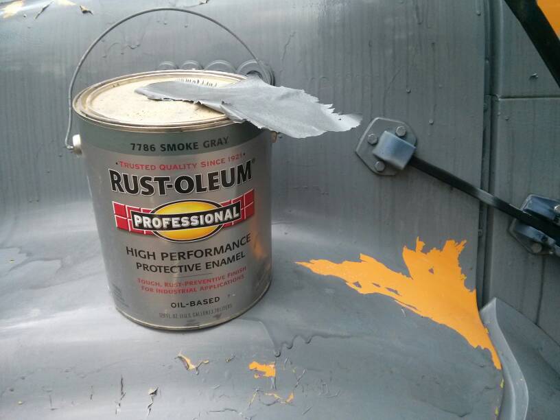

I suspect that the batch may have been bad given Rustoleum stating....
Thank you for providing the batch code a refund has been processed and you will receive a check within one to two weeks.
I reported the problem and supplied these photos and they asked the batch number then said they were sending a check.
Carpenter 3800 1994 on a Navistar 1994 chassis with a DT466 and alinson transmission.

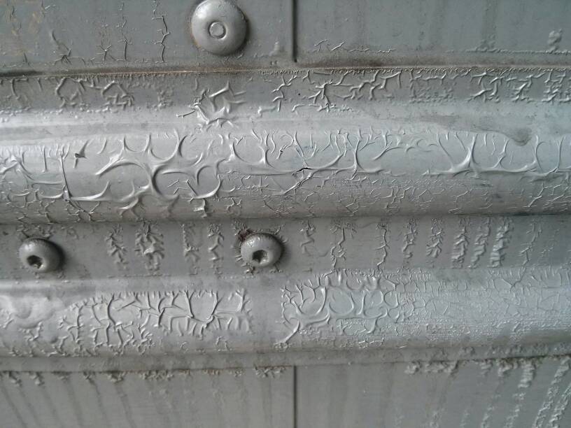

Not necessarily an admission of a bad batch - Just providing good customer service.
Keeping track of batch numbers associated with customer complaints is an easy way to identify where problems are & where improvements can be made.
Prep work for a quality paint job usually takes more time, effort & money than applying the top coat.
Based on what I see, the problem wasn't a bad batch of Rustoleum, BUT instead was more of an incompatibility issue of the top coat & what you were painting over.
I'm guessing we'd be seeing the same results regardless of the paint you had used - an expected result of incomplete preparation.

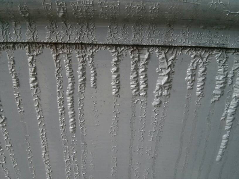

Absolutely, that photo of the wrinkling runs is showing a solvent reaction, clear as day. Not the fault of either paint, just two paints brought together when they shouldn't have been.
Odd thing is though - there isn't any reaction evident in the photo where the paint can is sitting on the fender - must admit when I  saw that one my first thought was whether school buses were painted with anti-graffiti paint.
