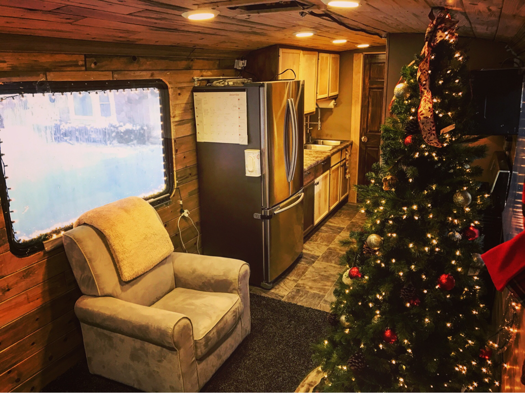

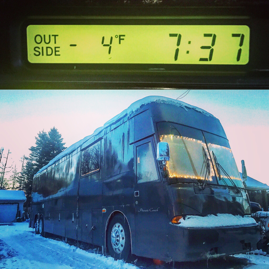

Yep, it was crisp this morning. I kinda like it. The air is clean. It's quiet. The birds are too frozen to chirp. The snow squeaks under your feet. This will be a nice Christmas. And it's around 75°F inside.

Nice contrast between the exterior & interior photos at the beginning of this post. Yes it should be cold, icy, & snow on Christmas - so enjoy & have a great safe Holiday. JimmyHeet makes a real nice block heater, we have the 2000 watt unit. Thanks again for the photos & Merry Christmas to you & yours...
