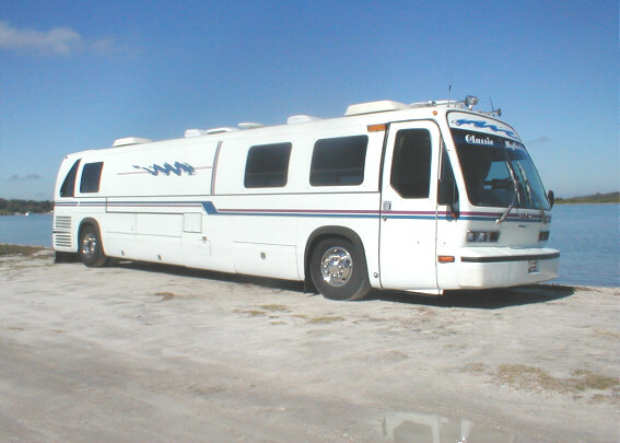

Don't Underestimate the RTS - Mostly Stainless Steel Unibody construction - comes in 35' or 40 ' and 96' or 102" wide bodies. Mines powered by a 6V92TA / V731 w/4.10 gears
My 35' 102" wide '89 RTS has - 140 gallons diesel - 95 gallons waste - 92 gallons fresh - a 7kw Generator - washer/dryer - walk-thru bath with neoangle shower - huge closets (the bedroom closet (over the engine) is 6' wide 20' deep and 4' high). the hall closet is 5' wide 24" deep and floor to ceiling - by the way, my finished ceiling height (with twin 15K BTU Dometics a/c units - fully ducted) is 78" - (and that's with an average of (2 3/4") of insulation in the ceiling
Plus an approx 8' x 5' x 20" storage bay (1 in the 35 footer - 2 in the 40 footer)
Drove it 2000 miles home from California with the original 5.13 rear and got 7 MPG - I expect close to 9/10 with my 4.10 - IT drives like a "baby carriage" top speed = 78 MPH - cruises at 72
MORE LIKE THE      **** DELORIAN OF BUSES****
