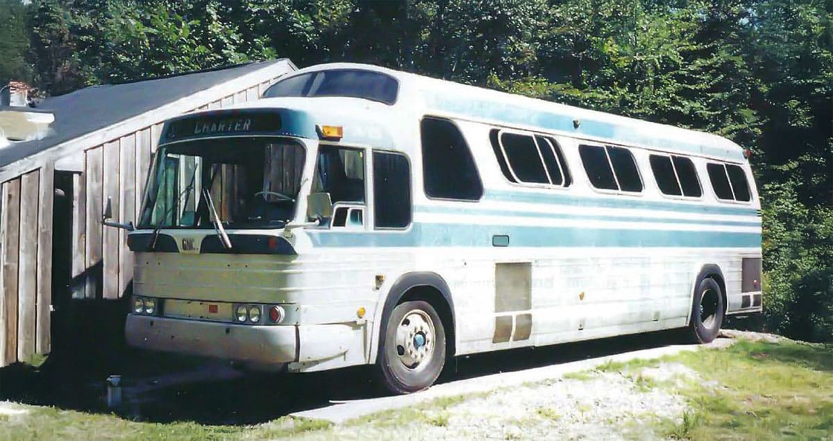

In 1993, we had our first close encounter with a converted bus while camping in our commercial RV in Charleston, South Carolina. We couldn’t stop admiring the handsome conversion parked near us. The owners, Bob and Carol Norwood, graciously invited us in for a look and patiently answered all our questions. They succeeded in convincing us that traveling by bus was the only way to go.
Bob had converted their bus and, after an evening of conversation, Roger determined that he, too, had the skills to do a conversion. He had a lifelong interest in and experience with auto mechanics, taught high school shop for 30 years, and possessed skills in autobody, woodworking, electrical, and plumbing.
We began paying attention to converted buses on the road and attended several rallies to become familiar with conversion options. We loved the feel of a “vista window” from the inside of a coach. We also determined that a 35‑foot bus would allow us to reach places a larger coach could not, yet still be long enough for our needs.
We heard that the GM bus—even when tired—is so reliable that one can always get home with only a screwdriver and a pair of pliers. With these prerequisites in mind, our search for the perfect candidate began. It ended at Housman Bus Sales in New Jersey, where we were able to pick from a fleet they had purchased from James River Bus Lines of Richmond, Virginia. We chose a 1970 GM 4108 (bus No. 10) that had 769,000 miles logged and had been purchased new by James River. We figured all we needed then was three years and $30,000 to do the conversion—ha!
It was Roger’s job to drive our new purchase from New Jersey to our home in Connecticut. He was getting used to shifting a standard transmission with a wet clutch on the New Jersey Turnpike. Just before a toll booth, the engine stopped. He coasted to the side of the road. He hit the restart button. It fired up immediately but stopped when the button was released. Several attempts produced the same result. The state trooper who pulled in behind said the vehicle had to be moved from the highway, so a wrecker was called.
The wrecker driver recognized it as a private coach and thoughtfully suggested he try to find the problem, since it would cost $450 just to hook up. Good idea! He immediately spotted that the air‑fuel shutdown solenoid had failed; however, there was nothing he could do to fix it on the spot. Roger asked if he might borrow an Allen wrench to loosen the bolt and pivot the valve, preventing it from shutting the fuel rack down. Success! The only problem now was that the motor could not be shut off without opening the engine compartment and doing a manual shutdown. No big problem.
At least, it wasn’t a problem until we hit first gear in heavy stop‑and‑go traffic on the George Washington Bridge. A large bang sounded from the rear, and the bus wouldn’t move. The shifter felt like limp spaghetti, and only third and fourth gears remained. Getting the large vehicle moving from a dead stop using only third and fourth gear was an interesting experience in the middle of rush hour on the George Washington Bridge. Although there were many other stop‑and‑go situations along the way, Roger was able to nurse the bus the remaining eighty miles home.

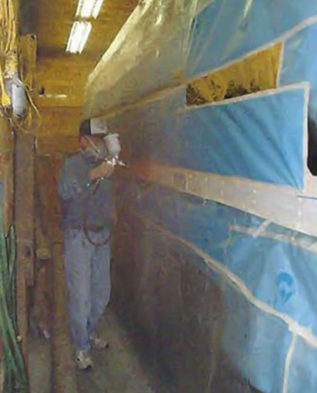

One‑eighth‑inch sill insulation was glued directly to the exposed skin. Then, a one‑inch ridged foam board with a 7.5 R‑value was cut to fit between the ribs. It was scored, bent, and filled with spray foam where curved pieces were needed for the roof radius. All rib channels were filled with two‑part expanding spray foam. All seams were covered with aluminum tape.
The Titus' bus before their conversion
The Titus' bus before their conversion.

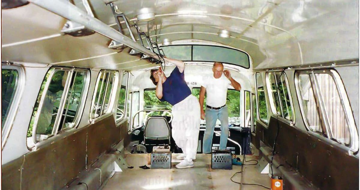

Faye and Roger hard at work removing the racks
Faye and Roger hard at work removing the overhead racks.

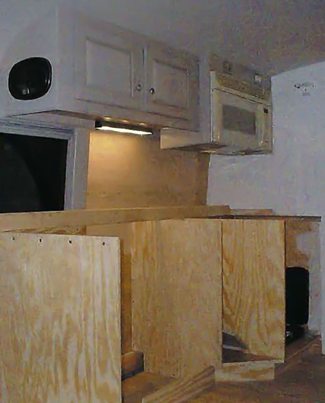

Kitchen overheads completed and the base cabinet frame in place
Kitchen overheads completed and the base cabinet frame in place.

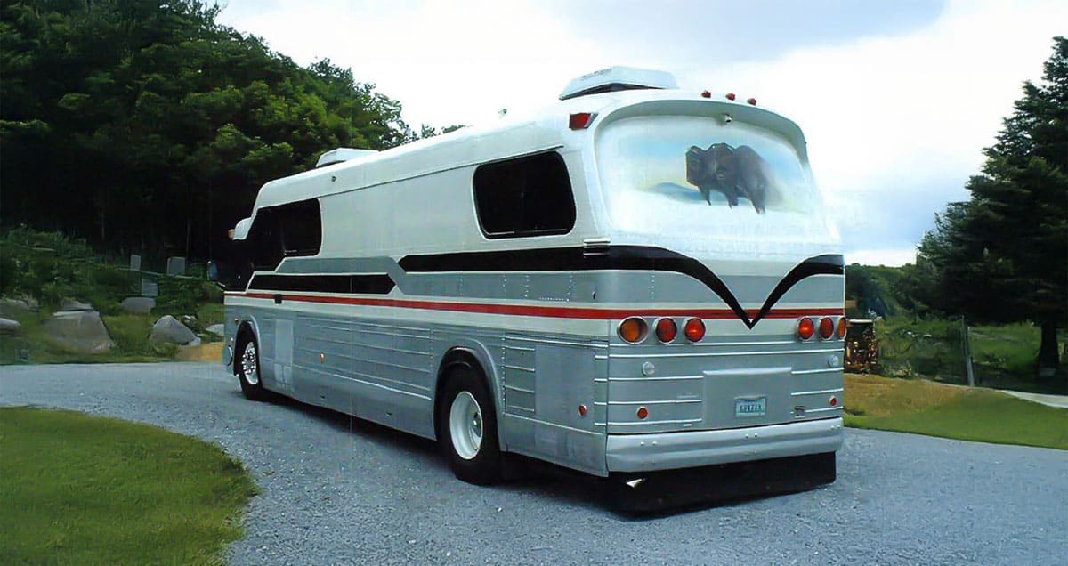

Now that the mechanical work was complete, it was time to focus on the exterior of the bus. The first order of business was to sandblast the entire outer surface of the bus. The two center windows on each side of the coach were removed and replaced with panels fabricated from 16-gauge steel and buck-riveted into position, following the original rivet placement. Our good friend Bob Judd spent many hours in a headset helping Roger with the noisy buck riveting.
We wanted to keep the original profile of the bus but needed to address the leaks and rust around the rear window. We decided to remove the window and replace it with a panel on which a mural could be painted. Roger fabricated a piece of 18-gauge steel to fit the opening and MIG-welded it around the perimeter. The welds were ground to shape using a grinding wheel contoured to create a smooth blend between the panel and the reveal.

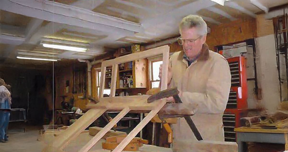

Roger constructing angled sections of the kitchen base cabinets.

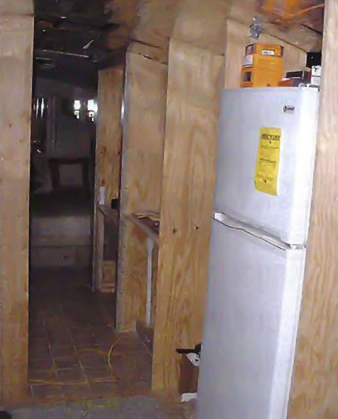

A shot of segments on the right side of the coach. These would be designated for the house refrigerator, pantry vanily, wardrobe and the completed bedroom in the back.

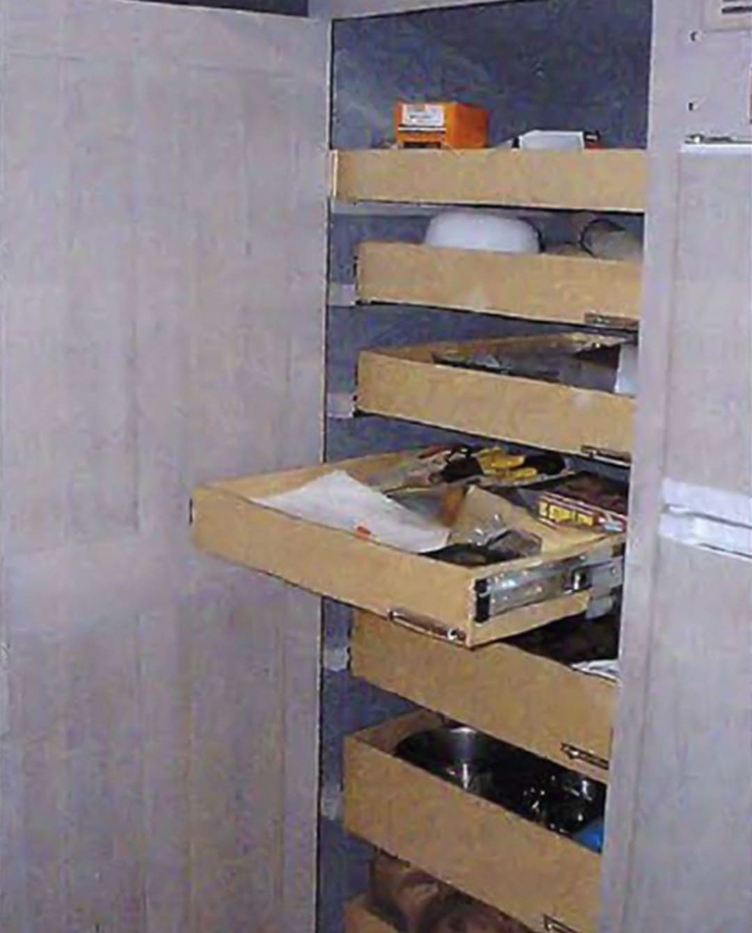

The carpeted pantry with pull-out drawers installed
A shot of segments on the street side of the coach. These would be designated for the house refrigerator, pantry vanity, wardrobe, and the completed bedroom in the back.
After all the dented panels were replaced or straightened, the bus was sanded and primed. Then it was time to paint. Roger’s connection at T&J Autobody in East Hartford, Connecticut, arranged for the weekend rental of a large, modern, downdraft paint booth with baking capabilities. With the help of two professional painters, Roger applied a three‑stage basecoat/clear‑coat pearl paint from the roof to the top of the luggage bays. Every window in the bus was replaced, including sliding Peninsula side windows. A local artist applied an airbrushed and hand‑painted oil mural of a buffalo couple to the back panel. The silver luggage bays, nose, and deck lid—plus the graphics—were painted in our home garage at a later date.

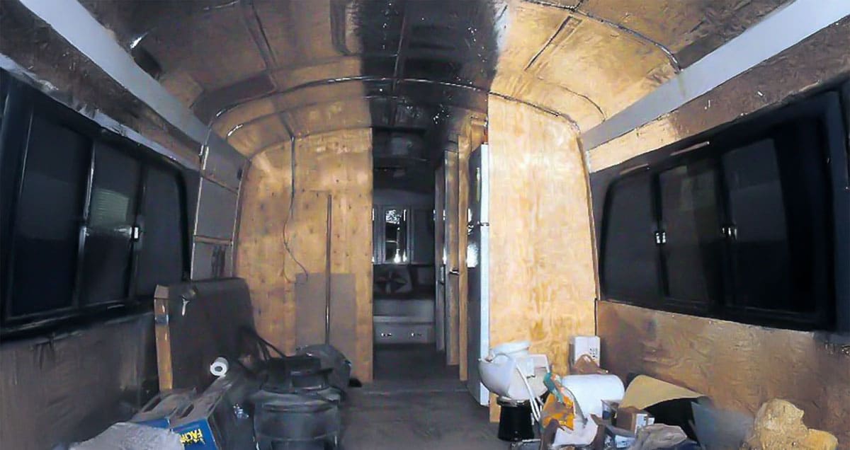

Once plywood was applied to the walls and floor, we were ready to complete the interior. After many hours of contemplation, numerous erasures on our graph paper plan, and several discussions while standing in the empty coach, we arrived at what felt like a workable and comfortable floor plan. We decided to start building at the back of the coach and move forward, completing each section as we went along.
Using red oak that had been knocked down on our Connecticut property by Hurricane Gloria in 1985, Roger built raised panel cabinets along the upper sidewalls of the bedroom. Scribing the cabinets to the irregular curves of the bus walls was a special challenge. We decided to install the queen-bed platform side by side, saving us 18 inches of floor space from front to rear, a very valuable commodity in a 35-foot coach. Shallow, shelved cabinets with mirrored panels were built along the rear of the room. An additional tall closet was added to the front corner of the bedroom, and a headboard with storage linked it to the rear cabinets.

All room‑dividing walls were constructed of three‑quarter‑inch plywood and fastened to the rib structure of the roof, as well as glued to the outside walls. Our bathroom plan included a neo‑angle shower to be installed in a corner. Shower plumbing would be run within the cavity created between the outer coach wall and the new shower wall. The Conestoga‑wagon curve of the 4108 limited the height, so the showerhead could not be placed high enough to accommodate comfortable showering. It was apparent that dropping the shower floor would be easier than shortening our bodies.

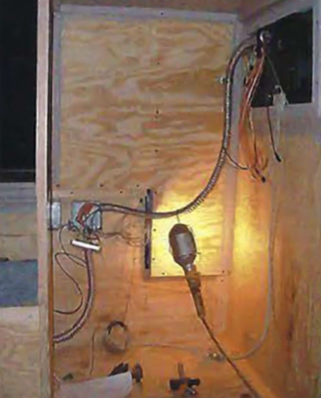

Beginning wiring inside the media cabinet

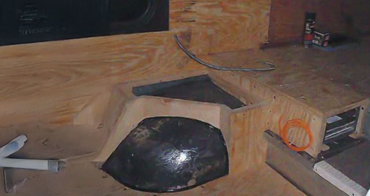

Framing over the passenger wheel well and the second floor extension to house one of the Webasto ice-kick heaters.
Beginning wiring inside the media cabinet.

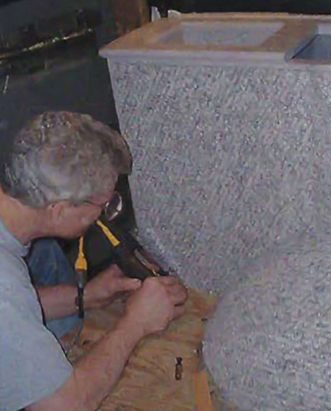

The carpet is glued and stapled to the passenger side cabinet and wheel well.

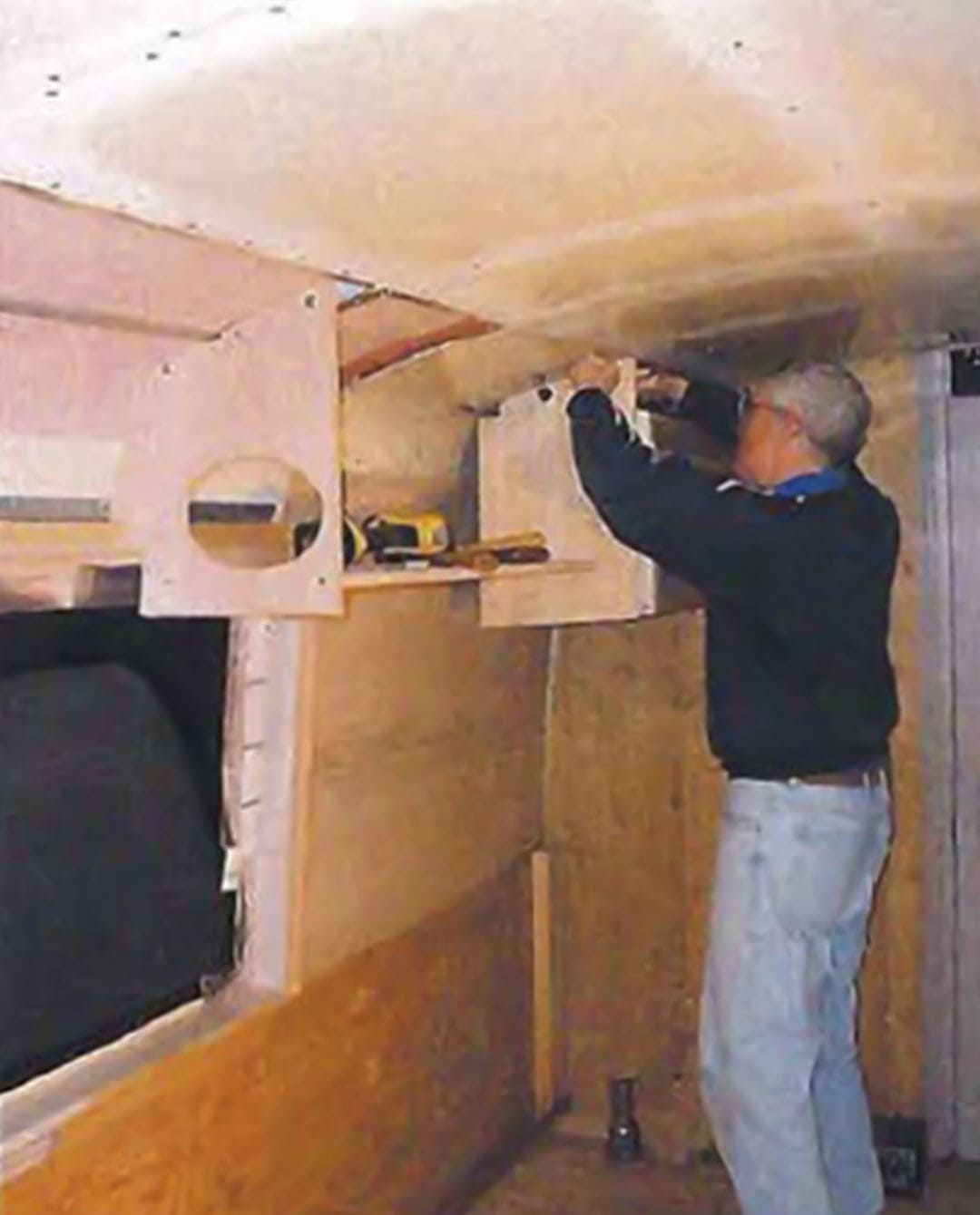

The beginning of the kitchen overhead cabinets. Note the cutout for the stereo speaker.

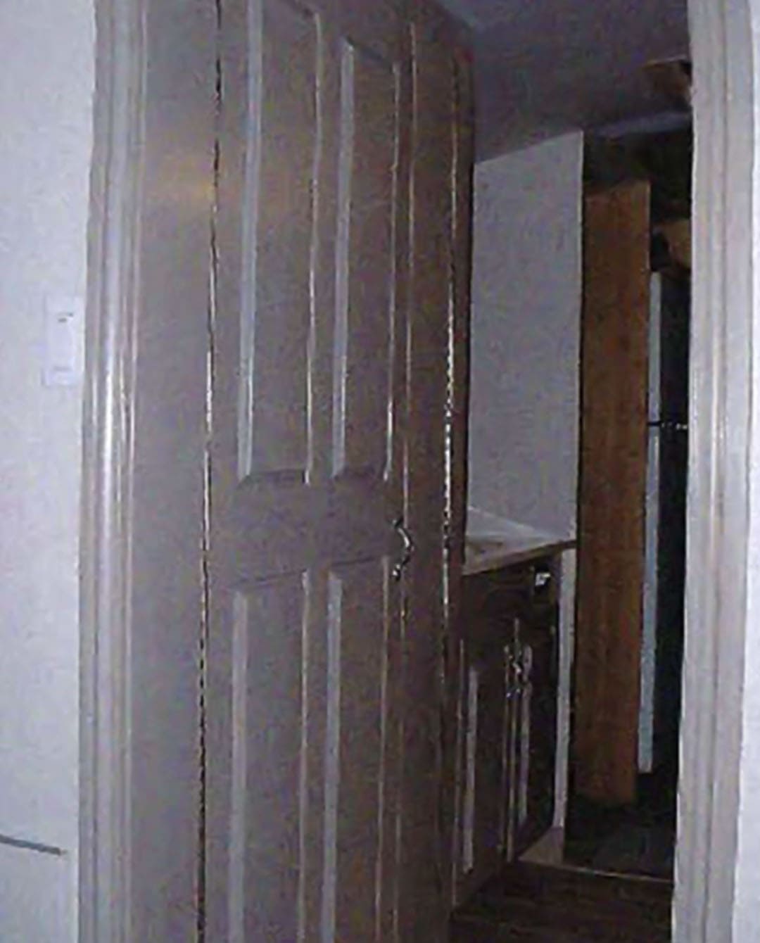

Back in the bathroom, the wardrobe and vanity areas were constructed. The full-length, three-quarter-inch oak raised panel wardrobe door features a shirt-hanging area and two deep drawers on full-extension guides rated for 150 pounds. A spring‑ball, loaded atrium‑door latch was installed to allow the door to either cover the wardrobe or close off the bedroom from the bathroom. In the kitchen, a matching door was built for the pantry, which can be used to close off the bathroom from the kitchen when desired.
We wanted lots of storage. Installing a floor-to-ceiling pantry with six 22-inch pantry drawers on 150-pound-rated, full-extension guides helped fill that need. The same style of oak cabinets completed the kitchen. Full-extension drawers and an oak-veneered refrigerator were also installed. The highlight of the kitchen is the mirrored backsplash, in which I etched a scene of wandering buffalo. Similar to the buffalo, they wander the neo-angle bathroom shower enclosure.

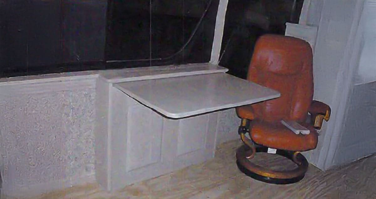

A shallow raised panel cabinet was built under a living‑area window to hide the oak pullout table when it was tucked away.

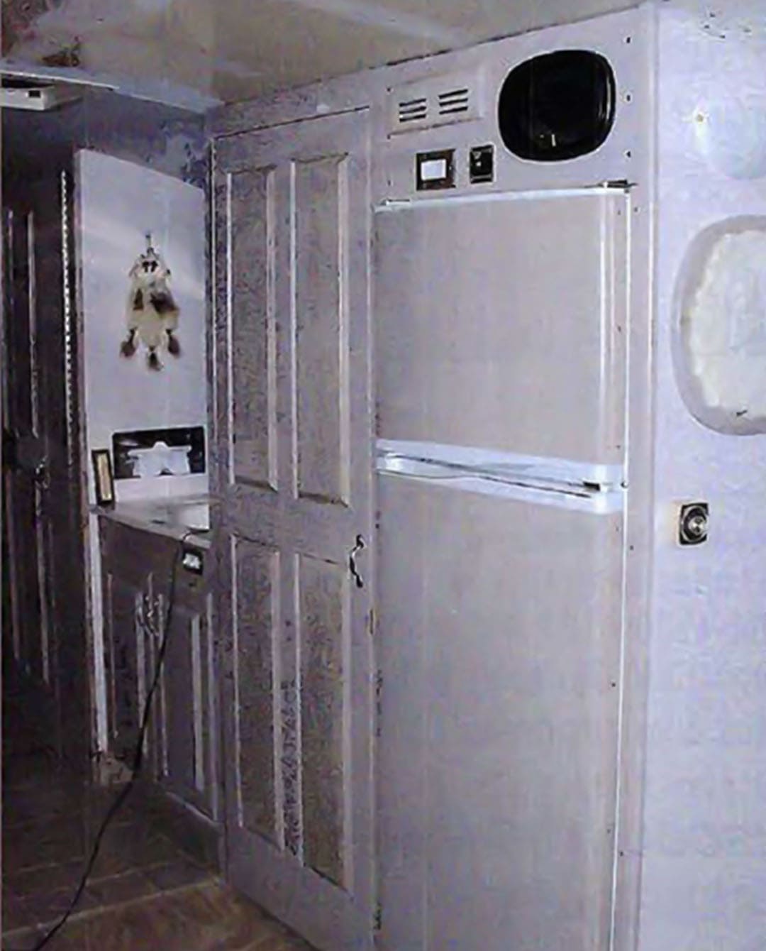

The completed refrigerator pantry and vanity. The Titu's laminated the refrigerator with oak vaneer and stained it to match the cabinets.
The refrigerator pantry and vanity. Titu laminated the refrigerator with oak veneer and stained it to match the cabinets.

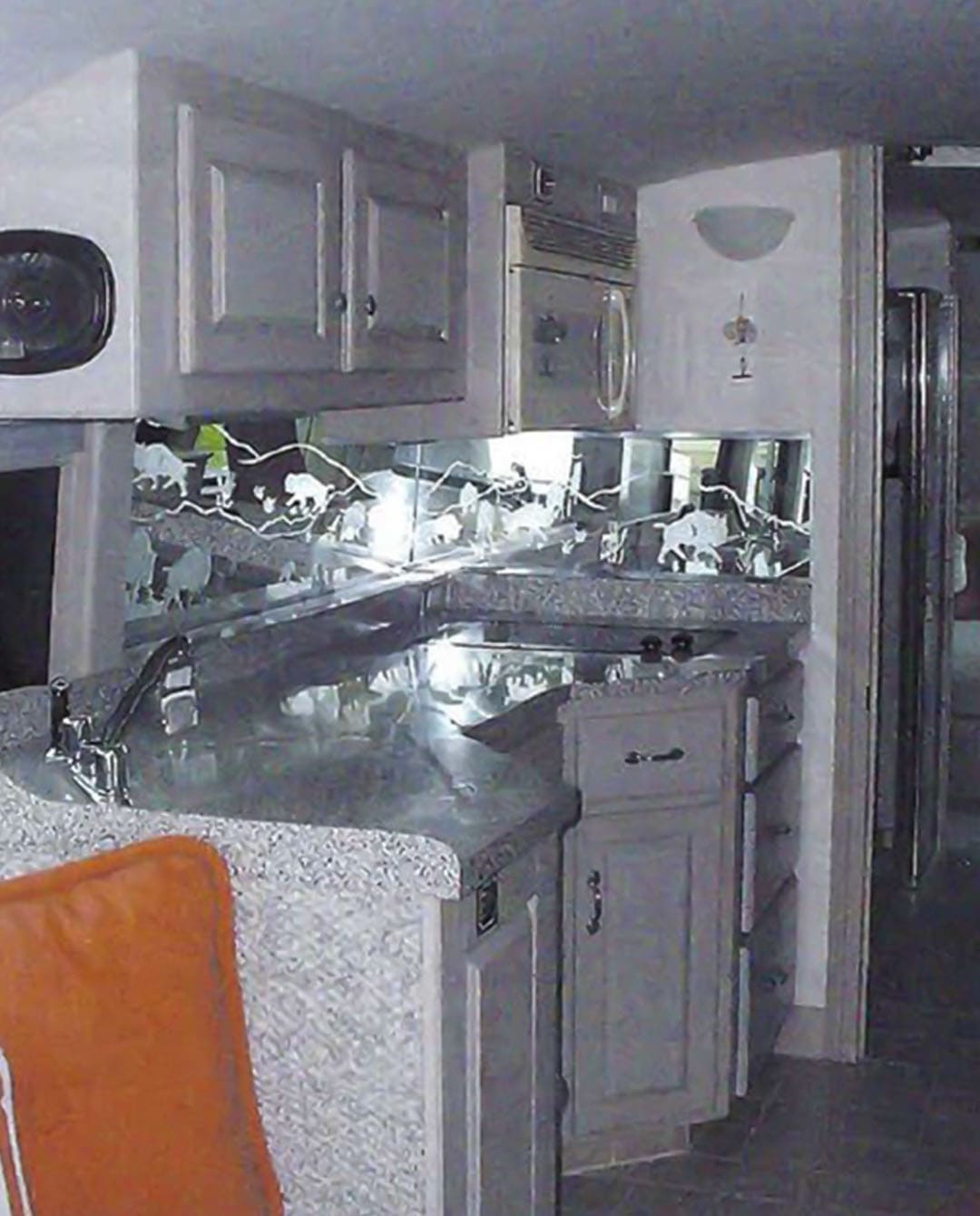

The Kitchen.

The hideaway Table.
Because the slider was 12 inches longer than the width of the bay, Roger cut and re‑welded the framework to fit. He then constructed a plywood drawer, dividing it into compartments to accommodate their supplies. The channel iron was fastened to the bottom of the bay, and the steel framework was mounted to the bottom of the drawer. The bearings ride in the channel iron, allowing the drawer to slide out on either side of the bay. The entire apparatus can be secured in place with the original hook-and-ladder lock. A couple of coats of paint, and we were ready to load.
The finished hideaway table, the carpeted walls, and a chair waiting  for a tired worker.
