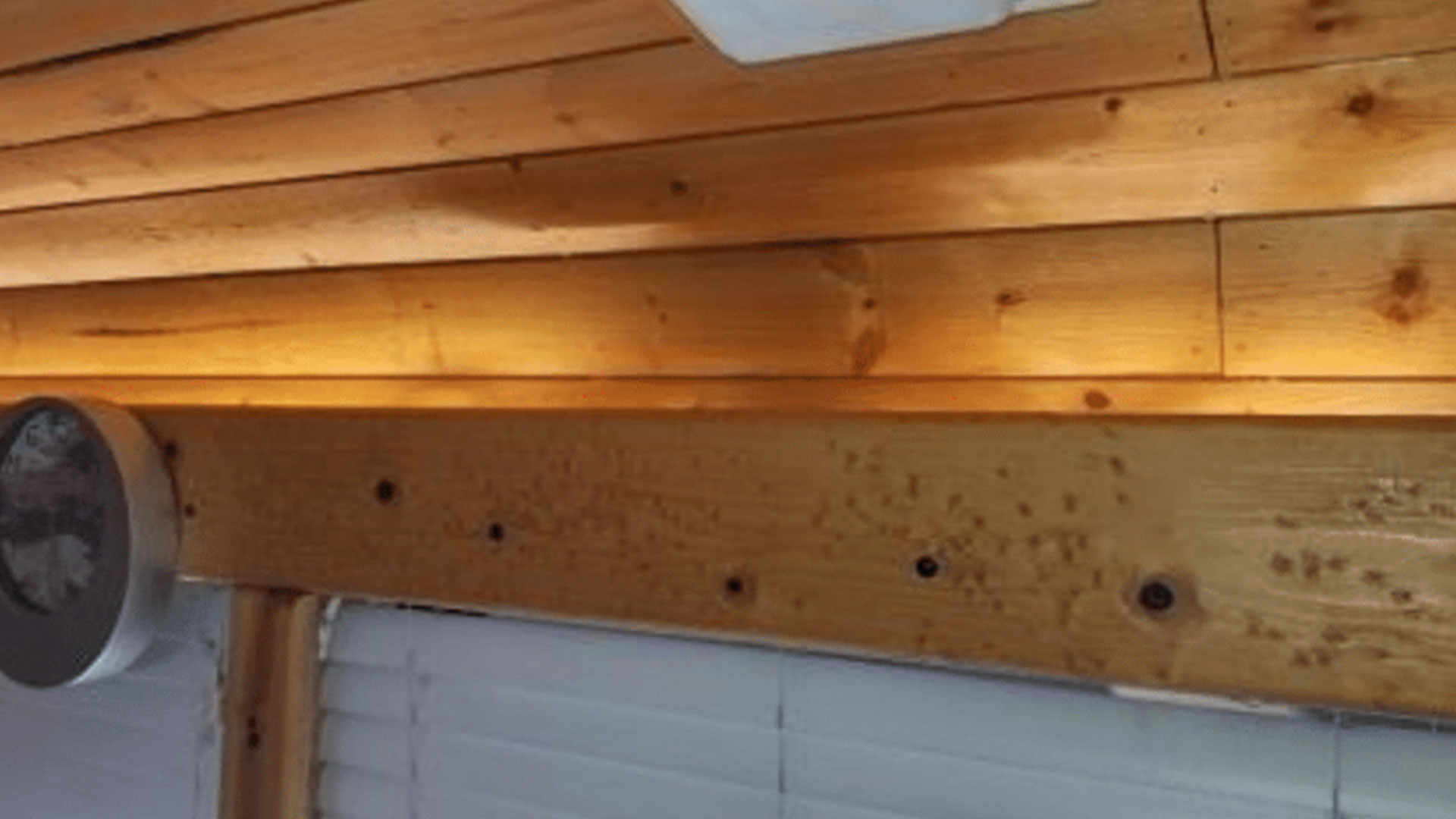

Many coaches have electrical problems, or owners want to add appliances after the bus conversion is completed. Once you finish your bus and close it all in, have you ever had to trace wire, or have you ever needed to add another wire to the system? In most bus layouts, this is next to impossible, and in a stick-n-staple unit, it is impossible as they do not design them to make modifications after it is completed.
However many of us have done it in our bus conversions. In my previous life, I did a lot of electrical work when I worked for my dad who was an electrician and I learned the tricks of snaking wires through walls and in almost any place imaginable. That is when I learned that you should never staple wires inside walls or secure them in any way because it makes it impossible to tie, for example, a snake or two wires onto the one existing wire to pull it through so you can run another circuit.
Even better, you can run wires in a bus in such a way that they are easily accessible and can be added to, removed, or traced without tearing any walls out. One very clever way is to create open-wire chases on your bus that you can easily access. I had them in my MC-9 Log Cabin bus that ran down both sides the entire length of the bus.
You can read about my Log Cabin bus HERE.
They ran behind cabinets where there were cabinets but for most of the bus, they were in the open above the side windows. The wires are hidden but can be easily accessed by simply reaching in and lifting them out of the wire chase checking the connections and testing them at any point.
I suggest using this method as it can be done without anyone being able to see the wires but provides you an easy method of accessing the wiring later if you need to debug a circuit or if you want to add a wire in the future, be it for a 12V or a 120V system, or coax cable or another wiring in your bus.
For a video showing how this wire chase works, click on this video: https://youtu.be/7FTfeDaMgGc
