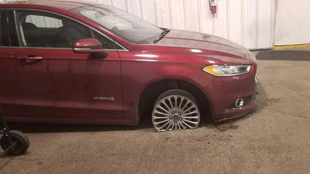

For anyone pulling a Toad (vehicle in tow) behind your bus, or any type of RV, you should always use a checklist for connecting it properly, lest bad things may happen like in the photo above.

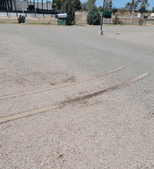

After I returned about an hour later, I could immediately see that my neighbor apparently had no checklist for hooking up their toad, or if they had one, they did not check all of the boxes. By the looks of the tracks, they either forgot to release their toad parking brake or forgot to take it out of gear and dragged their car out of their parking space. They even dragged the power cable a little on his way out.

Tire drag marks on the ground

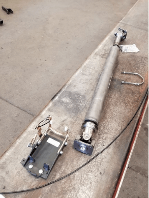

I also check to be sure the toad parking brake is released, my transmission is in park, my Superior Driveline driveshaft disconnect is in the released position, and my toad’s ignition key is in the “On” position so my steering wheel will not lock and will turn freely.
Superior Driveshaft Disconnect Kit before installing in my car.

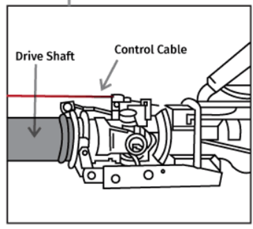

Diagram of the Superior Driveline mechanism.

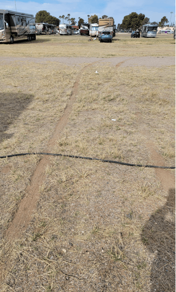

On the third day, I was sitting in my bus, watching my neighbor getting ready to travel and I paid particular attention as I always do when people pull out of a campsite. I noticed immediately that he too was dragging his car out of his space. His wheels were not turning. These are the skid marks he left behind in the gravel.
Skid marks were left behind from a toad being dragged.

What can happen if you leave your toad in gear.
If you travel with a passenger, both of you should go through the checklist as a second person may notice a mistake the first person made. Also, it is good for both people to take turns hitching up the toad. If both people are familiar with the procedure, they both will understand it better. Who knows, there may come a time when the main driver is incapacitated and the second person may have to hook up the toad and even drive the bus.
Also, after hooking up your toad, do not give your rig any throttle, just shift it into gear, release the brakes, and inch forward while idling, or give it as little throttle as possible to start moving. If the toad wheels are locked up, then you should have a clue that something is not right, and then is the time to find out what is going on and fix the problem before moving further.
If you continue to drive with either the parking brakes set or the engine in gear, then bad things can quickly happen. At the minimum, you may find that your brakes are all worn out when you arrive at your destination requiring a brake job.
Or if you left your transmission in gear, you may very well over-rev the engine, destroying it from the inside out. That can be very expensive to replace.
Or even worse, if you drag your tires down a paved road, the tires may catch on fire and the fire will probably be too hot to disconnect your car from your bus by the time you notice it, sending your bus up in flames too before the fire department can arrive.
