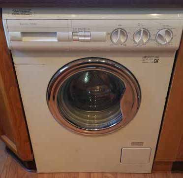

Splendide after installation
Do you have laundry machines in your bus? Some people love them and some people hate them. Some people would rather use the space for a closet or other storage as many remove a perfectly good set of machines to obtain more storage. Some say any machines that will fit in a bus are too small to do all of your laundry. In this article, I will discuss the Splendide washer/dryer because that is the combo unit I am familiar with and I am on my third machine.

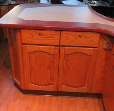

Cabinets before demolition

Some folks prefer the stackable units on their bus which is fine. I agree they are a better option than the Splendide washer/dryer combo especially if they are 220V machines. The wash cycle time will be about the same but the dry cycle time will be about half of the Splendide machine which is nice if you have a lot of clothes to wash. I had stackable units in an apartment where I lived and I use them in my timeshare and they work very well. Not as well as full-size household machines, but good enough for one or two people. The Splendide machines take a long time to dry clothes. One load can easily take three hours to complete. They only use 110V so they cannot get as hot as a 220V machine.
Splendide has two basic models, one vented and one non-vented. The ventless model removes the condensation to dry the clothes and it does not require outside venting. However, it does require five gallons of cold water per hour of dry time so, you had better be hooked up to a freshwater source to use one of these. It also takes about twice as long to dry as the vented model.
Therefore, the vented model is preferred if you can install a vent to the outside of the bus. I have had both, and much prefer the vented model even though the vent sometimes clogs up with lint. The vent-less model is acceptable if there is just no way to vent it such as if you live in an apartment and you have plenty of time to wait for clothes to dry. I had a vented model installed in my Eagle.
The Splendide WD2100XC is a relatively small unit, smaller than most apartment models. They measure 33-1/4” High x 23-1/2 Wide x 23-3/8 Deep. You can only wash about a half load of clothes (if that) compared to normal household units. But the good thing is, they only take up about half the space as the stackable units. If you have a family to do laundry for, this machine could run practically full time and it may not be feasible. Because I travel alone most of the time, capacity is a non-issue to me.

The only problem I have had with Splendide machines is that the door latch is made of very weak plastic and I broke two door latches. They do not make replacement latches so, you have to buy an entire door if you break the lock to the tune of about $180. If you use one of these machines, be sure you treat the door gently as this door latch is poor design and has not been improved in several years as far as I know.
The other problem with the Splendide machines that I have experienced, is that the exhaust vent tends to clog up about once per year, and will no longer dry clothes. You have to remove the top of the machine, then reach down in the back, remove a rubber boot, which is part of the exhaust vent, and clean out the lint.
I was told that if you run a cycle of one cup of vinegar through the Silk cycle monthly, it should prevent this problem. This is a very involved procedure since you must stop, reset the machine, and start it three times to ensure the machine fills up to about half full. I believe this helps, but it has been a couple of years since I have had one of these units on my bus. For the full procedure, contact Splendide and they will send you instructions that will help flush out your vent of the built-up lint to hopefully prevent you from having to do it manually.

If you must manually clean the vent, it is quite a chore since it is very difficult to remove the vent, clean it, put it back in again, and it is easy to get cut on the sheet metal during the process. I cut an access hole in the back of my previous unit to make the job easier, but it is still no fun to do because again, it is a poor design when you need to clean the vent as it is so inaccessible.

So here I am at Leisure Coachworks in Fontana, CA having a new (to me) Splendide washer/dryer unit in-stalled in my Eagle which I bought last year in Quartz-site. I will be spending a lot of time in my bird now that I moved my office in and it will be very convenient to do laundry while working on the best bus magazine out there.
Leisure Coachworks did the complete installation. They removed some drawers and cut them into a cabinet in the kitchen. They removed an ice maker, which I never use, and relocated an Aqua-Hot radiator. They cut out the cabinet a bit bigger and slid the unit in under the kitchen counter where it will be very convenient to access. They estimated it would take three days, start to finish, but once they cut into my bus, they discovered it was overbuilt compared to many of the stick-n-staple units (no surprise there) and they could not run the water lines and vent where they had originally planned so it took them an extra day to complete the project.
