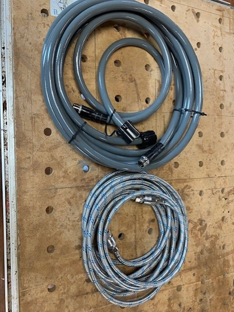

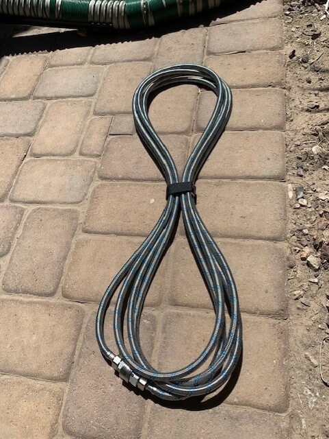

Hose quality is all over the place, some good, some not so much. I am partial to stainless steel braided hoses like what is used under the sinks in your residence. We will see more of that style hose a bit later. It is somewhat difficult to find 15 to 25-foot lengths of braided stainless-steel hose with quality hose fittings on the ends, but they are available from BluTec, MobileMustHave, and to a lesser extent, Amazon. They do tend to have a smaller ID so usually will flow less water than the larger garden hose styles. Clearsource offers high-quality drinking water-safe hoses of conventional construction in garden hose sizes.
The corrugated stainless-steel hoses look nice and offer some level of wear protection but the rolled corrugations can separate if the hose is crushed or over-stretched. I find the soft hoses that expand to full length when under pressure and contract when the pressure is released to be short-lived and seldom rated for drinking water use. You definitely want a hose rated specifically for drinking water use and one that can stand constant water pressures up to at least 60 PSI. Traditional garden hoses are not typically rated for drinking water use and often impart a bad taste to the water.
Pay special attention to the hose fittings and how they are attached to the hose. Ideally, you want stainless steel (hard to find), but brass is okay so long as it is lead-free. Aluminum fittings are not a good idea as they may bind to the metal on the hose bib or to a dissimilar metal on other hose fittings, especially if the water is quite hard. Cast fittings are far better than most stamped sheet metal fittings.
The ID (inside diameter) size of the hose you select is less of a factor than you might think. The plumbing inside your bus is likely 3/8” so a hose larger than that is not necessary except for very long runs (50 feet or more) between the hose bib and your bus. Longer runs create more internal resistance to water flow.
Editor’s Note: The one advantage to a larger diameter hose is that your tank will fill in less time. This is helpful if you tend to fill your ank to capacity, and then and draw water from your tank rather than a campground faucet as many of us do, as we spend most of our time boondocking. It is also helpful when you are in a line of RVs to take on water as it may make the people waiting behind you happier campers. For example, a 1/2” hose will deliver about nine gallons per minute while a 5/8” hose will deliver about seventeen gallons per minute, thereby cutting the time to fill your tank in half, all things being equal.

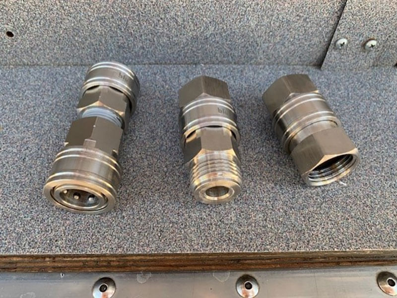

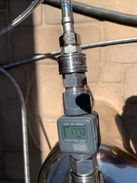

For the purpose of modernizing your bus fresh water system, I really like quality stainless steel quick disconnect fittings like those supplied with the BluTec system. They are quite expensive but worth it to me. The good ones will have eight balls to lock the two halves of the fitting together. The lesser ones will only have three balls and those are far more prone to leaking.
Editor’s Note: Quick disconnect fittings from big box stores, while convenient, will also reduce the flow rate, so again, there is a tradeoff. The higher quality quick disconnects, don’t restrict the flow as much.
Watch out for the so-called “brass” quick disconnect fittings found at most hardware and big box stores. Unless they say they are lead-free and feature six or more locking balls they may not be suitable for drinking water use, and they may discolor, corrode, or leak in use. Don’t scrimp on quality here!

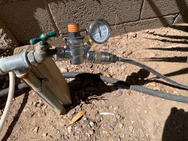

Since you normally will not know what the water pressure is at the hose bib you are about to hook up to, buying a new, good-quality water pressure controller is a good idea. Again, I really prefer stainless steel over most brass units unless the brass unit is stated specifically for drinking water use. Many are nickel plated to look like stainless steel and those usually are safe for drinking water use. The gauge should be dampened (partially filled with oil) and an easily accessed screw should be readily available to set the maximum pressure you want coming into your bus. Usually, you want that to be about 50 PSI.
Editor’s Note: There are water pressure regulators that have a normal flow rate and there are the ones that tout a high flow rate. I prefer to use the high-flow rate ones.

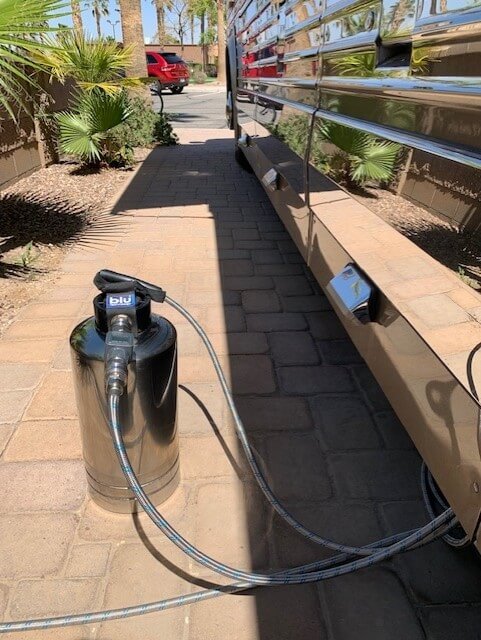

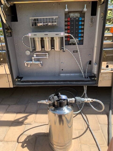

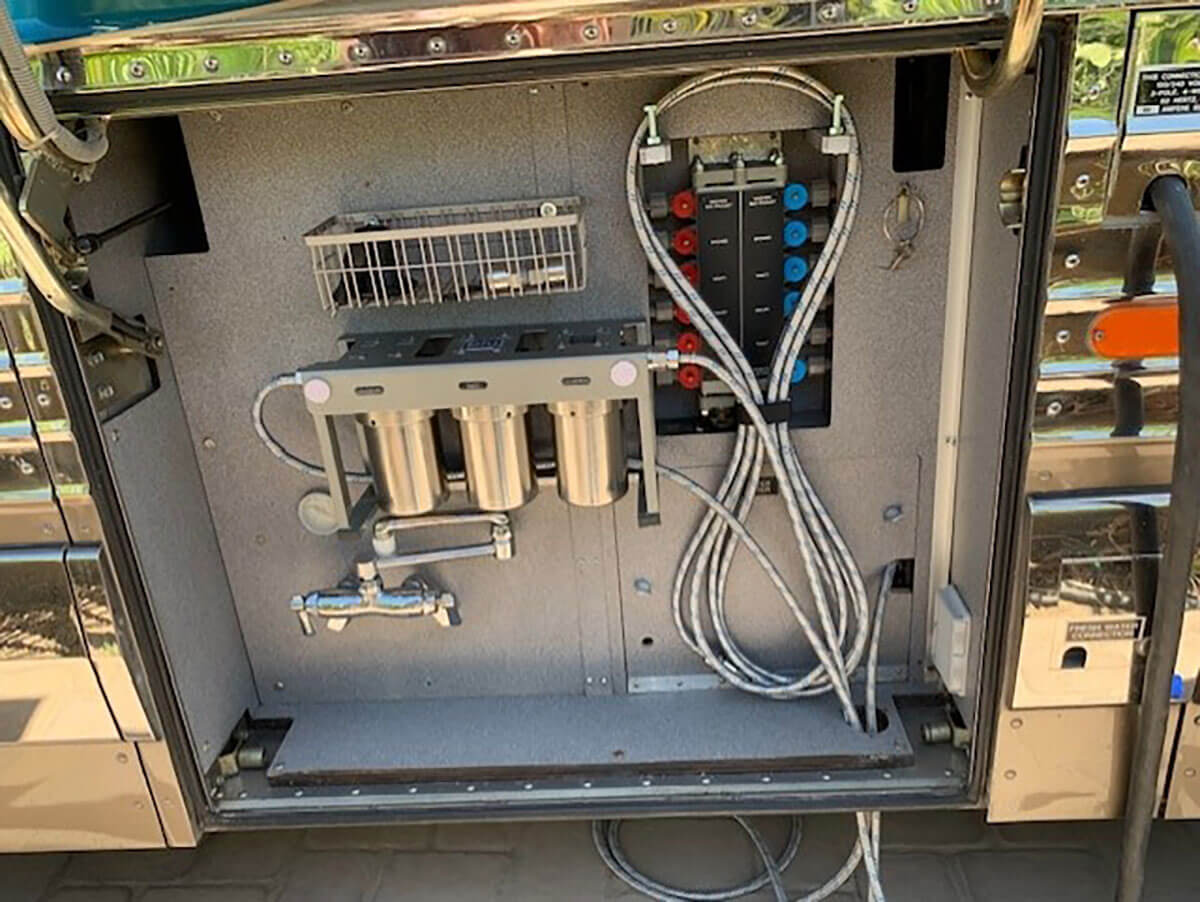

As noted in the prior article, I can recommend a couple of 3-stage filtration systems. The first one, optimized for small size, lightweight, and compact storage is sold by BluTec and is available from the BluTec website, the MobileMustHave website, and Amazon. It features solid stainless-steel construction (frame, filter canisters, fittings, quick disconnects, braided stainless steel inter-connect hoses) and uses 5” long filters.
Three housing types are available. I selected the one from MobileMustHave that is open with square tube legs that can either be hung on a wall or left free-standing because it is narrow enough to mount inside my water bay while allowing the bay door to close without hitting it. The other two available housings are wider and would not fit inside my water bay, but they may fit inside yours.
With the BluTec filter set mounted in the water bay, a 25-foot braided stainless-steel hose runs from the inlet side of the 3-stage water filter set down through a port in the floor and out to the pressure regulator screwed to the hose bib. If we are traveling where the water is soft enough not to require the water softener, a braided stainless-steel hose with quick disconnects runs from the outlet side of the 3-stage filter set through a water meter (so I can keep track of how much water has passed through the filters) and then connects directly to the plumbing lines in my coach.
When we are in hard water areas (like we are at our winter home RV Resort in Arizona), the outlet from the water filter set quick-connects to a hose running through that floor port and out to the inlet side of the water softener. The outlet side of the water softener quickly connects to the line running to the plumbing lines in my coach.
When the water softener is in use there are three braided stainless-steel hoses running through the floor port since you want the water going into the water softener to have already passed through all three filters. When the water softener is not in use, it stores in a nearby storage bay held to a bulkhead wall by Velcro straps and only the hose bib connected inlet line goes through the floor port.

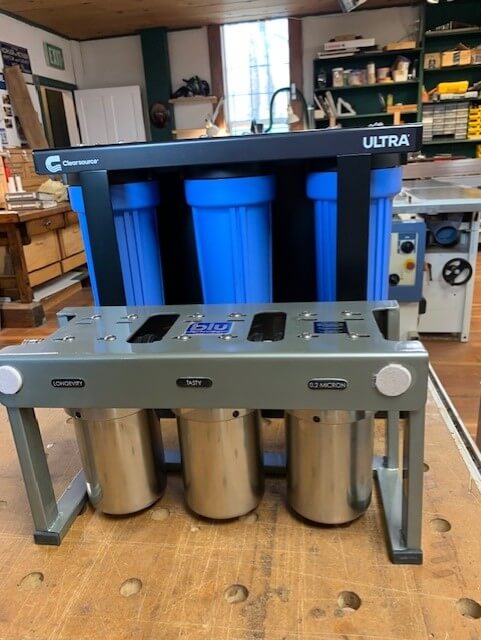

The other recommended 3-stage filter is made by Clearsource and it is available directly from Clearsource itself, from several RV supply houses, and from Amazon. It uses 10” long filters so it is significantly larger, taller, and heavier, optimized for longer filter life, and higher water flow rates, and claims superior filtration technology than BluTec offers.
This unit is too wide to mount inside my water bay so sits on the ground just outside. While the filters are twice the size of the BluTec filters, the Clearsource filter housing uses much larger filter canisters and spaces them further apart, so the 3-stage filter system is easily three times the size of the BluTec unit. The picture at the beginning of this article shows the difference so be sure you have room to store the Clearsource unit before making that choice.
Clearsource also offers a really slick insulated and heated case to protect these filters from the elements and from freezing. That case also makes it way easier to lug around the heavy Clearsource filter set that weighs 30 pounds dry (much more than that full of water) and is 25” wide, 9” front to back, and 18” tall.
The BluTec filter unit is small enough and light enough even full of water for you to easily move it around or store it without any case. And the stainless-steel construction is largely immune to the elements. It can freeze in cold weather, damaging it, so either mount it inside like I do, insulate it, or heat it for winter use.
With either filter set, the inlet water hose mounts to the inlet side of the filter set and runs over to the hose bib and water pressure regulator. The outlet side connects directly to your RV water plumbing or optionally to the inlet side of a water softener if you are in a hard water area. More on that in Part 3 of this article.
Both units seem to do a great job of cleaning up even dirty or contaminated water. Both say you can draw water right out of a lake or stream and, after flowing through their three-filter set, the water would be drinkable. I don’t intend to do that, but it is reassuring knowing that if it can clean up lake or stream water to drinking standards it surely will clean up any hose bib water no matter what the source.
As mentioned above, the Clearsource unit claims superior filtration of really small particles over what they claim the BluTec unit can achieve. They show a clever video (see below) using ink that they say has particles smaller than common water contaminants. Flowing through their 3-stage filter, the water coming out is clear of those ink particles.
When the same ink water is passed through the BluTec three-stage filter, they say the ink particles pass right through and the outlet water still looks dark. BluTec says their raw water filter will do something similar. For use in cleaning up potable water from a hose bib, I think both will do an admirable job and will be far better than whatever you have been using in your RV.
