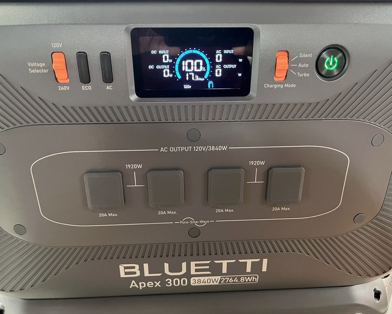

1) Inverter size – Do not select any unit that does not output pure sine wave power continuously at the rated output.  Some manufacturers use cheaper square wave or modified sine wave inverters, which you do not want.  Also, some manufacturers will use what they call peak or surge ratings for their inverters. That only refers to what the inverter can theoretically output for a few seconds, so those ratings mean far less to you in daily use than the continuous output rating.
Bigger is better, but it will also mean a larger current draw, even when the system is in standby with no appliances in use. As a result, your battery bank will be depleted more quickly, even when it is doing nothing.  The larger inverters also generate more heat, which may require noisy cooling fans, potentially creating a distraction.

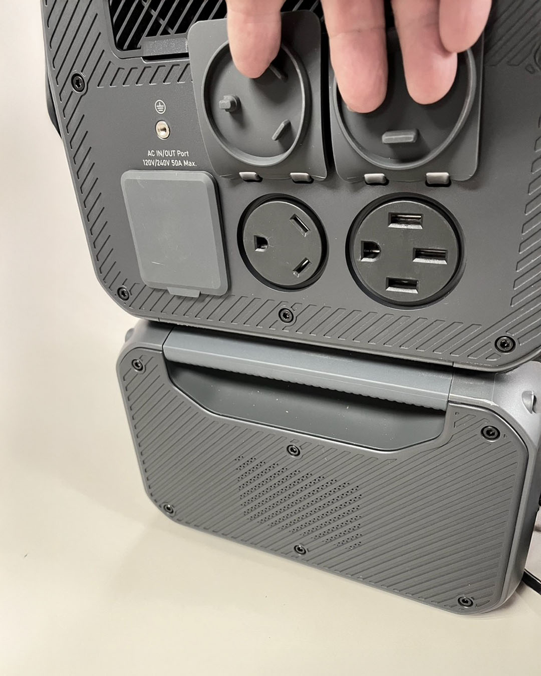

4) Inclusion of a 50-amp as well as a 30-amp RV shore power receptacle – This is not common, but at least one new-to-the-market unit does offer both. That one allows you to select 120VAC single phase or 240VAC split phase output from that 50-amp receptacle by the simple slide of a switch on the front of the central unit.  Nice!
This unit comes with a 30A and a 50A outlet.

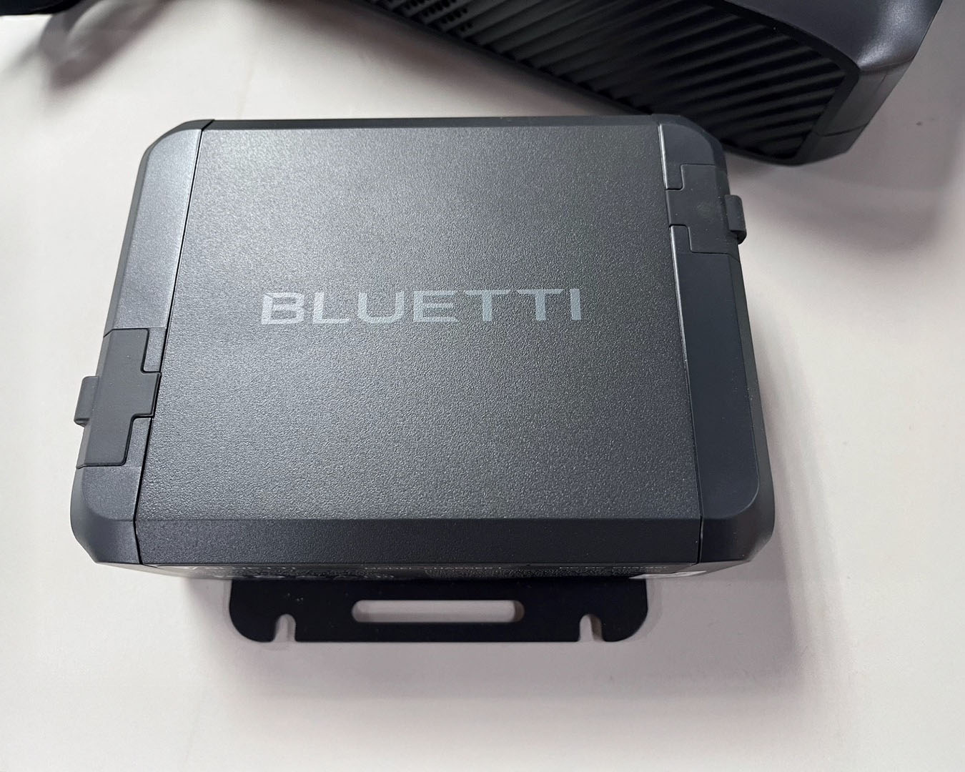

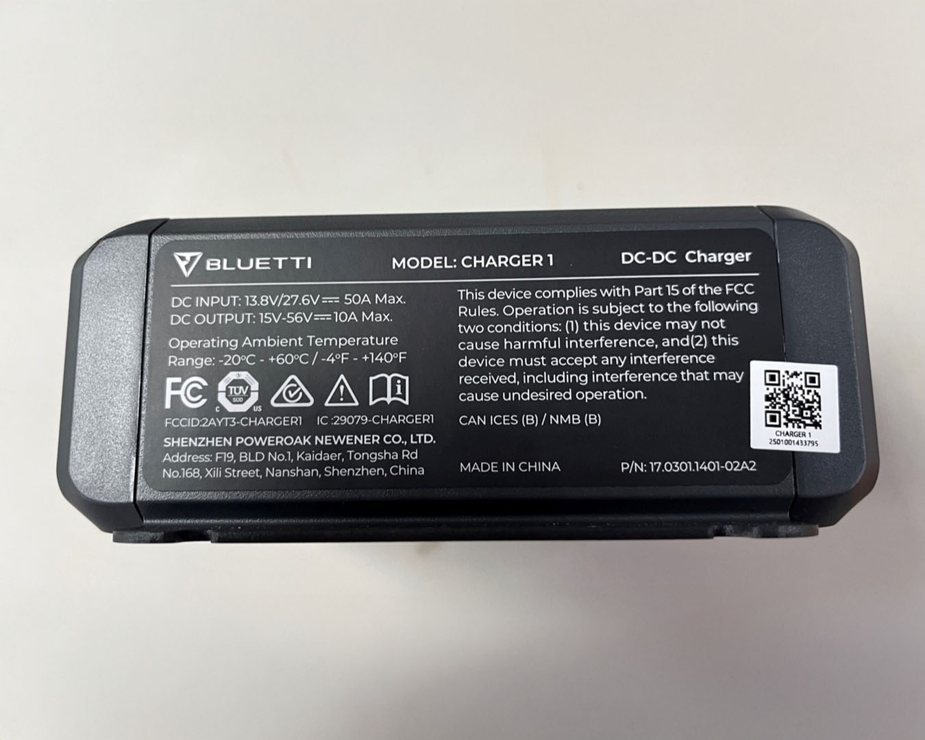

Alternator charger.

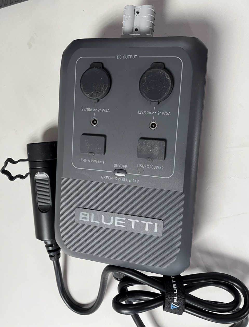

9) A manufacturer supplied provision for supplying 50 or more amps of nominal 12VDC output in case you want your power station to also provide power to your RV 12VDC distribution panel – Your RV originally came with a 120VAC to 12VDC converter from the factory.  By plugging in your shore power cord to the new power station, that same converter will still work.  But, if it is damaged or limited, or you are doing your own conversion, it is handy to have 50 or more VDC available for your use.  Some power stations offer this.  Many do not and instead provide only 10 amps of 12VDC output, which is not nearly enough to power all your 12VDC needs.

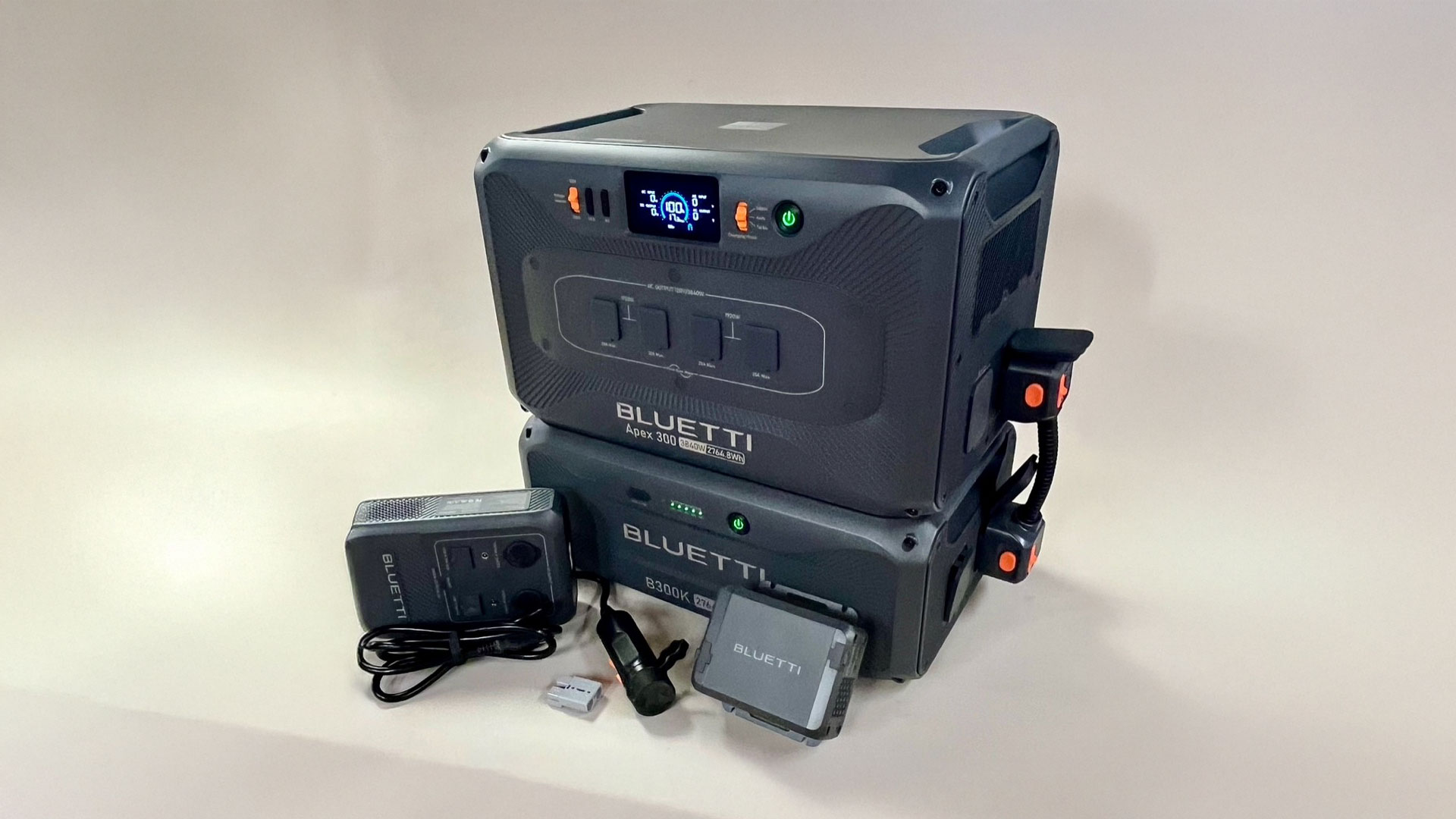

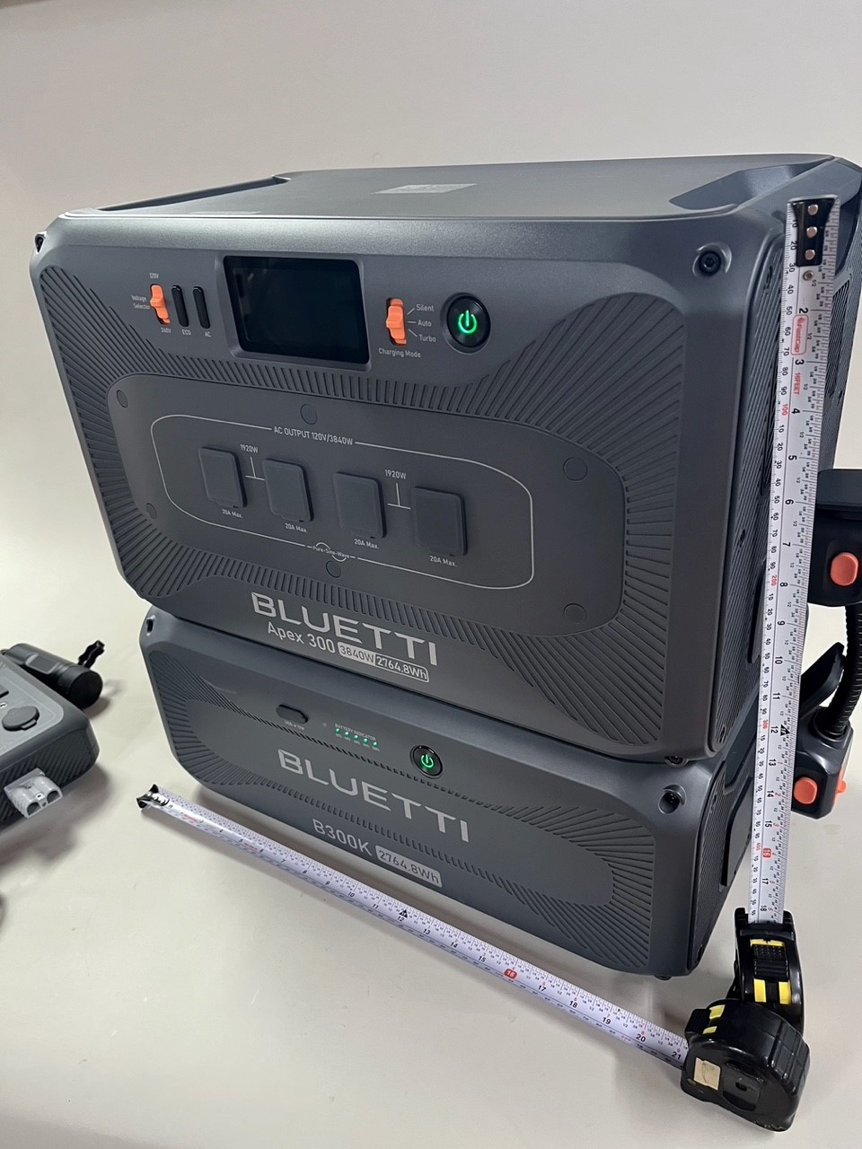

Showing the physical size of the Bluetti system.

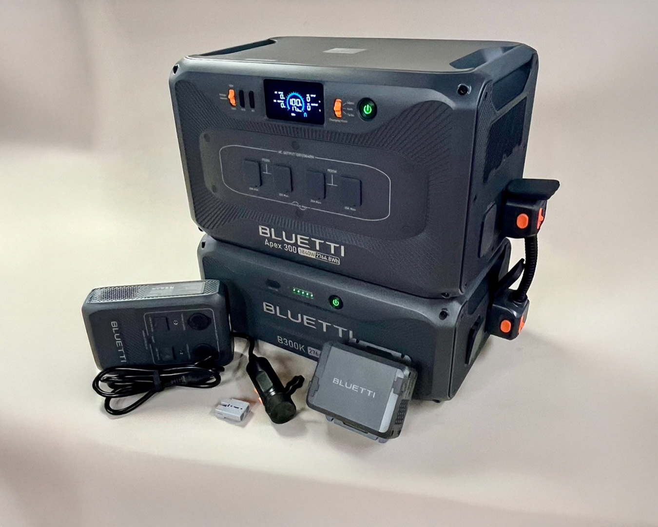

All the components needed for an average to smaller RV.

DC accessory box provides 55 amp, 12vdc power plus USB outlets.

Alternator charger close up.

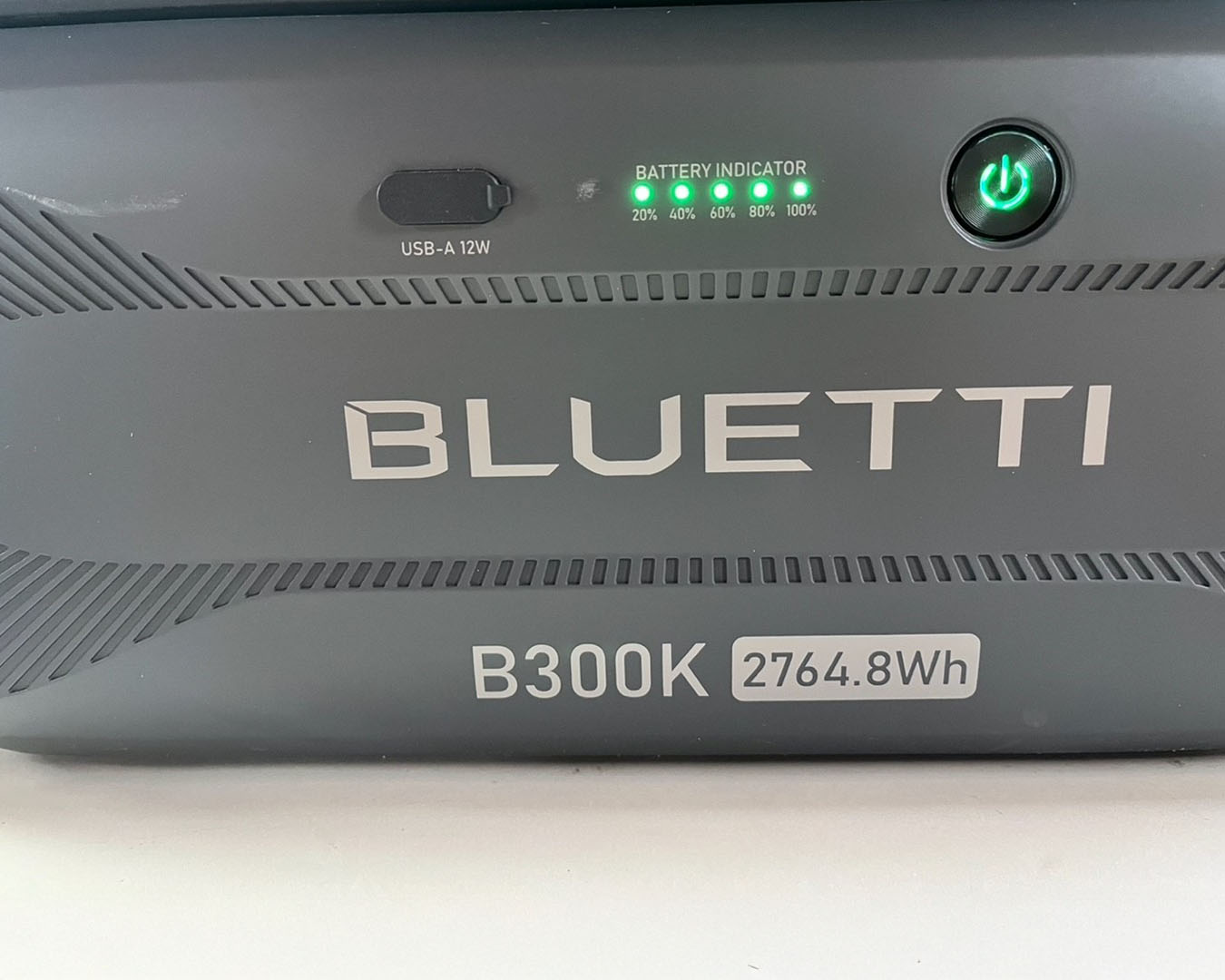

Bluetti Control Panel.
