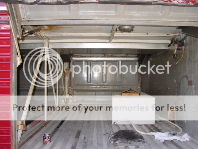

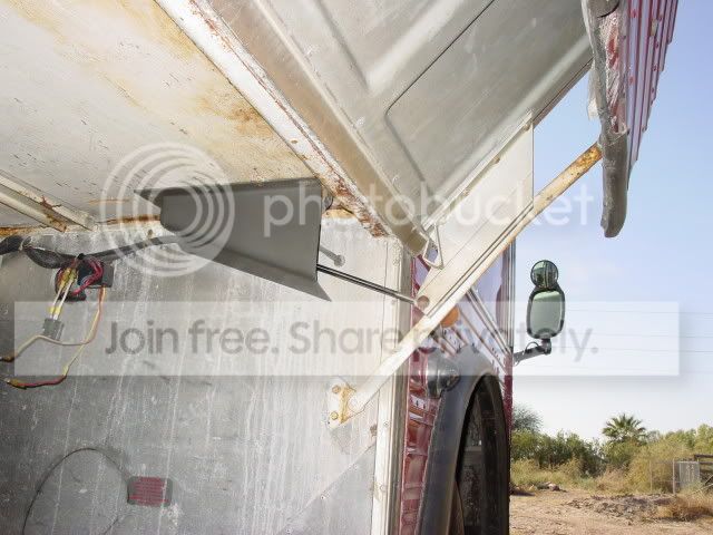

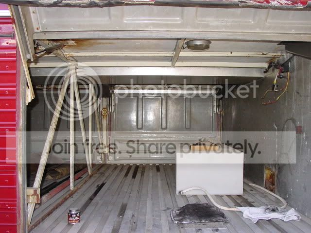

July 21, 2009, 06:33:04 AM »
Frontman,congrats on the purchase.As Len and Clifford posted check the front bay,I think this is where it is.
front bay pass side,upper right hand corner of photo
I believe this is the location.good luck and drop by for a visit
